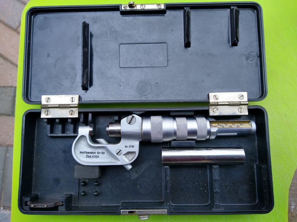

      Can anybody tell me how to read this micrometer?
      It's made by Hahn & Kolb and has Nr.1731 stamped on it plus Messbereich. 10-20 (measuring range). My main problem is with the spring loaded plunger, with the graduations marked on it, which doesn't seem to connect to the moving spindle.

            Thanks for that Martin. TheThe setting tool is in fact a hollow bar measuring 15.00mm diam. This instrument was part of a consignment of tools that I inherited from my late cousin who was a keen model engineer and an inveterate collector of tools , new and old. The word magpie comes to mind. I can't think that I would have any use for it so will probably Freecycle it along with other unwanted items.

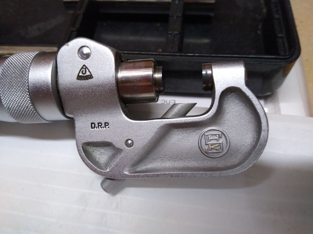

                    Martin: As you can see it bears a "cast in" HuK, Stuttgart logo, the stamped letters D.R.P. and a stamped triangle ( the letters under the J are WECO. Perhaps you can decypher.

                        My money's on this being a peculiar indicating mic.
                        The features that it has in common with regular ones is the angled rod for limiting how far you can shove each part in the throat of it, the spring loaded measuring element and the +/- scale that seems to be independent of the main scale.
                        Bev: Does anything move up and down the scale when you press the plunger?

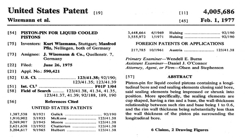

                          I suspect this is an updated rendering of the J WECO mark: **LINK**
                          https://www.discogs.com/label/1400961-J-Weco
                          … and it appears that Wizemann & Co know a thing or two about piston pins:
                          https://patents.google.com/patent/US5653204
                          Mmm …
                          Edited By Michael Gilligan on 29/07/2021 07:29:38
                          #556250
                            Apologies … Not quite sure what happened there ^^^
                            Google ‘helpfully’ provided the URL for the referring page instead of the one I wanted to quote dont know
                            [ Wizemann’s patent is ‘cited’ in that one ]
                            Try this: **LINK**
                            https://worldwide.espacenet.com/publicationDetails/biblio?CC=US&NR=4005686A&KC=A&FT=D
                            Edited By Michael Gilligan on 29/07/2021 09:07:59

                              DRP is the equivalent of the UK "Patent" mark, rather than a manufacturer.
                              Cannot offer anything else useful, other than to say that the third anvil suggests use to measure round objects / and as said to set tools for boring.

                                Tim G: the scale is fixed to, and moves with, the plunger. I made a small video but can't see how to attach it to my post.
                                MichaelG: Thanks for the info but I'm not sure what the spacenet link is telling me about this instrument.
                                Howard: Thanks for your info. I can't see it as anything other than a "go/no go" gauge.

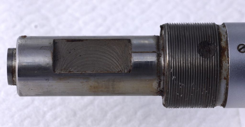

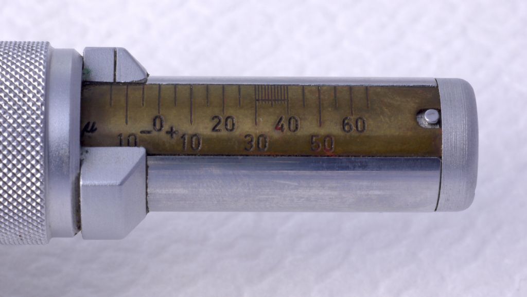

                                    Having relieved Bev of his micrometer … I have removed the barrel for investigation
                                    The knurled thimble moves things bodily within the confines of this flat:
                                    and the sprung scale at t'other end looks like this:
                                    There is [as Bev has already noted] no apparent connection between this and the anvil dont know
                                    I suspect that things in the anvil area are gummed-up with hardened grease.
                                    … We shall see

                                      #559356
                                        A quick update :
                                        Predictably enough, the dark spot in the screw-thread was grease, concealing a slotted screw.
                                        … it appears to be very tight, so I am leaving it be for a while.

                                                Hey, I just finished restoring a similar Jsameter and this thread helped a lot with finding additional information so I just wanted to share what I found out.
                                                The Jsameter is an adjustable snap gauge, how it works: Depress the plunger to retract the anvil, insert the part and let go of the plunger – the springs can only push the anvil forward until it touches the part and the plunger stops and shows a reading on the scale:
                                                The mechanism is quite interesting, on the inside there is a very slightly tapered pin the length of the measuring range and connected to the plunger, it rides between 7 loose bearing balls so be aware when opening one of those up. The plunger is spring-loaded and pushes the bearing balls apart which rest inside a cone that is connected to the anvil – the balls move outward and push the cone forward – the anvil moves forward. Depressing the plunger lets the anvil move back/open up with the help of another spring.
                                                The end part of the barrel with the measuring line on it is pressed in, there are no screws and only two small ridges to pull on. I took out the scale and used parallel pliers on the flat part with the line to wiggle it out with the barrel in the vise with copper jaws. After getting it out I immediately spilled the bearing balls on the floor
                                                My idea of the origin of the name – there is a dial snap gauge called the Passameter, maybe this is the Passameter from J Weco – the Jsameter.
                                                I was also able to find a patent from Wizemann showing the exact instrument in the drawings, except in the patent it is a thread gauge. The patent is from 1939: espacenet: Patent CH236608A
                                                But the mechanism might be a little older, there is a patent from inventor Walter Wolff form 1931: espacenet: Patent DE601437C
