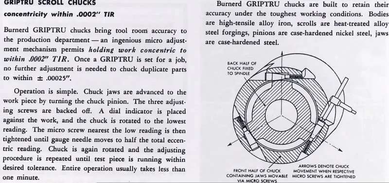

    Speedy Builder5
      @speedybuilder5
      I notice in the News Tab here that Neil has entered the information (Still blurred) for the adjustment of these chucks. This may help.
      Bob
      GRIPTRU 1
      #771125
      peak4
        @peak4
        In conjunction with the above diagram, the official manual is available here
        https://prattburnerd.com/wp-content/uploads/2022/01/PBI-GRIPTRU-MANUAL.pdf

            In the interests of avoiding (continued) confusion, the chuck adjustment moves the front part of the body of the chuck, carrying the scroll and jaws, with respect to the back part of the body. The backplate – if fitted – doesn’t come into it: the back part of the chuck body remains fixed immovably to it. As delivered, the screws securing front and back parts of the body are often too tight for proper adjustment, and should be eased just enough for the adjusting screws to be turned without the buttocks needing to be clenched. They should then be left alone, and, in any case, won’t be accessible if the chuck is fitted to a backplate.

              Both of my GripTru chucks happen to have Bellville washers in them. One was new from the NZ importer in 1989, and the other came with my S7, that was imported in 1972. I have replaced the washers on the chuck I use all the time.
              I think the secret is not to be over tightening the cam screws. Every once in a while, I remove the cam screws, and I re grease tapers. The grease I am currently using is a ant seize grease. A light coat on the threads and on the taper pins.
              Every few years, I take it all apart, clean, lightly grease everything and reassemble. The backplate to body and scroll etc all get bearing grease. Remember to align the key slots , so they all are in the same alignment.
              I don’t do heavy or big interrupted  cuts using the griptru chuck. I use it for finish turning and for things that require a very high precision, like re trimming pistons for model engines etc. With care, you can dial in a round part to better than 5um tir quite easily, if the spindle is set correctly.

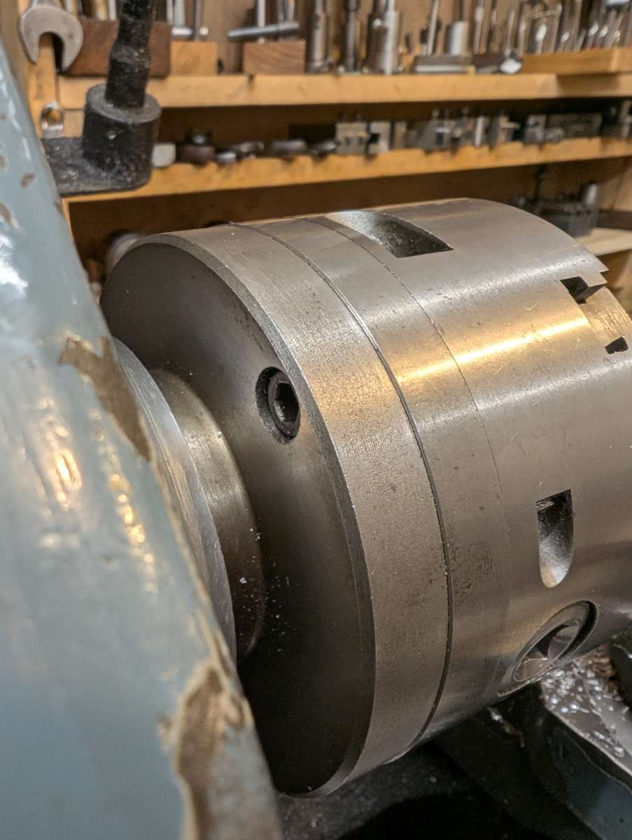

                          Are we talking about the same arrangements? Pictured is my 4″ Griptru factory fitted to a Boxford backplate. The allen screw in the picture is solely to hold the chuck to the backplate. It’s permanently fully tightened. To access the screws holding the 2 halves of the chuck together, it’s necessary to remove the backplate. Joint between the 2 halves of the chuck can be seen as a faint line.
                          Is it possible that a directly mounted Griptru does allow easy access to these screws by eliminating the backplate?
                          Incidentally, this chuck is more or less my “everyday” chuck, and I’ve never had problems with it going out of adjustment under cutting forces, but I try not to abuse it.PXL_20241221_083610969 (1)

                            Ah, I see. Yes mine is a threaded body job for direct mounting. GHT shows a diagram of of a chuck for backplate mounting having the holding-together screws going in from the front. I suppose you could put holes through the backplate to allow access to the holding-together screws.
