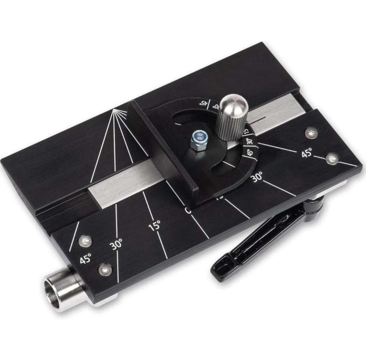

      I’ve ordered some steel to make a table for my small belt grinder. Is there any advantage to the angle setter on this commercial unit that makes it worth duplicating. I should add I don’t intend to engrave any lines on the table.

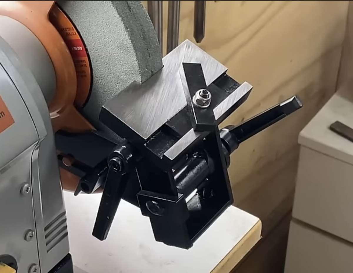

      I’ve seen this home made version that is obviously much simpler. You thoughts please?

        I’m planning on using a Bristol locking lever to lock the angle plate.

          I haven’t bothered with lines on my table, ‘cos I’ve always found that if it’s critical I always find myself with a protractor in hand anyway, and if it’s not it, then it doesn’t matter!
          In any case the angles I mostly use are between 1 or 2 degrees for relief, 5 or 10 for clearance and then the half angles for threading tools, plus a smattering of odd things for form tools.
          For the common sharpening of lathe tools etc., I have little ‘angle-gauges’ cut out of flat stock which will either stand up on their edge and can be ‘eyed in’ against the belt-face, or laid flat against the edge of the table / belt / guide.

            The little two piece gauge shown in the second photos is simple enough to make several set to different common angles. I made 3 equivalent ones but of course the one I want is always hiding. Only good for normal tool angles, not screwcutting tools though.
              You mirror my thoughts, thanks for that. I too have lots of little home made “angle gauges”.
                That’s a good idea!

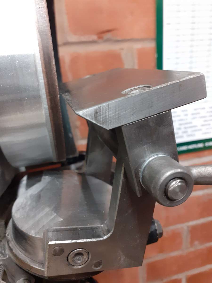

                  It looks like I have to make a mod to my grinding table.
