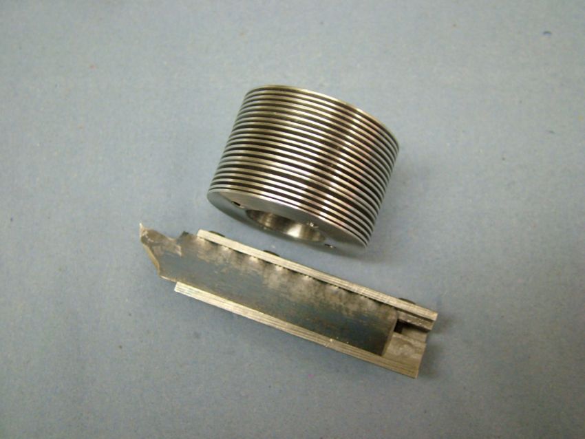

                      I have (and still have) a narrow parting tool made from an Eclipse HSS hacksaw blade set into a small home made holder. I used this for the very deep slots on one of the Eta cylinder heads without any issues as I recall but Dave is right you need make sure it's solid HSS and not carbon backed.
                      Tug
                      Just found this – the grooves are (relatively) very deep. The differing groove width is due to push over as the next groove is done. Interestingly there should be more 5 more grooves in this particular head than shown but I felt that the width and thickness of them if done so would lead to disaster

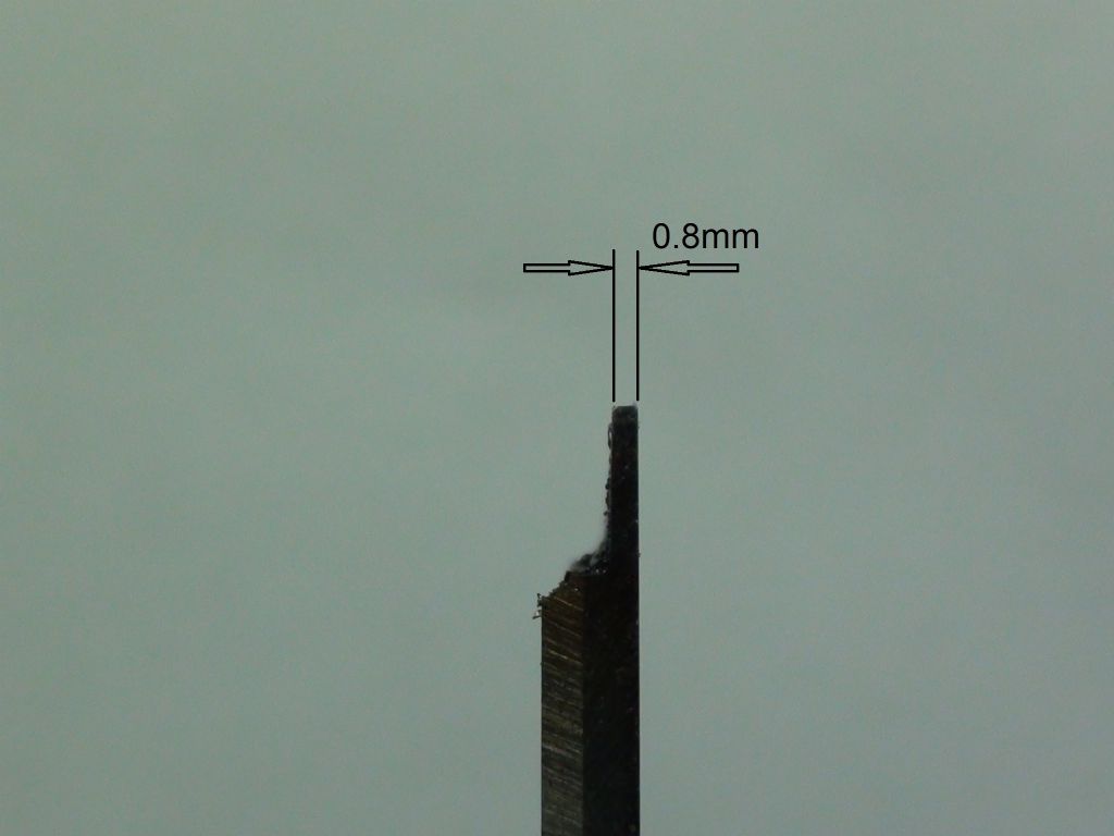

                        When I needed to make some narrow circlip grooves, I ground down a parting blade to a width of 0.8mm. I thought it would break, but it didn't. I ground the other end to 0.5mm and that didn't break, either, much to my surprise.
                        In the photo above it isn't in a holder. Stick-out should be the least you can get away with. The material it was used on was BMS.

                              Similar experience to Ramon's with a multi fin cylinder from EN16T for a Whittle V8 engine.
                              Tool is HSS ground to .6mm thick for 2,5mm length to suit 2mm DOC.
                              The tool did 10 cylinders before the tool tip went into the chip tray.
                              Link to the tool working video on Youtube below.
                              **LINK**

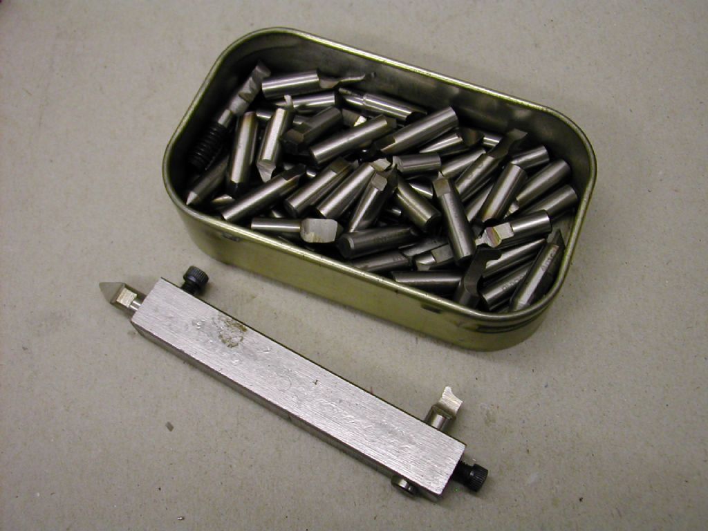

                                    groove-and-shoulder-tool-1.jpgHi Rob, I made the grooving tool shown in the pic from the shank of a broken tap. No idea who broke the tap, of course,… anyway the holder is just a scrap of mild steel bar cross-drilled to fit the shank of the tap, and the end drilled and tapped for a setscrew to secure it. Cheap as chips and been using it for years. By the way, make the holder before you grind the shank, that way you can use the holder as a handle for the grinding. groove-and-shoulder-tool-2.jpg

                                      Hi Jeff, Thanks for your post and the pics. That looks like a fine idea.
                                      Rob
