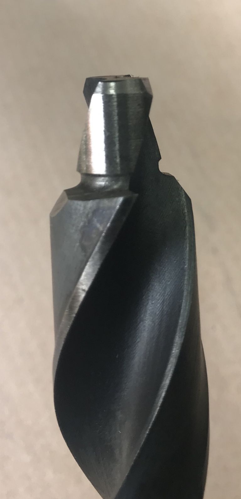

      I’m wondering if I can grind a step drill on my lathe. I was thinking about buying a 43mm motor mount for my router and using a mounted stone in it. Anyone done this? Two things occurred to me though, where and what type of stone to get and how to dress it if it needs it at some point. It’s not something I need to do very often so I’m looking for an inexpensive solution.

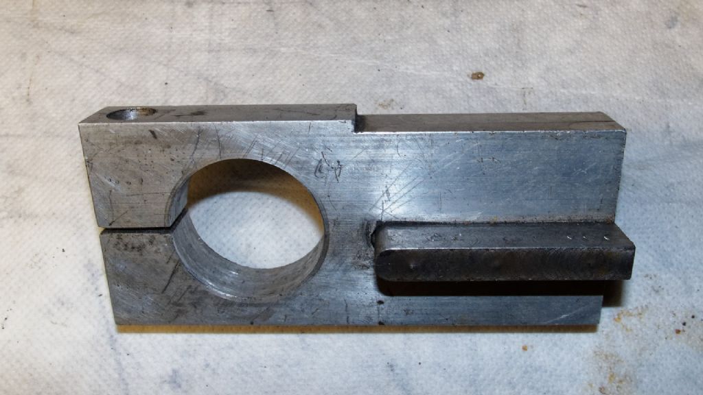

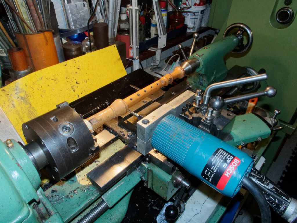

            Yes, I have used my router as a toolpost grinder;
            There photos are just a mock up, as I took them to illustrate a different point to help someone on a Facebook group.

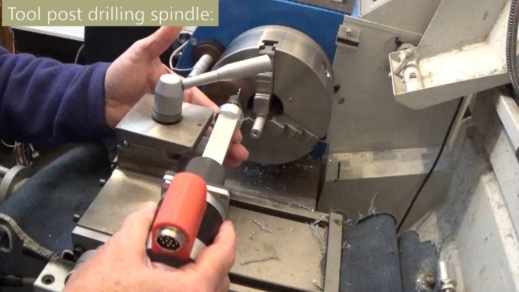

                I have made a drilling spindle for the tool post using 6009ZZ plain bearings, an ER11 collet holder and a 170W BLDC motor.
                I also made a milling spindle using AC7000 contact angle bearings, an ER11 collet holder and a 175 Watt Dremel.
                For grinding, I prefer the Dremel milling spindle because it can run high RPM and the spindle is free of play. The spindle has a 3D printed adapter. I also made an adapter for a DC motor from an old cordless drill.

                    That's a lot of HSS to grind away. And by the time you get down to the smaller diameter, there will be little or no flute left. Step drills have smaller flutes on the small diameter part.

                                That is not the case with the few that I have. The flutes are the same size all the way down. wink 2
                                For my use, reducing the tip of a 27/64 drill bit down to 15/64 will leave more than enough flute left to clear the work.

                                    Well there you go. They just look smaller because the outer part has been ground away. When you think about it, the flutes still have to go down to the size of the chisel point.
                                    Still seems like an awful lot of HSS to grind away with a mounted point in a router, with an interrupted cut over the flutes. That kind of grinder set up is usually for taking a few thou off for finishing purposes. You might be better off to make up something to hold a pistol drill up square to your six inch bench grinder so the drill rotates the bit and the six inch grinding wheel does the work. I imagine it would go a lot quicker that way.
