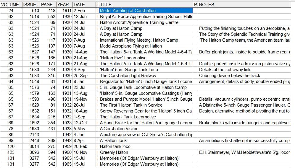

                  #258685
                    Diane was up to her eyebrows in MEX a couple of weeks ago, so I suspect your request may have got lost in the chaos, or she may be planning to put it in postbag.
                    The Halton Tank design is well know and I think it's history has been touched on in later issues as well as teh original series.
                    As you can see there was a lot more written about Halton than just Greenly's loco, plus there was an Edgar T. Westbury connexion.

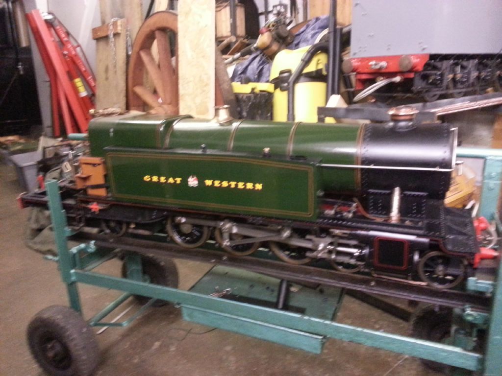

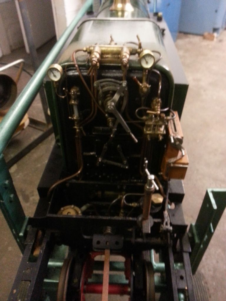

                            john bennett 1
                              @johnbennett1
                              I had one and i know the southampton club had one as well, great big beast of a thing, i had to buy an hydraulic bike lift to move it around. heres a pic of just before i got it.
                              and heres one of when i nearly finished it.
                              the back head was a thing to behold,
                              sometimes im sorry i got rid of it,but when i can throw my maisie in the car easily and even my maxitrak opal with a little grunt i dont miss it.
