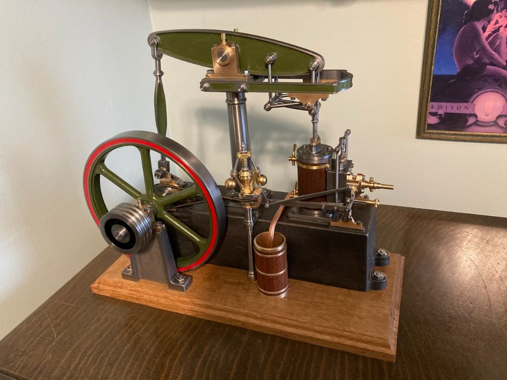

              It looks to be a Watts type governor. I made a modified version of the Stuart governor. I could scan the drawing if you would like it. Mine is scaled down 20% and I replaced the spring with a weight. The Stuart is quite expensive and the balls are easy to get. Here is mine for reference.240d28e8-0e91-4ec7-a0de-55fe9f9285e8.jpeg

                Hey all, I did get a kind response back from Dean last night. Unfortunately there will be no access to the drawings he used. He has suggested i contact PM Research directly and see what they suggest on the matter.
                I will be taking you both up on your offers though Duncan & George! check your PMs!
