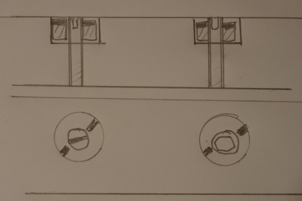

        There used to be aa design of adjusting screws for microwave cavity resonators, generally known as "Telelecs" after their manufacturer. These were threaded "grub" screws with two sections of thread separsted by a reduced diameter "waist", into which were cut a pair of slots from opposite sides, going perhaps 75% of the way across. The threaded portions were cleverly made so the threads were slightly displaced from one another. When you screwed the thing into a threaded hole you hade to press axially to slightly shorten the screw to make the second part of the thread ine up with the internal threads to be able to continue to screw it in. When this pressure was released the threads would spring apart again and lock. This completely obviated the problem of a locknut fighting the adjusting screw. If you thing adjusting gibs is hard, try tuning a microwave filter which has locknuts on the tuning screws!
        Edited By John Haine on 01/11/2020 19:53:10

          "Tekelec"….
