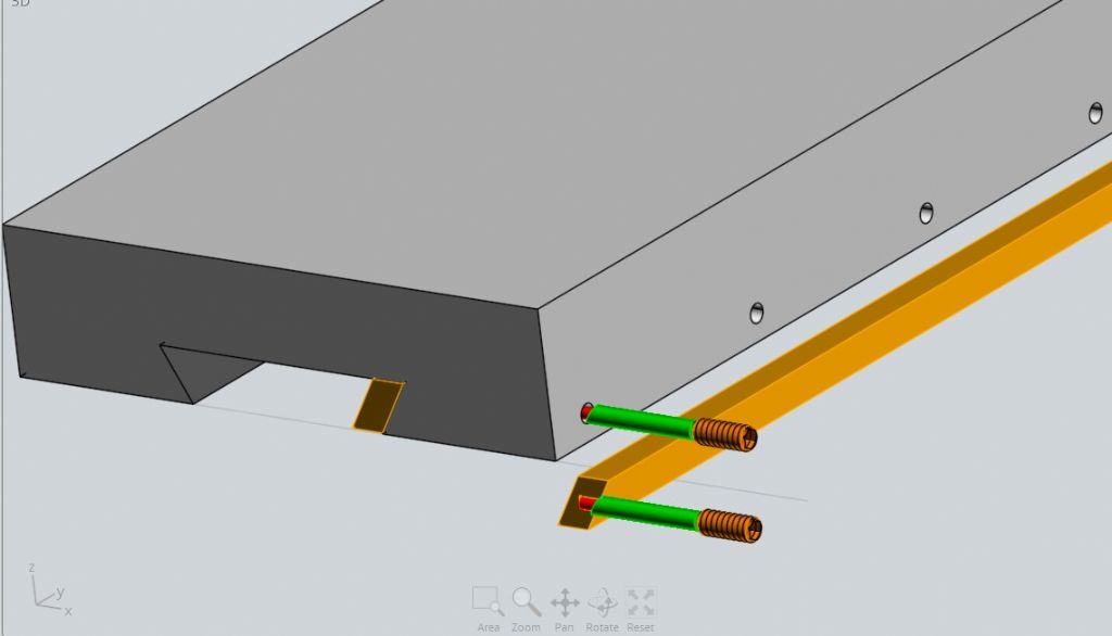

                              If you fancy an experiment and your eyesight is better than mine, try the trick of cross-drilling the adjustment screw and inserting a piece of nylon cord – such as is used in strimmers.  Cut overlength it acts like a nyloc screw. Leave the locknuts out of the equation. It worked for me on the retaining screw on my radius turning attachment. Use new screws and replace the old ones if it doesn't work out.
                              Edited By John Hinkley on 01/11/2020 10:30:18

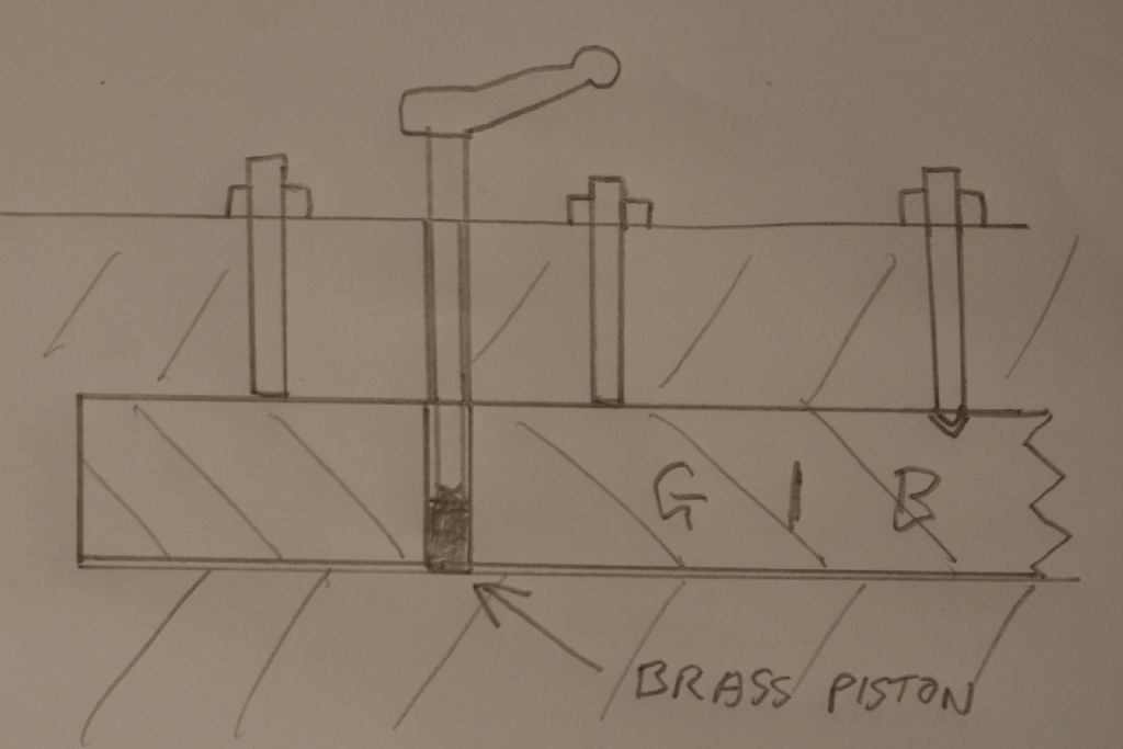

                                              This is how Tom Senior mills lock some of their gibs. It would work with the multi screw type, but not a tapered gib for obvious reasons. Drilling the gib could be a problem if it is hard and you don't have any solid carbide drills._igp2678.jpg
                                              #504750

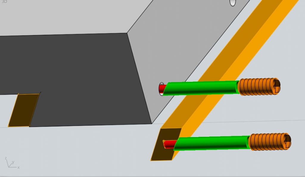

                                                      Posted by John Hinkley on 01/11/2020 10:28:58:
                                                      John – I think you won the internet today!
                                                      I cross-drilled the screw threads and…basically what you said:
                                                      Also polished the hemispherical ends of the pins, and drilled the new gib. I used a transfer punch – the length of the threaded holes means it pretty accurate. I also put a strip of card on the top edge before marking to ensure a bit of clearance above:
                                                      It works absolutely beautifully – just turn the screws until no play and the drag feels right, and leave them. No pratting about with lock nuts. Perfect.
                                                      Thanks!
