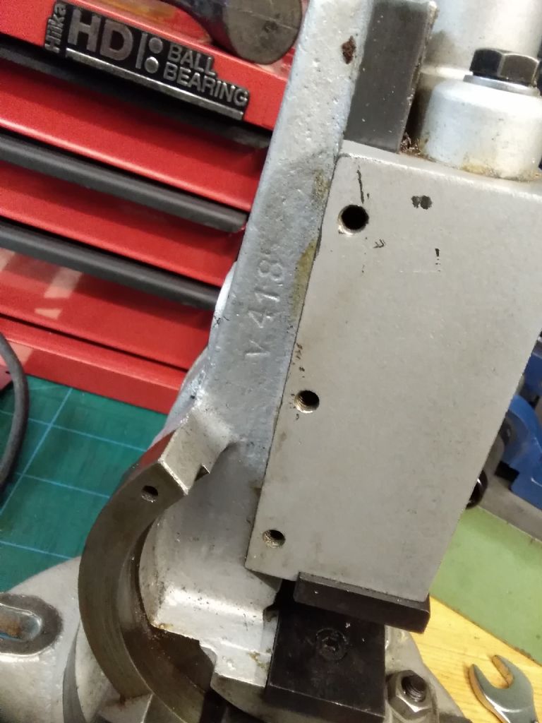

      6inch abwood machine vice it's got some play in it but I cantc shift the gib screws any advice on this one

          I have a 4" Abwood which when I aquired it had a similar problem. I found that the gib screws had 'back up' screws as 'lockers' which beared down on the adjusters below them. If you don't have external locknuts, back out the screw to check whether it is also uses a similar locking system.

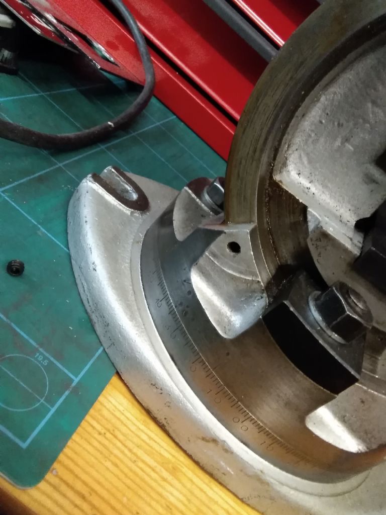

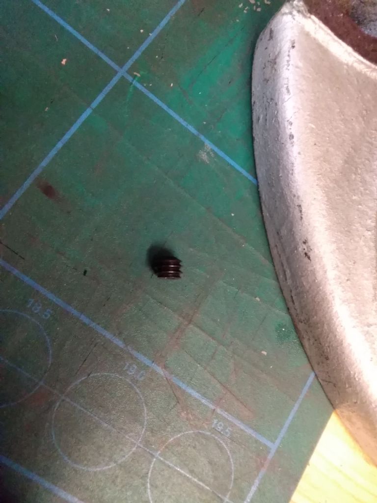

              Hi Kevin, I've just taken the grub screw out to see if there was anything out of the ordinary, from the picture of mine, you can see it's just a normal grub screw.
              On a side note, my tilting vice came without what I've seen looks like a little knurled wheel with what I presume is a tapered pin that locates in that hole for quick leveling of the vice, does anyone know A, where I could buy one, or B, what the Taper is so I could make something.

                I was just thinking, those grub screws seemed a bit short, so went and took one out again, and looked in there with a light, and Oily is correct, the hex grub screws are just lock screws, there is a flat head screw below that actually tightens the gib.

                  Peter F if memory serves me correctly the zeroing pin is parallel, it is just a plain reamed hole.

                    Thanks Baz, after cleaning with a ear bud, it appears you are correct, It's just a bit bigger than 5mm, I assume it's Imperial, but being in my mid 30's, I never work in Imperial and don't own any imperial drill bits to check size, If anyone owns one of these and can measure the pin so I can I can buy some rod to make one, I'd appreciate it.

                      Hi Peter the pin on ones I have used in the past had a thread larger than the pin to extract the pin but they were never used as the vice would be clocked level or at an angle when nessesary with a sine bar, and the pins were discarded as not accurate enough.

                        Thanks all it was as said adjuster behind

                                Abwood being an English product of several years ago, the threads and dimensions are very likely to be Imperial, ( BSW or BSF ). The Alignment pin is most likely to be 1/4", or if "about 5mm" it may be 7/32"
                                Why not check the size as accurately as possible (if you can't find out from a manual or some other owner ) and make one. You may even be able to find a drill (use the shank ) or a bit of Silver Steel of the right size.

                                  Just checked my vice and the pin is 3/16 diameter.

                                    Baz, thanks for taking the time to measure that, but a 5mm drill was a bit loose in mine, and 3/16 is showing to be 4.7mm, so mine is clearly a different size to yours unfortunately, I'll just have to turn something down until I get a good tight fit, thanks again.
