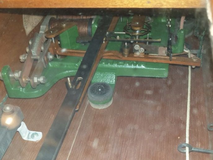

      #414299
      Robert Atkinson 2
        @robertatkinson2
        Yes, that is a master clock. Nice find.
        Robert G8RPI.
        #414300
          surprise
          blush
          Yes that looks right …
          Text at the bottom of the casting should read PUL-SYN-ETIC

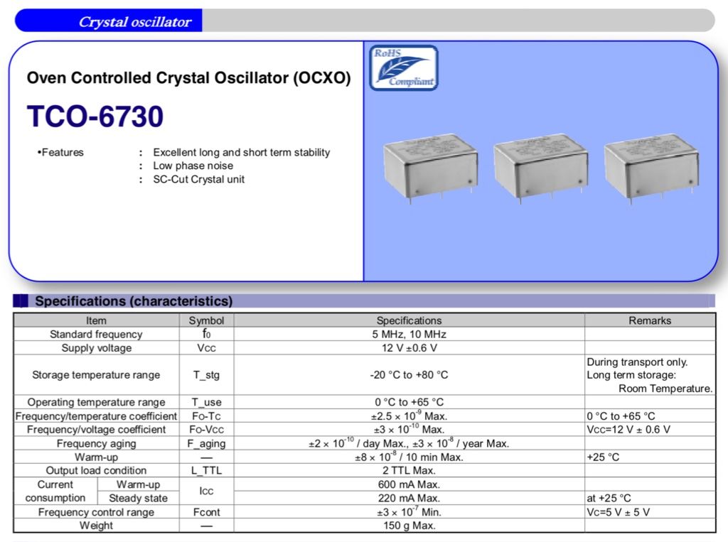

                        For clock setting you don't need a full GPSDO. Just get a Oven Controlled Crystal Oscillator (OCXO) or Temperature Compensated Crystal Oscillator (TCXO) with adjust ment and set it occasionally aginst a GPS. This is easy if you have an oscilloscope. Trigger the 'scope from the GPS 1PPS output (e.g.) put it on channel one) and monitor the output of the oscillator on one channel. The trace of the oscillator will drift across the screen. adjust it for minimum drift and it will be accurate to fractions of parts per million. you can then put the GPS away for 6 months. or more. This assumes it was already within 1Hz of nominal frequency.
                        Lots of OCXOs and TCXOs on ebay.
                        Robert G8RPI. (time nut, 5 GPSDO's, 4 Rubidium atomic frequency standards, HP 5370B etc).

                                          Any decent OCXO will be accurate to 1 part per million in a year (<1×10^6, HP's 10811A is more than 10 times better than that) so that's 31 seconds in a year worst case. Over shorter time scales eg days it's typically a thousand times better so 0.001 seconds per day. How good do you need?
                                          Robert G8RPI.
