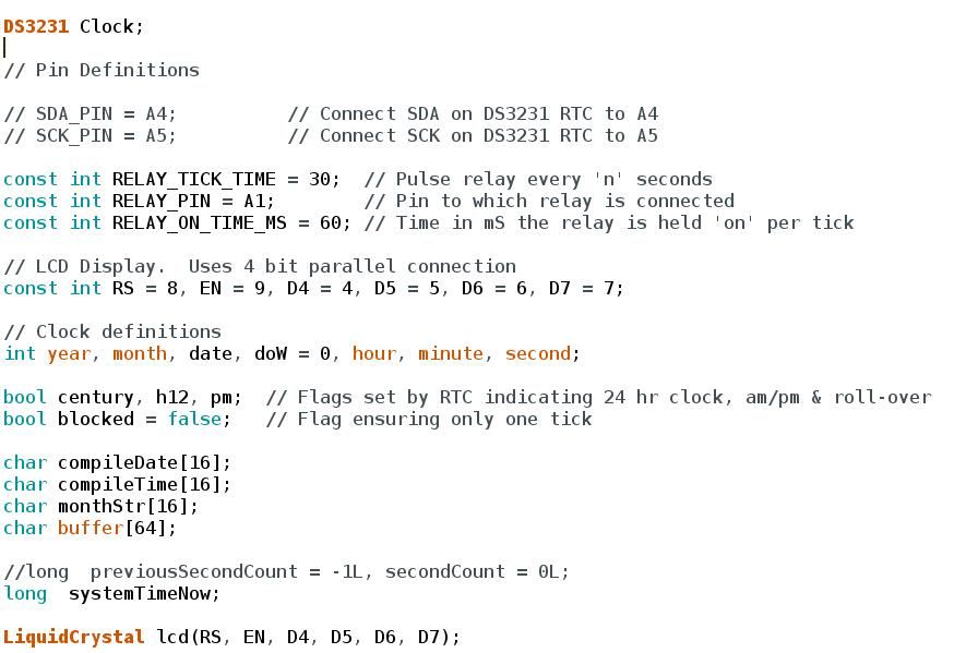

                                      #414201

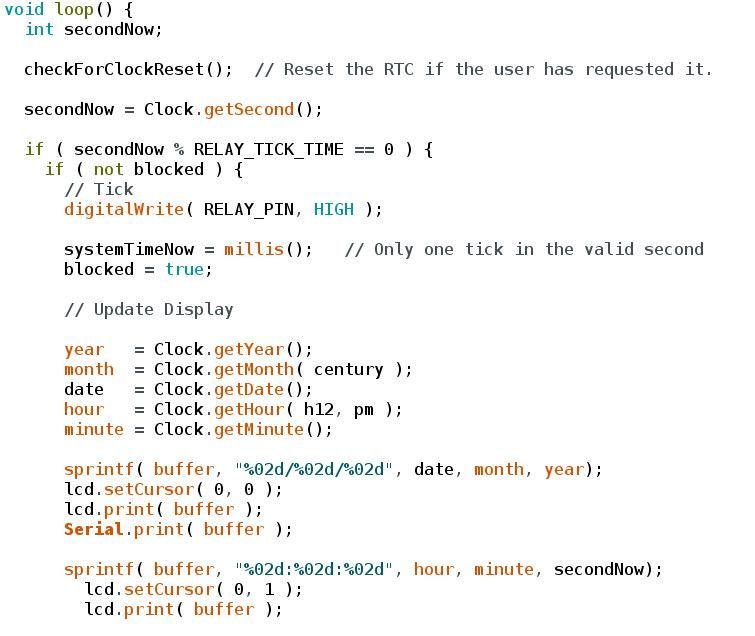

                                        PART 1
                                        PURPOSE
                                        To imitate a Gents pul-syn-etic Master Clock to drive a compatible Slave Clock, or clocks.
                                        REQUIREMENT
                                        1. An accurate timekeeper that maintains time even when the device is switched off
                                        2. User allowed to set the clock accurately
                                        3. Clock to display time (and date)
                                        4. Device to output a tick (pulse) at hh:mm:00 and hh:mm:30
                                        5. Pulse to be able to switch a substantial voltage and current
                                        6. Simple Mains Power Supply
                                        7. As plug and play as possible. (Minimal or no soldering, using common low cost components)
                                        8. Free, simplified development environment for the Microcontoller.
                                        HARDWARE
                                        1. The accurate Clock is a Real Time Clock Module based on the DS3231. The chip is a precision temperature compensated timekeeper commonly used by personal computers to keep time when the machine is switched off. They can be bought as a ready to use module from Amazon, ebay, and most electronic suppliers.
                                        2. As the Arduino microcontroller comes with a serial interface and can communicate with a laptop computer via a USB cable, time can be set by any computer with terminal access to the serial port. A package like putty, Hyperterminal etc.
                                        3. The display is a Arduino 1602 LCD module. Two types are available, this project uses the cheaper version, not with an I2C interface.
                                        4. A Microcontroller can be programmed to work the Real Time Clock, output 'Ticks', and run the display. I used an Arduino Nano, which requires some soldering The code will also work on an Arduino Uno, which has socket headers.
                                        5. As the output of a microcontroller is weedy it is used to drive a Relay Module; these are rated to 10A at 250Vac. The Slave Clock and it's power supply would be connected to the relay contacts, and thereby electrically isolated from the Arduino and other delicate electronics
                                        6. A Mains to 5V USB charger like this Wall Wart example.
                                        7. Constructed from modules as described above, connected by soldering, or Prototyping Jumper Wires & a Breadboard. (Make sure to get a good selection of Male to Male, Female to Female and Male to Female jumpers.)
                                        8. The Arduino IDE is free, well documented and may be downloaded to run on Windows, Linux or Apple computers. It is also possible to develop code online with a Browser. (Not tested this myself!) Libraries are available for all the modules used in this project: they remove most of the 'heavy lifting'.

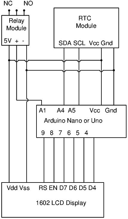

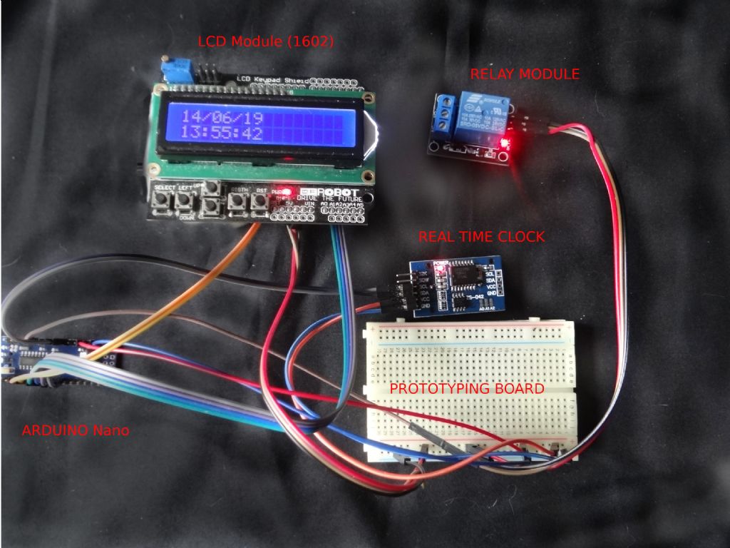

                                        CIRCUIT DIAGRAM
                                        In real life, as implemented as a prototype lash-up for testing:
                                        It would be possible to neaten up considerably by plugging modules directly into the prototype board. For a permanent solution, I would solder to Veroboard.
                                        More later…

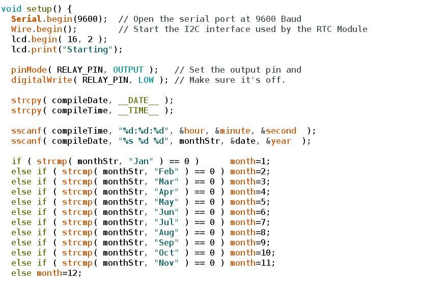

                                            The source code may be downloaded from Dropbox.
                                            #414209

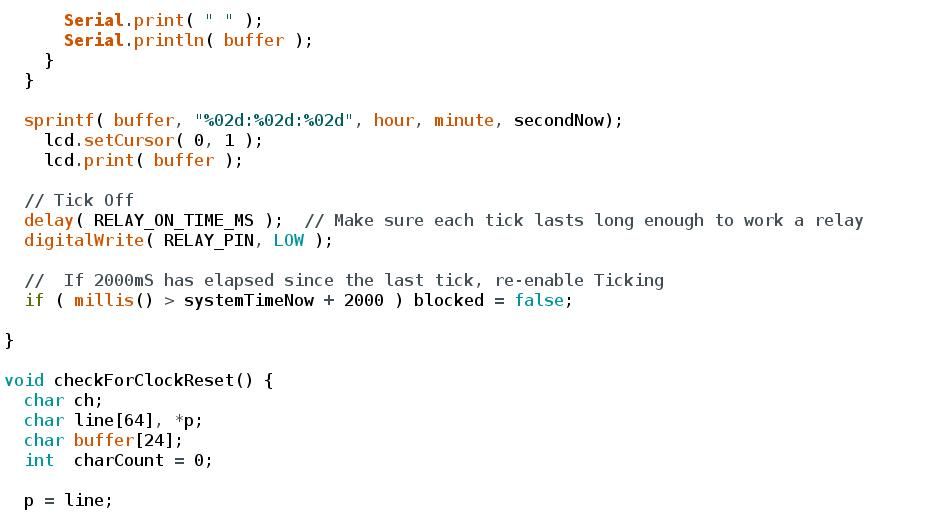

                                              PART 3
                                              Installing the Arduino IDE should also all install the libraries apart from that needed to control the DS3213 real time clock.
                                              The DS3213 library should be downloaded from http://www.arduinolibraries.info/libraries/ds3231 and installed using the Arduino IDE.
                                              Start the IDE by double-clicking the icon on the desktop. (Light Blue, with Infinity sign in white)
                                              Go to the 'Sketch' tab and click on 'Include Libraries', then select 'Add .ZIP Library'. Navigate to your Downloads folder and select 'DS3231-1.0.2.zip'.
                                              To compile the program (aka 'Sketch' , plug the Nano into the PC with a USB cable. Then go to the 'Tools' tab and click on 'Boards'. From the list select 'Arduino Nano'.
                                              Then go to the 'Tools' tab and click on 'Ports'. From the list select the /dev/ttyUSBnn or COM device identifying the Nano.
                                              Clicking the Right Arrow button, top left of window, should compile and load the program into the Arduino and set the RTC. Provided there are no mistakes in the wiring, the display should start showing time, aslo the relay should click every 30 seconds.
                                              If the Nano refuses to load, this may be because they are sold with two different bootloaders. (A bootloader is the short program the microcontoller uses to download and install an new program.) Go to 'Tools', and click on 'Processor'. Select the other bootloader and try again.

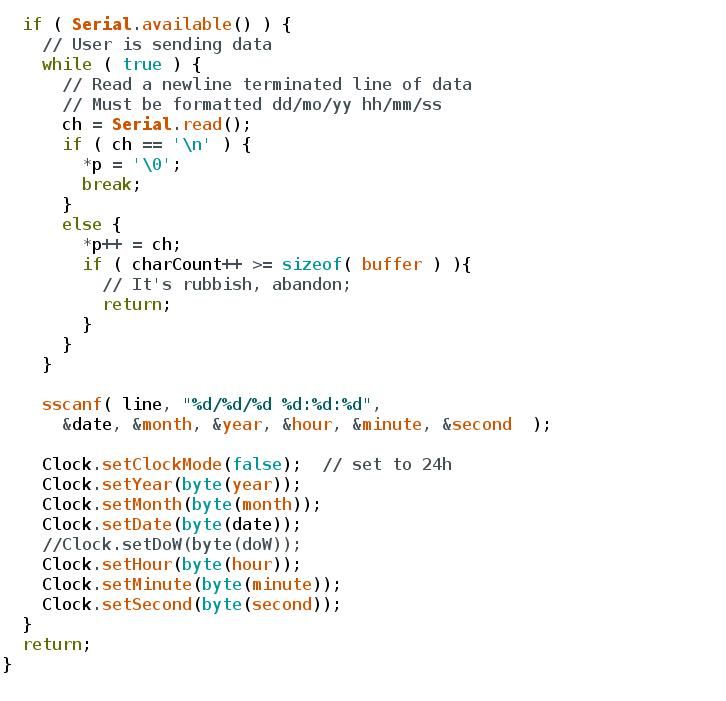

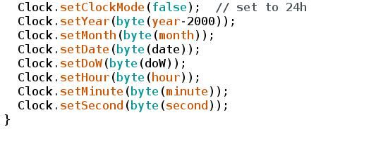

                                              As a convenience the Sketch sets the Real Time Clock to the time the Sketch was compiled. Depending on the computer and Arduino used, the time may be a few seconds out-of-date.
                                              To correct the time, go to 'Tools' and select Serial Monitor'. This will open a new window, which should be listing date times from the RTC. If garbage is appearing, the speed is probably wrong. Set it to 9600 bottom right.
                                              Once the screen is listing valid date times, the RTC may be reset by typing in, top left, a string in the form:
                                              dd/mo/yy hh:mm:ss
                                              for example:  14/6/19 13:02:00
                                              Type in a string that will be valid in a few minutes. Then, when an accurate clock reaches that time immediately press the 'Enter' key. This will set the RTC to the typed in time. The website time.is is a convenient accurate clock.
                                              BUGS
                                              None spotted by the limited testing I've done. I bet there's at least one and it's bleeding obvious! No prizes offered…
                                              Edited By SillyOldDuffer on 14/06/2019 16:19:25
