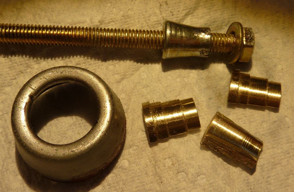

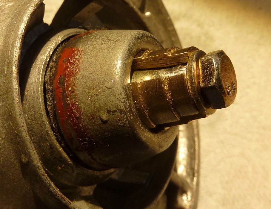

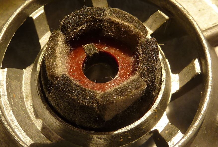

                Some more progress on the motor bearings with photos.
                I made the ‘expanding puller’. It took me a good deal longer than expected but not to worry. The core is a 6mm anchor bolt with the conical ‘expander’ from the same anchor bolt. I made a stepped bush from brass with an internal taper to match the cone and sawed it into four quarters. It worked a treat. The ‘indoor’ cap was still quite reluctant to shift but a bigger hammer did the business.
                I also made a stepped punch to drive out the bearing bush. With a 12mm socket supporting the other side, I squeezed the whole thing in the vice and it came out easily once the initial ‘stiction’ had been overcome.

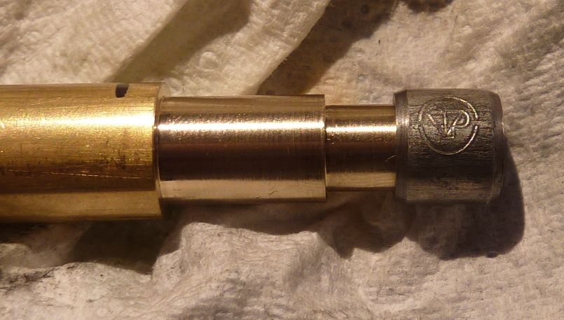

                So the bush is clearly not oilite, nor is it anything bronze related. It is magnetic, so most likely either iron or steel. It has some sort of logo stamped on the outside. The bush is 376 thou (9.55mm) long and the OD is 422 to 423 thou (10.73mm).
                The motor shafts mike at 316.8 thou where they run in the bearings – a fraction over 8mm… and too big to fit inside an 8mm ball race I think. There does not seem to be any measurable wear on the shafts which is somewhat surprising but perhaps indicates that the bushes are a good deal softer than the shaft.
                I’m a bit disappointed that the bush does not seem to be a standard size… unless there is another standard out there somewhere that I have not found. Does anybody recognise these bushes?
                So at the moment my least bad idea is to get some 8mm x 11mm oilite bushes and machine a small amount from both the internal and external diameters – ID first (with a boring bar) and then make a mandrel to allow me to machine the OD.

                  That's an ingenious take on the expanding anchor bolt based puller. Something I shall certainly make a note of although, so far at least, using the anchor bolt or stud complete with an alloy adapter to bring it up to bearing size has worked fine for me.
                  If you ever have to do another one its worth remembering that brass is a relatively slippy material. Aluminium alloy usually gives better grip. I suspect that four slots in a one piece expander with a slender section at the end so it can move would have worked as well and be much easier to handle than 4 separate pieces. Separate pieces ought to grip better tho'.
                  Your magnetic bearing is probably some form of sintered iron bearing. Same sort of thing as oilite, just a different material. One supplier here :- **LINK**.
                  If you get oilite bushes check the bore size as supplied. Generally they are made a fraction over to allow for shrinkage when pressed in to a housing. If they are sufficiently oversize to work with your shaft in the relaxed state consider using loctite to hold them without press fit.
                  In a similar situation I used a wrapped steel, Glacier DU dry bearing material lined bush. Due to the open seam down one side playing about with the housing bore let me adjust the inner bore for a good fit on the shaft. Used the dry bearing mostly because fix was needed immediately and that was what I had. Worked fine in that small motor for at least year or so before it all moved beyond my ken.
                  Clive.
                  Edited By Clive Foster on 27/10/2018 16:37:00

                    My puller has a step to engage with the bearing cover rather than relying on friction. I also made a few extra steps in the unlikely event that I ever need to use it for a smaller hole. Before I made the stepped bush I did try just wrapping some lead sheet around the anchor bolt but it didin't do the job – the bearing cover was too tightly attached so the bolt just pulled out of the hole.

                        the logo on the bush/bearing is Vandervell, better known for big end and main bearibngs for IC engines. Replacements may be available. have a search! the bearing is probably a steel backing with a softer white metal lining.

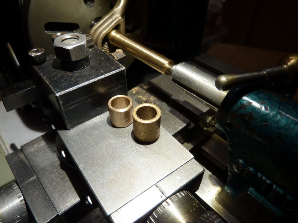

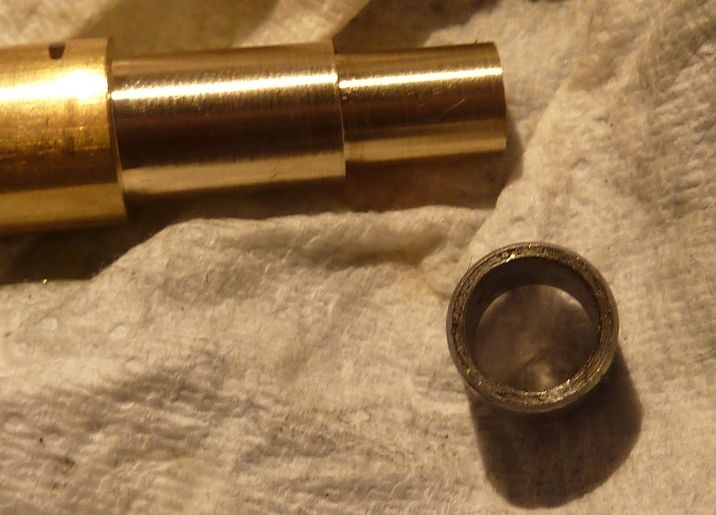

                                        New bearings installed.
                                        They are oilite bushes bored out a fraction, faced to reduce the length and then the OD was reduced by turning on a mandrel (which was also used to gauge the bearing while opening out the bore).
                                        The rumbles and rattles are now gone. Thanks for all of your advice.
                                        A 'before and after' photo of the bearnigs with the madrel in the background.

                                            Posted by Phil Whitley on 28/10/2018 16:32:59:
                                            Sorry, somehow I missed this post until now. Interesting to know the origin of the bearings. I took a look at their current site but I suspect that they have moved on from electric motor bearings. So basically my motor is (very) tenuously related to the Vanwall racing cars… which if memory serves were rebadged Ferraris.
                                            The shaft diameter still puzzles me though. Hopefully my modified oilite jobs will fit the bill.
