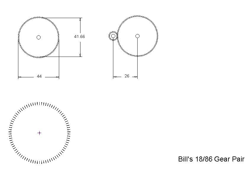

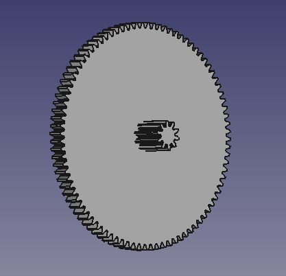

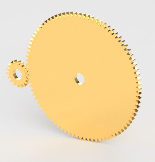

                          Looks like a German model from what I can see so metric gears
                          A 0.5MOD 18T gear is 10mm OD which ties in with your sketch
                          To get a gear to suit the 26mm ctrs you actually need a 0.5MOD 86T which has an OD of 44mm

                            Let's do a bit of arithmetic.
                            45 mm is 1.772 ins. DP of a gear = (n+2)/OD, so DP = 72/1.772 = 40.64.
                            That's a bit fishy not to come out (closer to) to a recognisably whole number, so convert to module and see if the answer is more comfortable.
                            Module = 25.4/DP so mod = 25.4/40.64 = 0.625 which isn't a "standard" number either.
                            Since I started this the picture above arrived, given the age I'd rather believe in DP science than module. 40 DP would be a recognisably standard number, would you like to check the OD of the blank carefully and see if 45 mm could be comfortably 1.800 inches/45.7 mm? I'd hate to think you went to all that trouble to make a gear which turned out to be a little bit too small!
                            And while we're at it, could you please advise why 70 teeth? If the 45 mm blank carried 69 teeth it would be 40.07 DP which I could believe was as close to 40 DP as one might expect to measure. Mind, dividing the circle up into 69 by eye is going to be more difficult!
                            Best rgds Simon

                                Simple maths you have 26mm gear ctrs, valley to valley of the small gear is 8mm so 4mm radius. 26mm less 4mm = 22mm so max diameter you could fit in is 44mm. which just so happens to be what I suggested

                                  If Jason has it right, and I'm pretty sure he has, then the gear you are aiming for is 86 teeth at 0.5 module, the OD of the blank is 44 mm. My calculation was based around the number of teeth being fixed, but now we have a dimension for the centre to centre distance that changes everything.
                                  Centre to centre distance = mod x (n1 + n2)/2 where n1 and n2 are the tooth counts of the two gears. I take it that Jason has used this to calculate n2.
                                  I suggest we need to be sure of the centre distance – everything depends on that.

                                      So the problem becomes "how to mark out 86 divisions around the circumference of a 44 mm gear blank".
                                      My Boys Own Dividers method wont work, because half of 86 is 43, which is a prime number. So resort to the paper and triangle method. You've mentioned "turning up a blank" so I assume you have a lathe, therefore a chuck, though any disc of known diameter will do.
                                      Assume for the sake of simplicity that the OD of the chuck is 100 mm. Then the circumference will be 314.2 mm. This doesn't divide neatly into 86 equal portions of any simple size, so take a piece of A3 paper and draw a line 315 mm long. This allows a smidgeon for the thickness of the paper. At one end draw a line 292.7 mm long at right angles to the first. Make the right angle as accurate as you can. Now join the two ends to make a hypotenuse 430 mm long.
                                      430 mm divides nicely into 86 times 5 mm. Mark these divisions along the hypotenuse.
                                      Now drop parallel lines from each mark on the hypotenuse to the 315 mm line. There will be 86 lines marking out the length of the circumference of the chuck. Cut out the 315 mm line, now divided into 86 equal increments, and stick it to the periphery of the chuck. Rig up a pointer as an index, mark out the 86 teeth on the gear blank.
                                      I'm betting Jason's drawn a drawing to explain in the time I've tried to explain.
                                      HTH Simon
                                      Bit of an OOPS!.  You need 87 divisions because the first and the last will be overlapping.  Otherwise the arithmetic is valid in principle, though wrong in practice.  Sounds like the comments I got in my last maths exam!

                                        Posted by Simon Williams 3 on 09/10/2018 16:53:28:
                                        You find a nice man to produce a PDF of a 66mm dia disc that will fit nicely on the spindle pully of your Unimat 3 plus a 1:1 outline of the gear so you can also try the stick it and file methodwink
