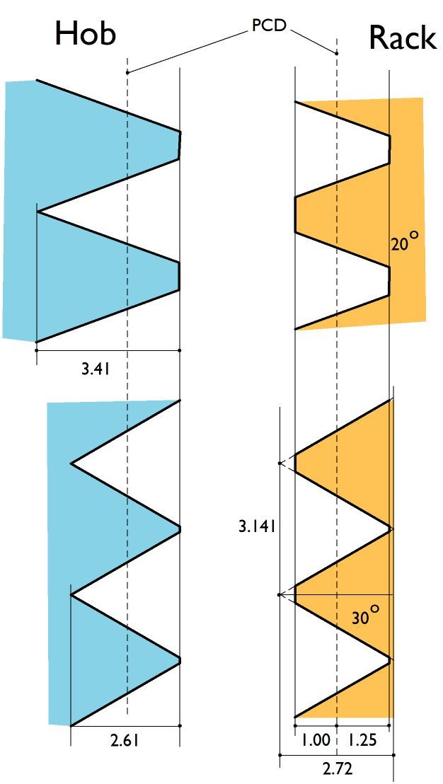

                                                Steve Crow
                                                  @stevecrow46066
                                                  I've been looking at 30 degree pa gears.
                                                  Here is a drawing of a rack form and hob to cut it. I've followed the usual formula for the 20 degree rack but it just doesn't look right at 30. Not much in the way of crest and the root is almost non existent.
                                                  Is there a reduction in addendum and dedendum for increased pa?
                                                  I've trawled through all the excellent links you have recommended but I can't find anything. Maybe it is buried amongst some of the impenetrable (for me) maths.
                                                  Cheers
                                                  Steve

                                                  Anonymous
                                                    Posted by Steve Crow on 15/04/2020 15:50:47:
                                                    In a word – no. Addendum and dedendum are determined by DP or Mod with an arbitrary addition to the dedendum for clearance. Of course at some point each tooth clashes with the adjacent tooth as PA increases.
                                                    Andrew

                                                    Steve Crow
                                                      @stevecrow46066
                                                      Thank you Andrew that makes sense
                                                      So is the 30 degree rack profile in the drawing correct? I realise that I can fettle the dedendum ratio.
