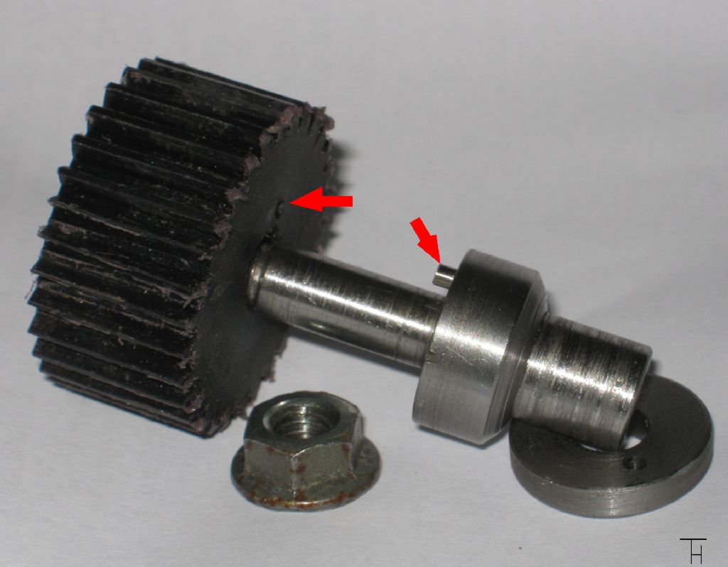

                  As John say, why not make one. I have made my own mandrels for cutting gears, I have tried to attach a photo that show a mandrel I made for cutting some module 1 gears in Delrin. The mandrel is intended to be used between centers.
                  To make sure that the gear blank doesn't rotate on the mandrel I drilled a 2mm hole in the flange of the mandrel (red arrow) – using the washer you can see in the photo as a drilling jig. I also use the washer to dill a corresponding hole in the gear blank. A short piece of 2mm silver steel prevents the blank from rotating. The left end of the mandrel is threaded and I use the washer and a nut to clamp the blank.
