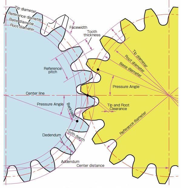

                                          I plead guilty to misleading by trying to keep my reply simple. DP is explained properly in gear books.
                                          For completeness, the 2" refers to PCD or Reference Diameter shown on the diagram below. It's not the outer diameter of the gear blank:

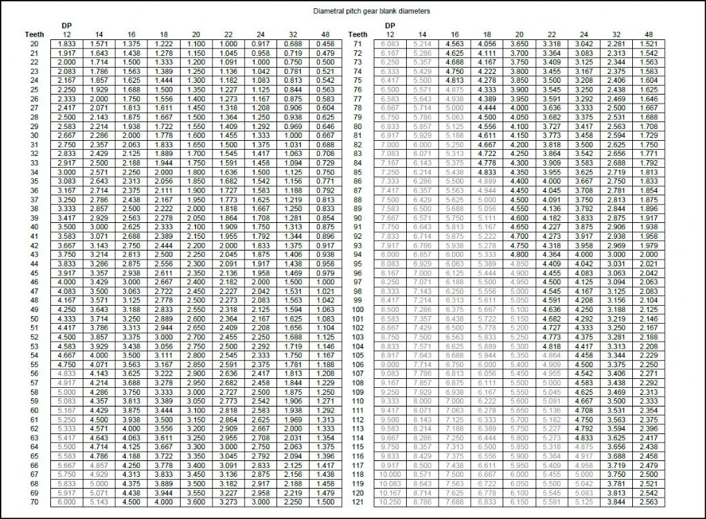

                                            Whilst on topic….. how does one calculate the blank size? So as an example, if you know your PCD is say 2", what size do you make the blank to?
                                            Also, How do you know the depth of cut – take it from the cutter?

                                              I've not seen it called "Reference Diameter" before (US terminology?) but …
                                              Outside diameter = Pitch Circle Diameter + 2S,
                                              where S is the Addendum, and = 1/DP or 0.3183 X Circular Pitch
                                              Working depth of tooth, called D for Dedendum, = 2/DP
                                              Then there is a root clearance below that, called the "f" value on a gear-cutter; so the full depth milled out is D+f; and = 06866 X Circular Pitch.
                                              (Law, p. 30)
                                              So for a 40T 20DP gear, outside diameter = 2 + [2(1/20)] = 2.1" .
                                              Cutting to the designated depth labelled "D+f" on the cutter itself, with a commercial cutter, from the correct blank diameter, will give the correct form. If you make your own gear-cutter you will need books such as Law's to calculate everything, but it is a good plan to go through all the sums anyway even with a commercially-made cutter, to understand what is actually happening and make sure your blank diameters and cut depth settings are correct.
                                              The text-books also tell us to cut to full-depth in one pass on a fine, steady feed, to minimise over-cutting errors.
                                              For our purposes it is usually sufficient that the finished gears mesh as they should and run smoothly together, with the tiny bit of clearance they need (the usual tip for setting up change-wheels on a lathe is to nip a piece of thin paper between them). The trade has special micrometers etc. for gear-tooth measuring to the sort of precision and accuracy demanded.

                                                  Posted by Matt Stevens 1 on 23/08/2022 21:30:57:
                                                  I have a chart that's laminated and stuck on my wall. It's tailored to my own hobbing machine and common pitches I might cut but it's a very good quick reference. You could easily knock up your own chart in excel/calc.
                                                  Depth of cut you should take from the cutter – if it's a hob you should certainly take the DOC from the cutter because there are different types. Brown and Sharp hobs have different DOC to others and there seems to be no fixed rule for the older ones at least.
                                                  Edited By Pete Rimmer on 24/08/2022 06:52:03
