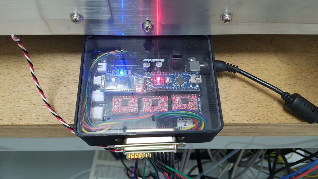

                  I use an Android App called Grbl Controller to send Gcode to a 3-axis Eleksmaker Grbl controller over Bluetooth serial (based on an Arduino nano with added HC-05 or similar Bluetooth module). The motherboard and nano cost little more than £20. It works very well and the App is free. you can send Gcode files, or just use up/down left/right etc buttons on three axes. I think it came pre-flashed with Grbl, but anyway no editing required, except for maybe baud rate in the config.h file.

                                      Not quite answering your question but I started with GRBL on an Uno and ended up running Marlin firmware on a Mega 2560. If you run Marlin then you have the option of an LCD screen and a memory card on the controller itself as well as running off G code from an external 'sender'.
                                      My own reason for running Marlin was software backlash compensation. GRBL also has a version that can do this but it won't fit on an Uno – you need a Mega 2560… the killer for me though was that moving to GRBL on a Mega means moving to completely different I/O pins and therefore not being able to use the CNC shield. I was able to set up Marlin to work with the CNC shield.
