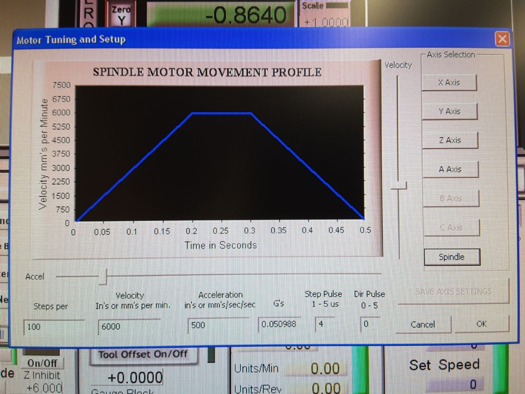

                                      Just put the infra-red tacho onto mine, all very close except at 4000rpm which was a bit off
                                      5K = 5009
                                      4K = 4170
                                      3K = 3030
                                      2K = 1995
                                      1K = 1017
                                      This is the tuning screen settings are as it came to me. click to see larger
                                      Edited By JasonB on 10/04/2020 10:32:39
                                      Edited By JasonB on 10/04/2020 10:36:18

                                            #463772

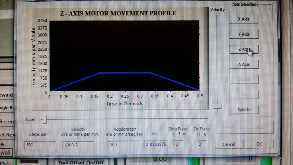

                                              20200410_171048.jpgPosted by Sarah on 09/04/2020 19:37:30:
                                              Posted by Ian Johnson 1 on 09/04/2020 19:34:56:
                                              Posted by Sarah on 09/04/2020 17:46:59:
                                              Hi Ian,
                                              Would you be able to let me have your settings please 😊
                                              The pulse settings changed them selves from 4us to 3us after I increased the velocity, which then put the speed back down. Jus coildnt get them to change back to 4us.
                                              Thanks.
                                              Edited By Sarah on 09/04/2020 17:47:44
                                              Yes I'll have a look for you Sarah probably tomorrow because I've got a virtual pub quiz to take part in tonight!
                                              I hope you enjoy your virtual pub quiz, I hope the beer is not virtual 😉
                                              Best wishes,
                                              Sarah
                                              Hi Sarah here is a photo of my KX1 Z motor drive settings. (Edited to include the photo above which I forgot to post! )
                                              Steps per = 500
                                              Velocity = 1000.2
                                              Acceleration = 100
                                              G's = 0.0101976
                                              Step pulse = 0
                                              Dir pulse = 0
                                              A little bit different from your settings. No idea if they are the 'correct' settings but they seem to work okay. It's a USB KX1 by the way if that makes any difference?
                                              Oh and I got 25 out of 50 in last night's virtual pub quiz 😁
                                              Ian
                                              Edited By Ian Johnson 1 on 10/04/2020 17:28:57

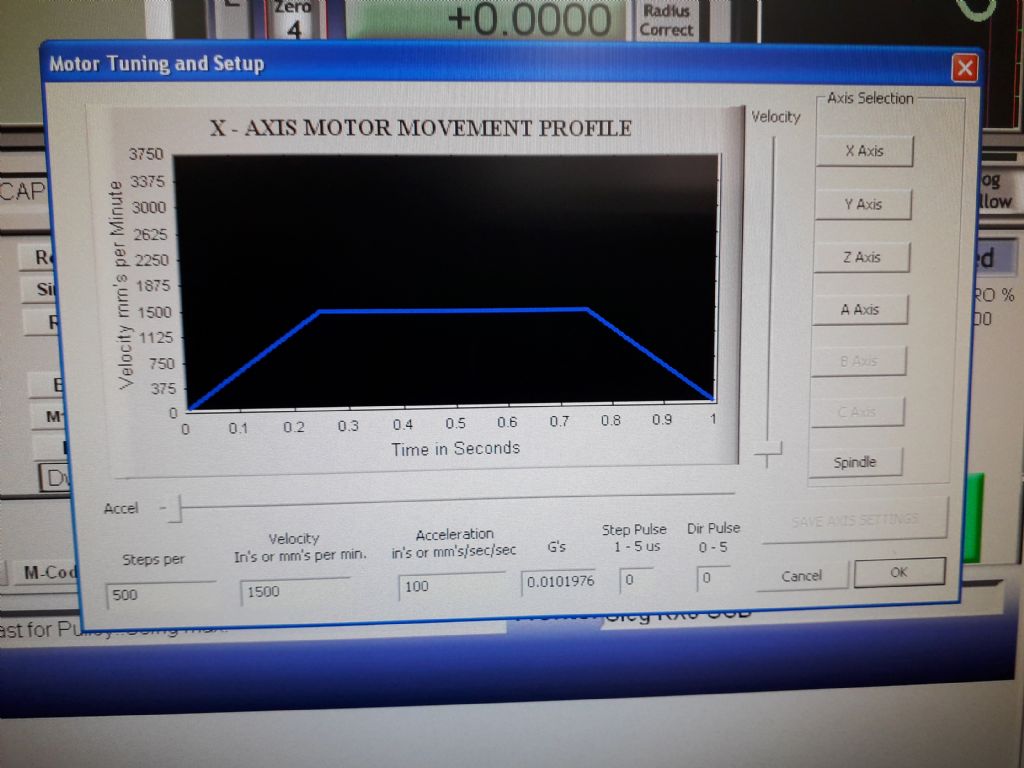

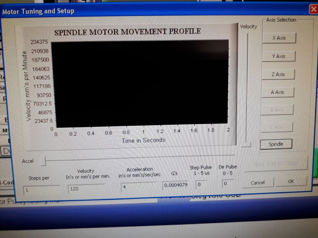

                                                  Sarah F
                                                    @sarahf
                                                    Hi Guys,
                                                    Thank you for the photographs of your spindle settings, your figures are very different to each others and also to mine as well. I've added a photo of mine below. The three machines are:
                                                    Steps per.      Velocity.       Acceleration
                                                    1.                     120.               4
                                                    500.                 1000.2.        100
                                                    100.                 6000.            500
                                                    A few questions for you if you don't mind.
                                                    I understand what 'Steps per' do on the X, Y, Z axis relating to the stepper motors and ball screw drives, but what does it do on the Spindle Speed and why are our three machines so different?
                                                    Why are the Velocity and Acceleration figures also so different for the three machines?
                                                    I removed Mach3 and the Sieg setup files from my PC, then installed them again to make sure I had the default setting. If I go into the Motor Tuning screen, don't change anything and exit by just closing the X on the top right of the screen the Step Pulse won't change from 4us. However if I go into the Motor Tuning screen and click on the OK button to leave the screen, then when I go back into the Motor Tuning screen again it has changed to 3us. It will retain a value of 3us and 5 us.
                                                    When it does change the Step Pulse to 3us, or a value of 5us, this changes the value for the X, Y and Z axis as well and changes how the axis are driven. Will driving the X, Y and Z axis at 5us cause any problems?
                                                    I can match the measured and demanded spindle speeds if I do change the Step Pulse to 5us, but I'm wary of changing bits I don't really understand.
                                                    Thanks for the video's and pictures of your work on your machining, giving me a good idea of what to do. I'll post some of mine soon hopefully.  I wouldn't have thought of fixing a bit to be machines to the side of a chunk of aluminium, it will make a bit I need to machine a lot easier thanks.
                                                    I appreciate your help, hope I'm not asking too many questions, I'm just eager to learn.
                                                    Best wishes,
                                                    Sarah
                                                    Edited By Sarah on 12/04/2020 09:38:58
                                                    Edited By Sarah on 12/04/2020 09:41:50
                                                    #464141
                                                      Sarah, going by what Adam (Son of the late John Stevenson) said both mine and Ian's are connected by USB so our speeds are controlled differently to your earlier parallel port machine which is why I have nothing on the spindle screen and would think Ian's would be the same though he only showed the X axis..
