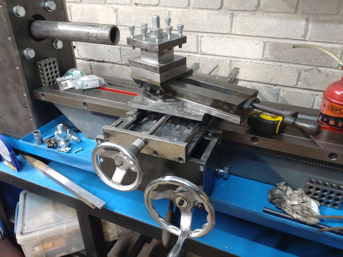

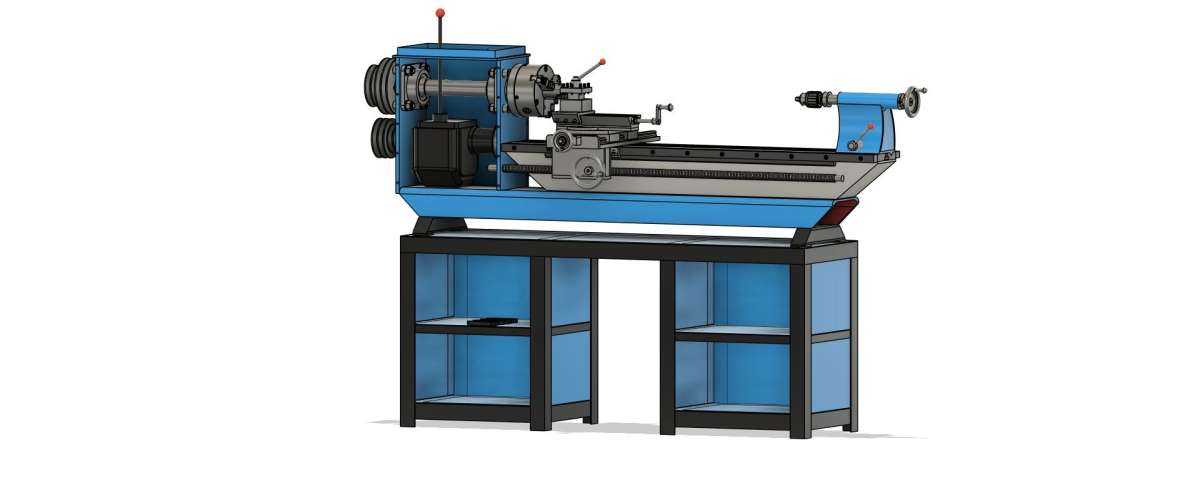

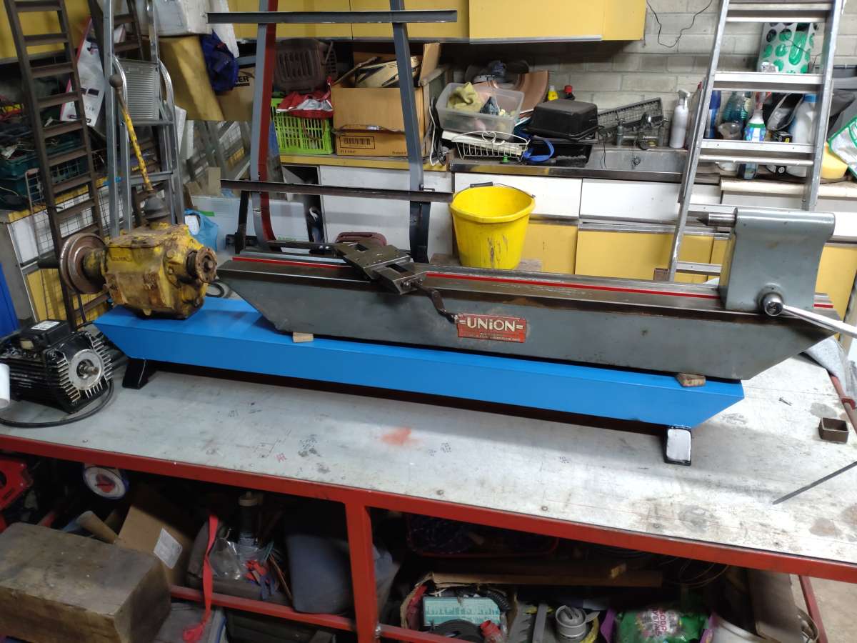

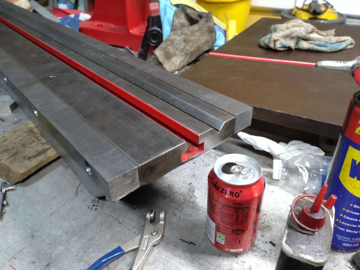

      Hi I’m new here on the forum.  I have always wanted a lathe but could never afford one, my only option was to build one myself, or try to at least.
      My question is, what would be the common mod/pitch size for a geared rack ?
      A little information about what I am building, the bed is 1290mm long and came from some sort of shaft grinding machine.  For a gearbox I’ve got one from an old dumper. It will use a 3 phase electric motor around 1.1 to 2.2 kw with VFD and various pulleys to bring the rpm down to a usable speed. It will have a 200mm chuck. The cross slide will run on linear bearings. Below is a cad drawing of the lathe and the parts I have so far .
      DSC_2123DSC_2142
      I have just received the steel to make the head stock/ gearbox housing and a cabinet to set it on, so hope to make progress over the holidays.
      Thanks for any reply, Noel.

        At that sort of size 2MOD would do.
        However as you are going a bit away from convention with your linear guides consider an ELS(electronic lead screw) which is driven by a motor at whatever rate you enter be that for fine feed or a thread.

          Noel

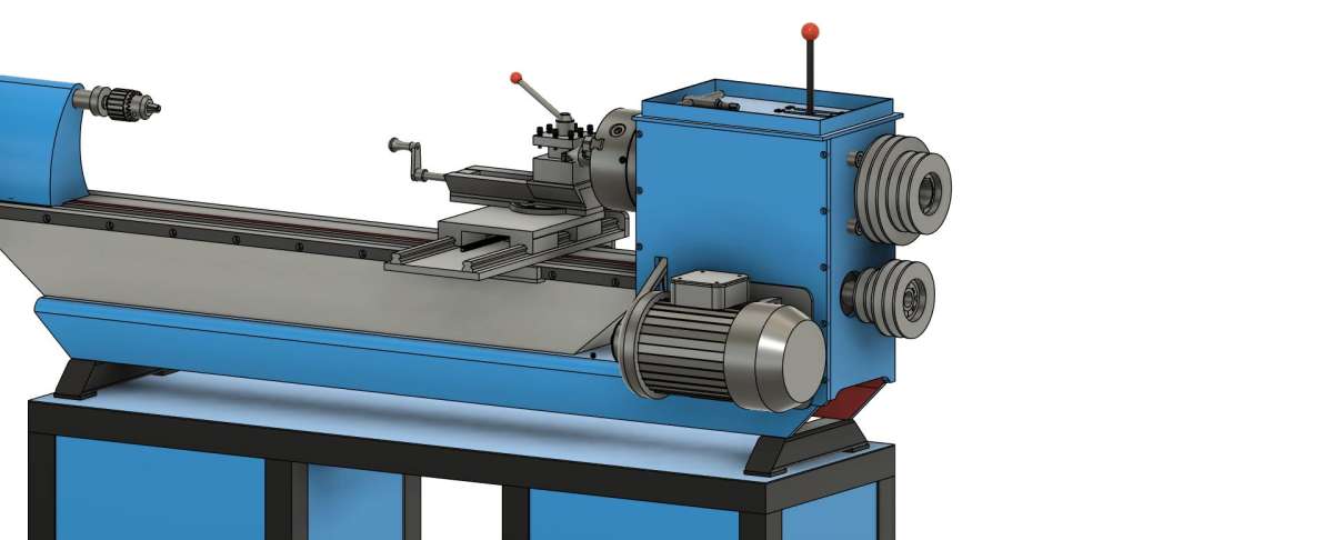

          Interesting project! I like the use of the ready-made bed.
          If I’m understanding your scheme correctly, I think you will find the headstock spindle a weakness. I assume you are effectively mounting the chuck on the gearbox output flange. Is that output shaft constrained well enough in the gearbox to give you the stiffness you need for a headstock spindle? Also you may find having no spindle through hole a limitation.
          Also consider the torsional stiffness of your bottom support channel. I would be tempted to see whether the headstock can be mounted directly on the bed, which should give you a more stable connection.
          I agree with Jason about considering an ELS system (though that may be outside your budget). Assuming you are wanting to be able to do thread cutting that will be the simplest route.
          I also think that a 3 phase motor and vfd will be sufficient without any gearbox (especially if the motor is powerful enough to give sufficient torque at low speed). I have a Raglan 5″ from which I have stripped all the variable speed drive and layshafts, and just run a 1hp motor and vfd connected directly to the spindle with a belt drive giving motor speed about twice the spindle speed, and so far that seems fine. I’ve also just removed all the gearbox and drop gears and fitted a 2-axis ELS. I have literally just done that so have very limited testing so far, but there are no apparent problems.
          Best of luck with your project.

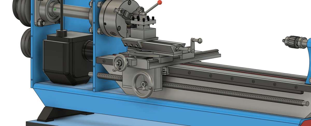

          #771784
            Excellent, most start by buying a lathe and learning to use it by making a few simple hand tools.   For this Moogie gets a Gold Star with bonus brownie points.  Well done him!
            Here’s a few suggestions though. I’ve annotated Moogie’s CAD screen-shot as a guide.
            moogie
            The U-channel ‘A’ used as a base is a potential weakness in the design, because it’s less rigid.
            Lack of rigidity in the base ‘A’ will show up at ‘B’, where the headstock sits on the U-channel, disconnected from the stiff Union bed.  The headstock transfers power from the motor to the cutter and it’s important it can’t flex relative to the bed.  Moogie proposes a motor in the 1.1 to 2.2kW range, so the headstock and base have to cope with significant torque.  This isn’t a toy lathe!  One cure is to mount the headstock directly on the Union bed, another is to make sure base ‘A’ is rigid, perhaps a box section, or internally cross-braced, or fixed to a hefty bench – many variations available.
            Although I’ve suggested mounting the headstock on the bed, leaving it on base ‘A’ allows another opportunity.  ‘C’ shows Moogie plans to have the headstock butting close to the bed.  However, it’s also possible to create a useful gap by moving the headstock away on a longer bed.  Gaps between headstock and bed are useful because they allow large diameter work to be turned, provided the gap doesn’t reduce rigidity too much.
            At ‘D’, consider:
            • Three feet rather than 4 might be an advantage because 3 feet can’t rock – the machine is more stable. (I’d probably stick with 4.)
            • Adding screw adjustable feet to ‘D’ will make it easier to “level” the lathe.   To be pedantic, levelling in the sense of getting the lathe at a right angle to the ground isn’t important, the goal is to remove any twist between the bed and the headstock.  Test alignment with ‘Rollies Dad‘, then remove any twist found by tweaking the screw feet, which act as jacks.

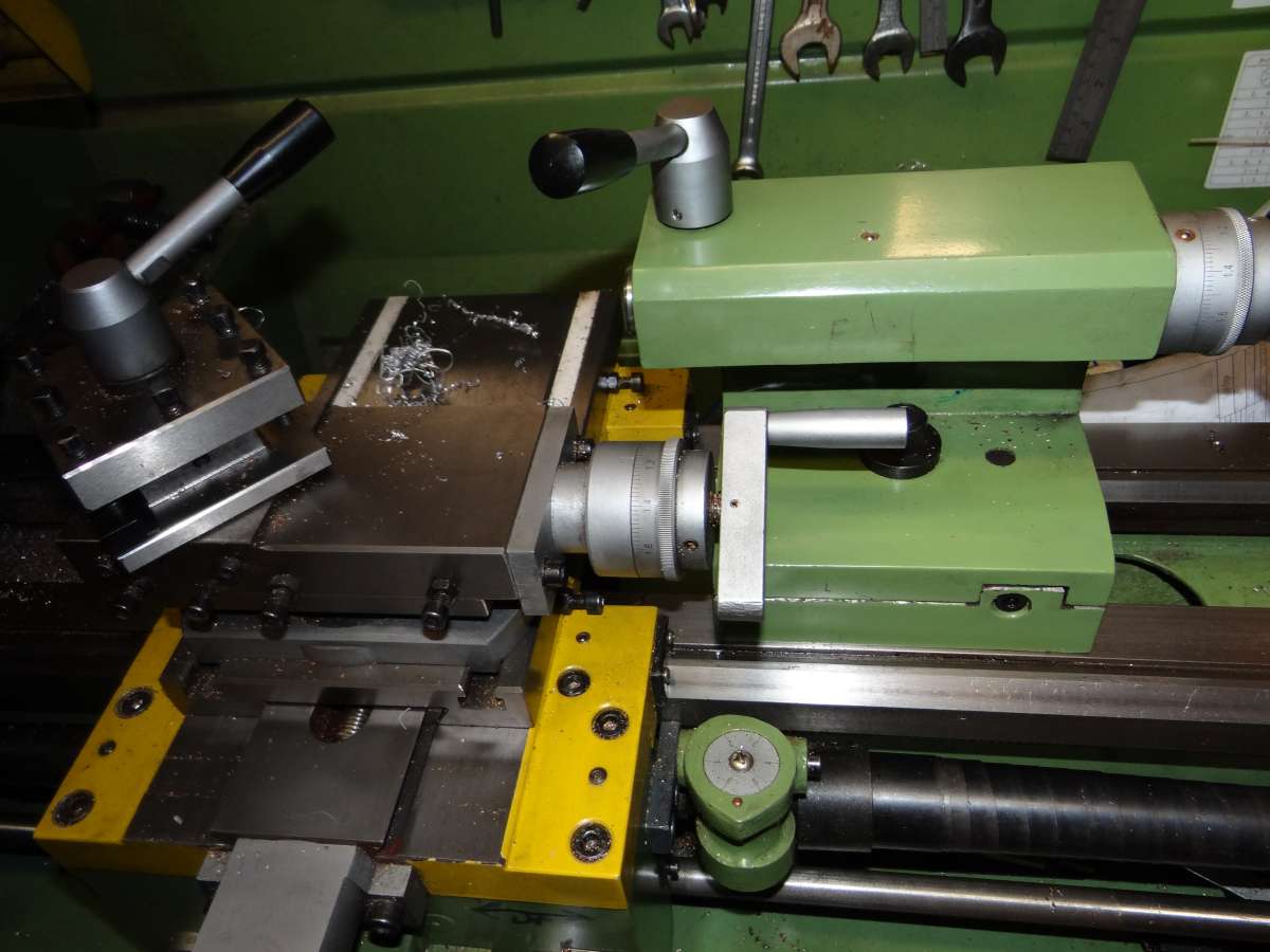

            At ‘E’ I was going to recommend simplifying the tailstock, less work, but I see Moogie has already made a pretty one!  Whether or not the tailstock needs to be shaped depends on the saddle, cross-slide and tool-post.  My lathe’s saddle has protruding ears front and back that improve stability.   The tailstock fits between the rear ears, and is shaped to leave  space for the compound slide and it’s hand-crank.  It allows the tailstock to get closer to the headstock, even though the saddle assembly is in the way:
            DSC06873
            Having CAD that can model Assemblies is helpful here.  Makes it possible to see what happens when the tailstock and saddle get close together – at what point do they collide, and can the design be changed to create a closer engagement.
            Despite all that I advise Moogie to keep it simple.   His approach is sound, and I’m sure his lathe as described so far will perform.  The many refinements that are possible could add years to his project, and may not help much.   A lot of good Model Engineering is done on simple equipment, and with machines in poor condition.

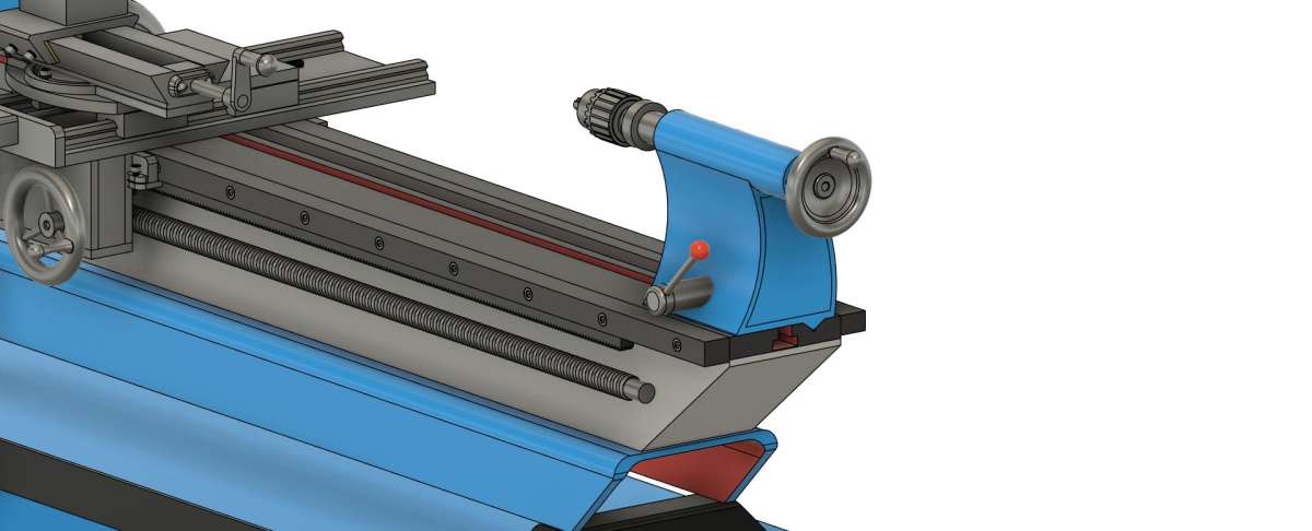

                #771867
                moogie
                  @moogie

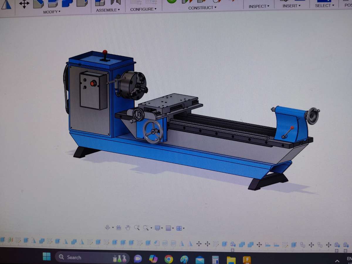

                  Thanks everyone for the suggestions,  I can see logic in your recommendations.
                  I can bolt the tail of the Union bed to the head stock box which should help and web the underside of the base channel which will improve the torsional rigidity.  Also i am making a cabinet to bolt it to and to each other part . The gearbox won’t be carrying the chuck but will be only connected to the motor and spindle shaft by belts and pulleys.  The spindle will ride on plumbers block bearings and uses a 50 x 6mm tube.
                  The linear guide rails will only be used for the cross slide. (Picture below).
                  I have been looking for second hand lathes/ lathe parts for quite a while but there isn’t much choice over here in N.Ireland and what there is is twice the price of anything in Scotland or England.  So my last resort was to try and make one from what bits I could find. My father originally served his time to the turning and my friend has a small engineering firm, so I’m able to get help from them.
                  The tailstock is the original one that came with the Union bed but the downside is that it has no side to side adjustment,  which means any adjustments will have to be via the head stock to get it aligned.
                  For any parts that I will be making thy will be very basic and don’t intend to do any screw cutting at the moment. Only thing that I could add would be a power feed, but this could be made from an electric motor with a 10:1 reduction gearbox and a DC speed controller .
                  Without the use of a VFD my head stock speed will be roughly 80 – 700 rpm via the pulleys and gearbox. With a VFD it will have a greater range of rpm.
                  I really appreciate everyone taking time to add there suggestions as you will have much more experience working with lathes than I have.

                      Moogie,  I saw your statement above relating the lathe bed,  I am certain it is in fact the bed from a set Bench Centre’s use in inspection departments for checking concentricity or eccentricity.
                      Good luck with the build its looking good.

                          #772053
                          Howard Lewis
                            @howardlewis46836
                            Full marks for courage, to build one’s own lathe.
                            Yes, I think that the Tailstock and Bed are from a set of bench centres, hence the lack of facility to change / adjust alignment, and no locations to fix a Headstock.
                            I would be a little suspicious of using ordinary plummer blocks.  They may not provide the accuracy needed for a lathe. (Once I saw a number of engine failures because a supplier had use commercial plummer blocks to make a grinder for the broaches used to make the shell bearings for the engines.
                            The chatter produced, showed up in the bearing failures when the engines were tested.)
                            In all honesty, being over cautious perhaps, I wouldn’t start from here
                            A second hand machine might be better net, and a quicker route to getting going.
                            Howard

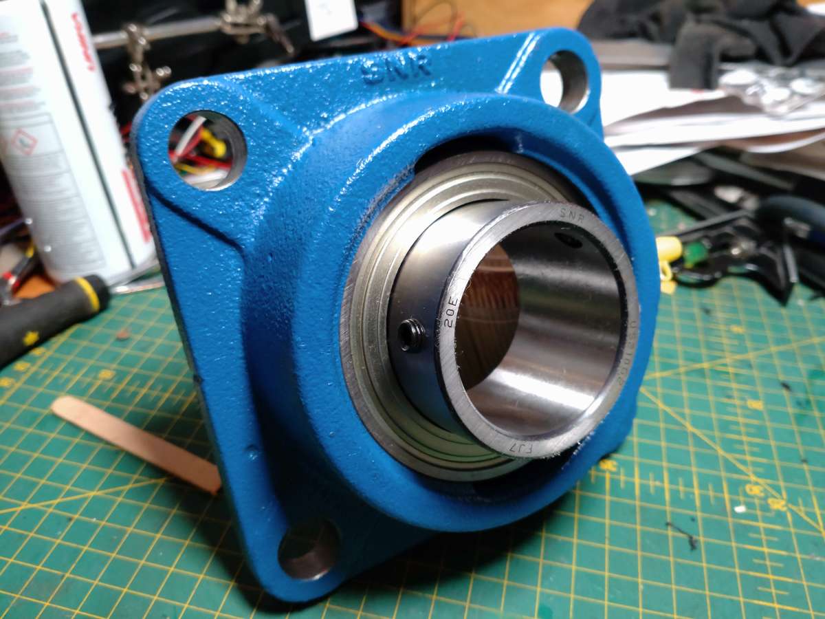

                                    Thanks all, the plumbers blocks will do to get me up and running,  I can then make something to hold a taper or angular bearing later.
                                    This won’t be the most precise lathe but it should be good enough to let me make cyclekart parts which are fairly basic.

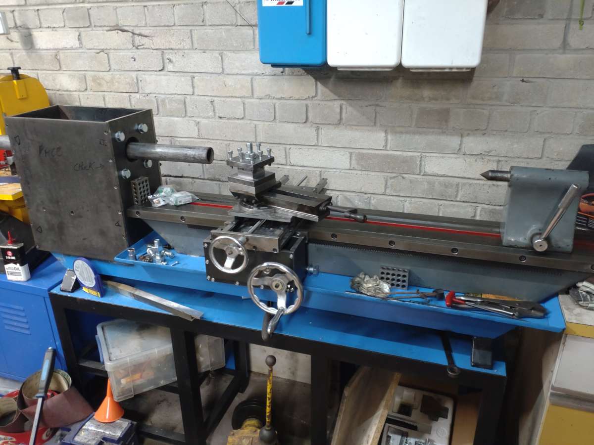

                                            #789758
                                            moogie
                                              @moogie

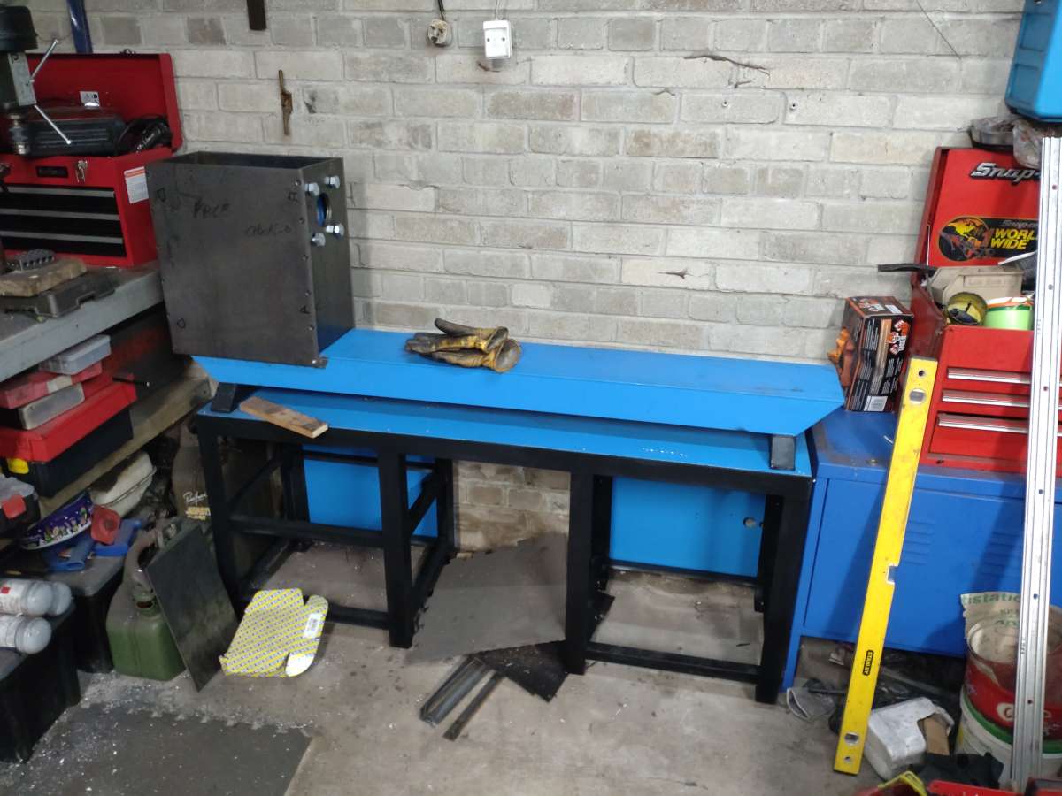

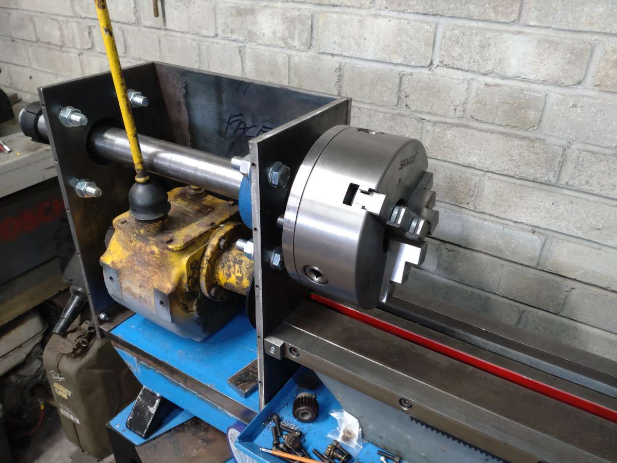

                                              Update,  coming together slowly.
                                              DSC_2180
                                              DSC_2179DSC_2206DSC_2205
                                              #789833
                                              Diogenes
                                                @diogenes
                                                You’re making good progress – are you using ball-screws for the slides? ..not sure whether I would..
                                                #789938
                                                moogie
                                                  @moogie
                                                  Just normal lead screw with a nut, really happy with how it turned out , very smooth with no backlash.
                                                  #797761
                                                  moogie
                                                    @moogie

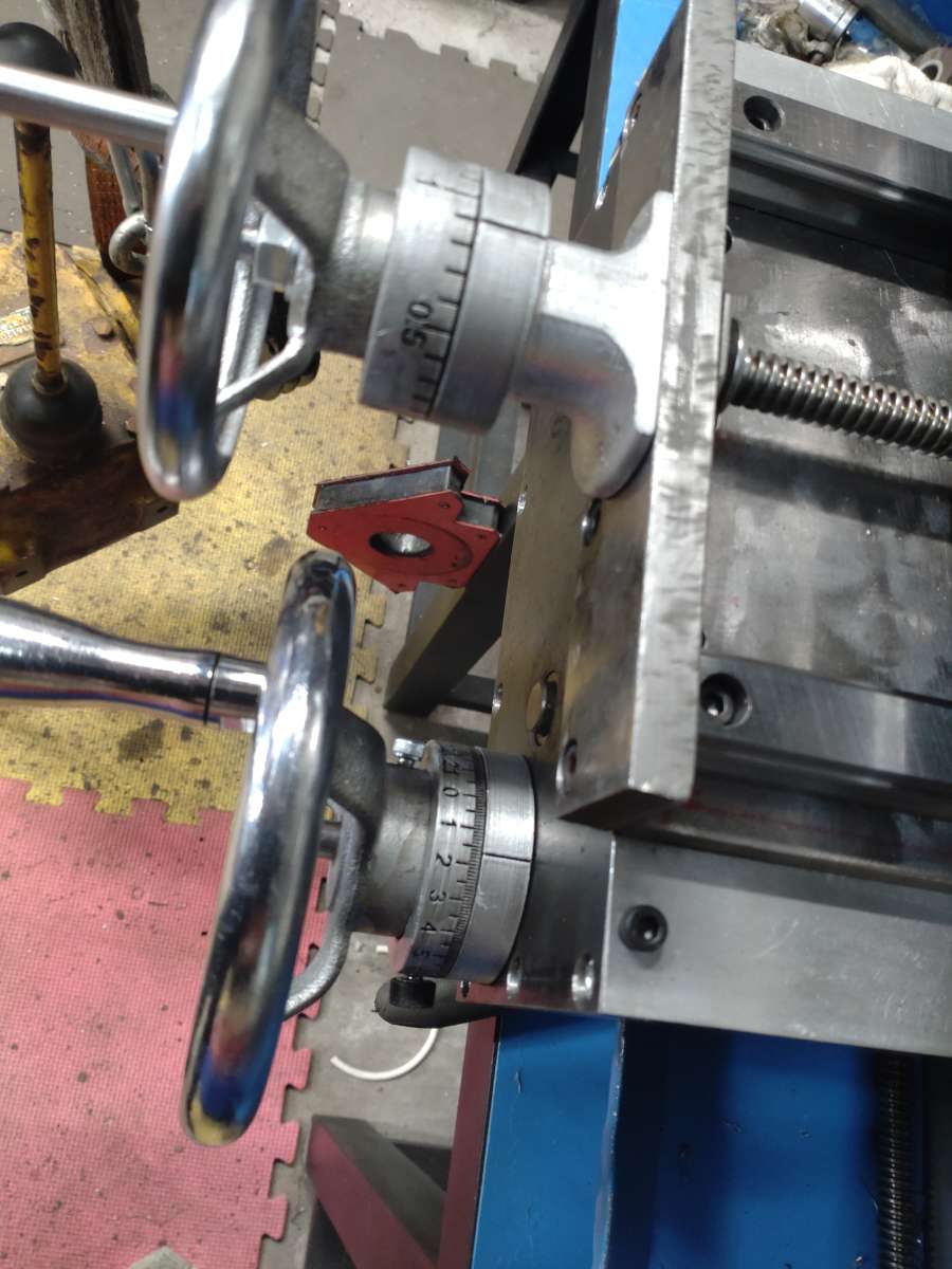

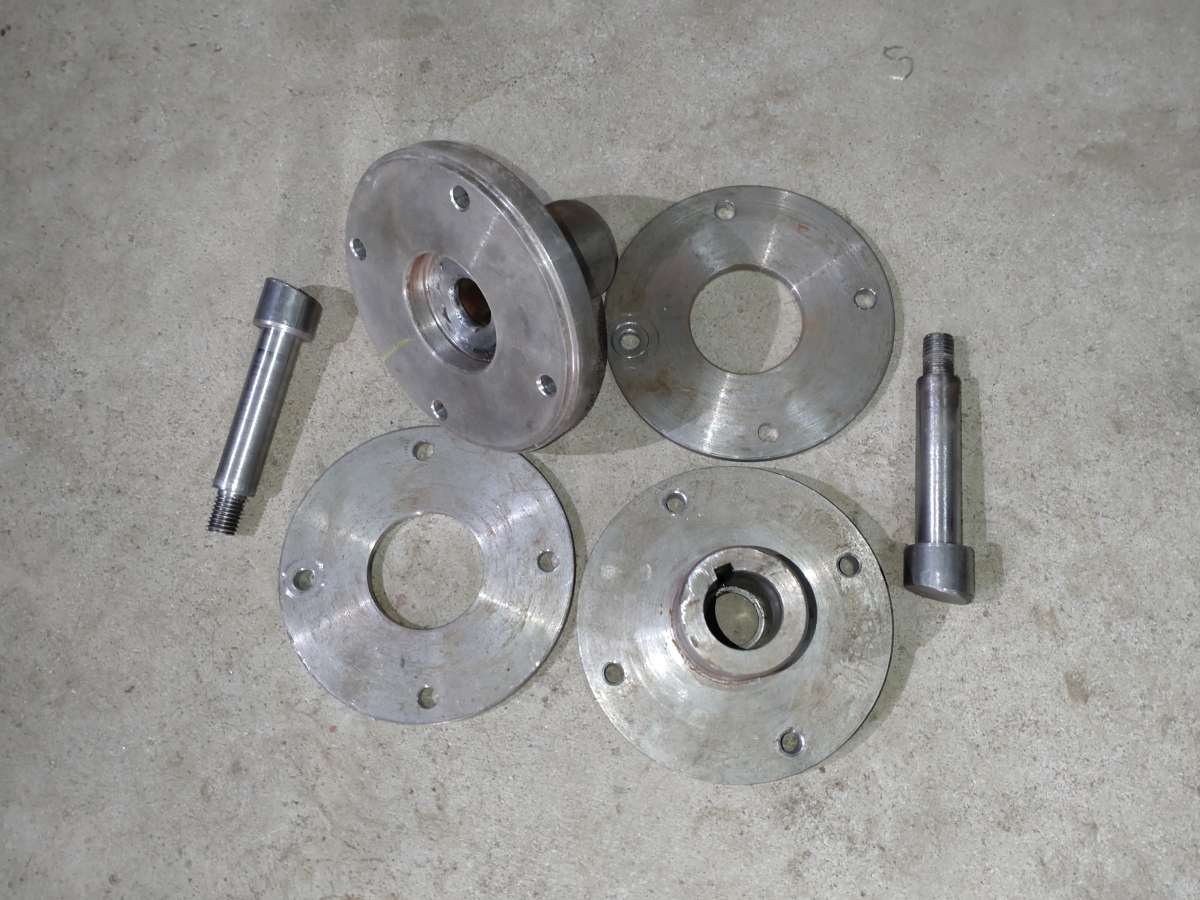

                                                    A few more bits made. Head stock shaft in and chuck acquired.
                                                    3D printed graduation dials. Main carriage moves 22mm with one turn of the handle and the cross slide is 3mm per revolution.
                                                    DSC_2222DSC_2219

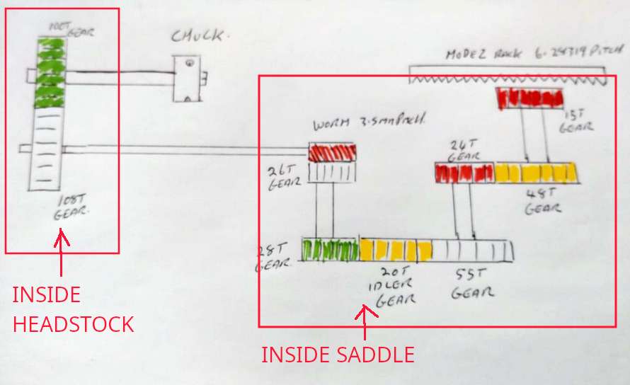

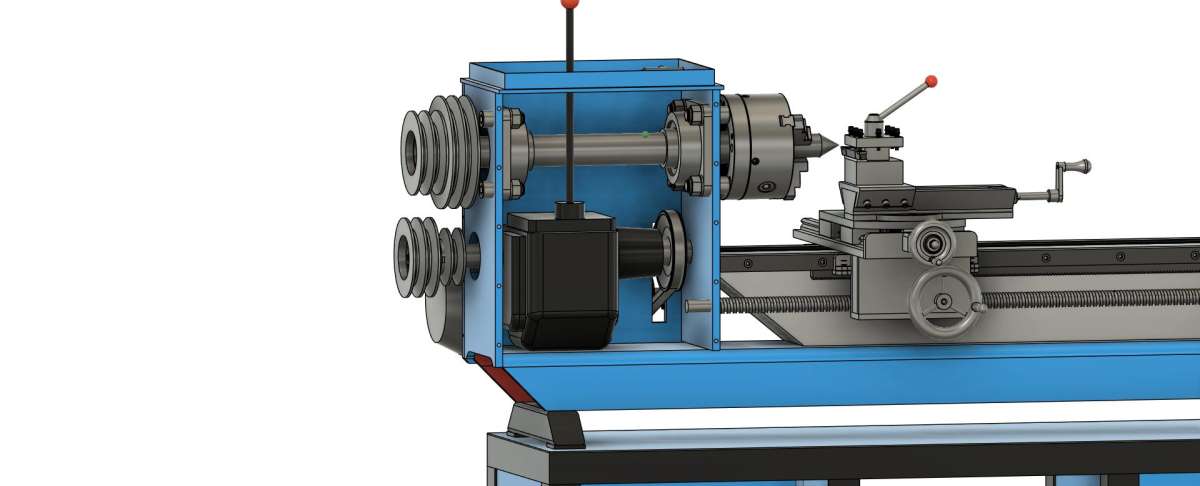

                                                    #797794

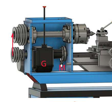

                                                      Are some earlier design decisions starting to cause trouble?
                                                      This CAD diagram shows the drive train.  It was stated there was no requirement for screw-cutting, now there is:
                                                      headstock
                                                      Pulley M, inside the headstock,  is belt driven from the motor through a slot, which might make fitting it a pain,
                                                      Then M drives gearbox G, which transfers power to the spindle via the external pulley pairs, red arrow.   This arrangement leaves little room for driving the leadscrew, which presumably explains the complicated geared saddle shown next.

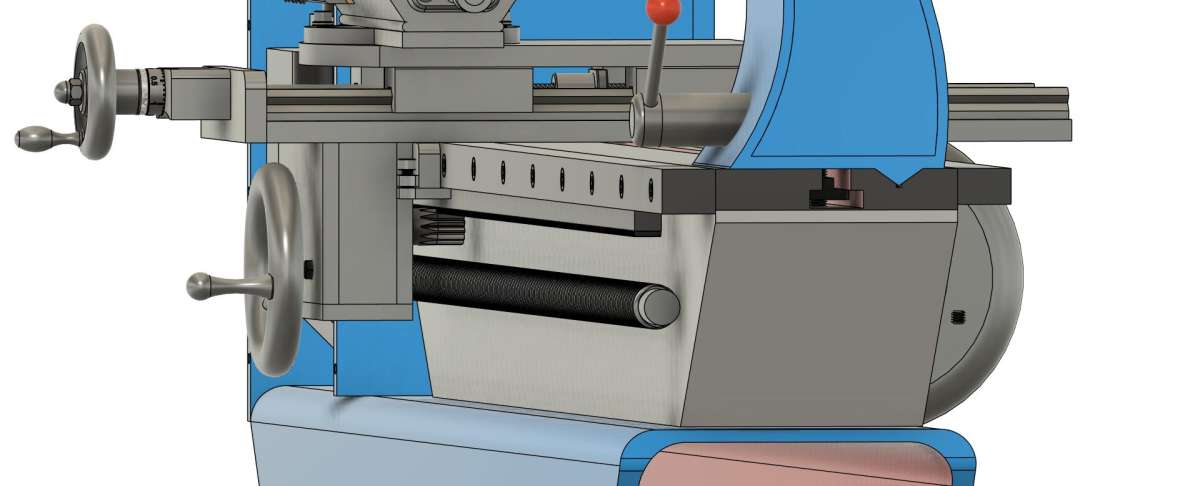

                                                      saddle
                                                      The gears are mounted inside the saddle, making them very difficult to change when other pitches are required. And they will be – a lathe that only cuts 1.0 pitch threads will soon get old.
                                                      In most lathe designs saddle is very simple, and the gearing is elswhere.  The saddle is either driven by a Norton gearbox or by change-gears mounted externally on the end of the headstock – where they are easy to get at.  The change gears also provide fine feeds, so they get moved a fair bit.  Should be as easy as possible, and this design makes it hard,
                                                      I think the easiest answer is an electronic leadscrew, where the stepper motor is at the tailstock end.
