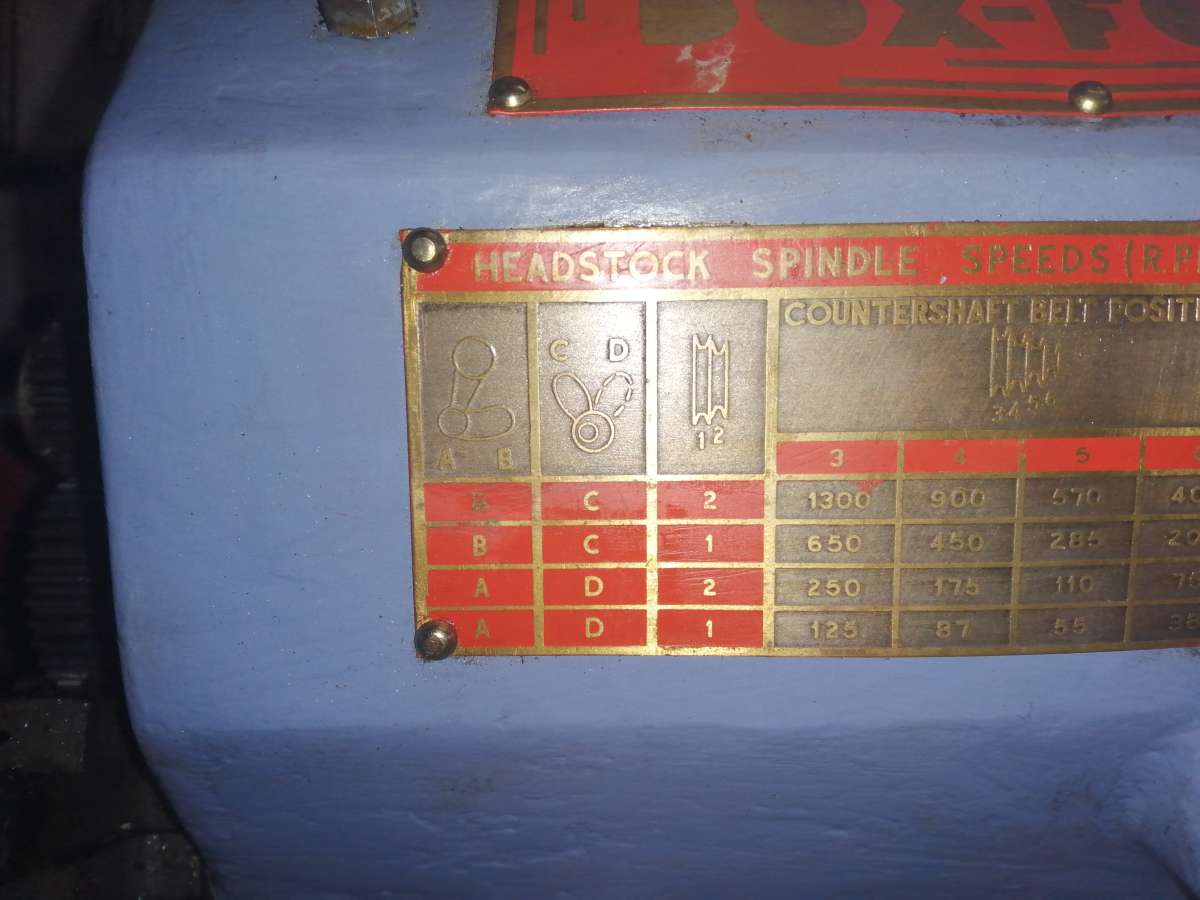

        I am no expert, but on my model A, in order to engage the back gear TWO separate levers need to be moved, what Boxford call the back gear to the rear left and the ‘sliding gear lever’ on the front of the headstock to the right.
        Which lever did you move . The controls also seem to have changed over the years and so more details might help with a more appropriate answer.
        Here is a photograph of the plate on my lathe. A/B is the sliding gear lever and C/D is the back gear lever

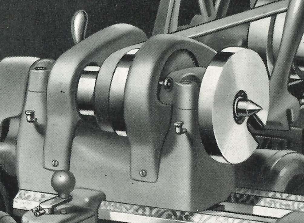

                I have a Southbend and I believe that the Boxford is a clone. When engaging backgear, you have to disengage a drive pin on the side of the gear as shown below. The spindle is then driven thru the gears and not directly from the pulleys.
                Lathe

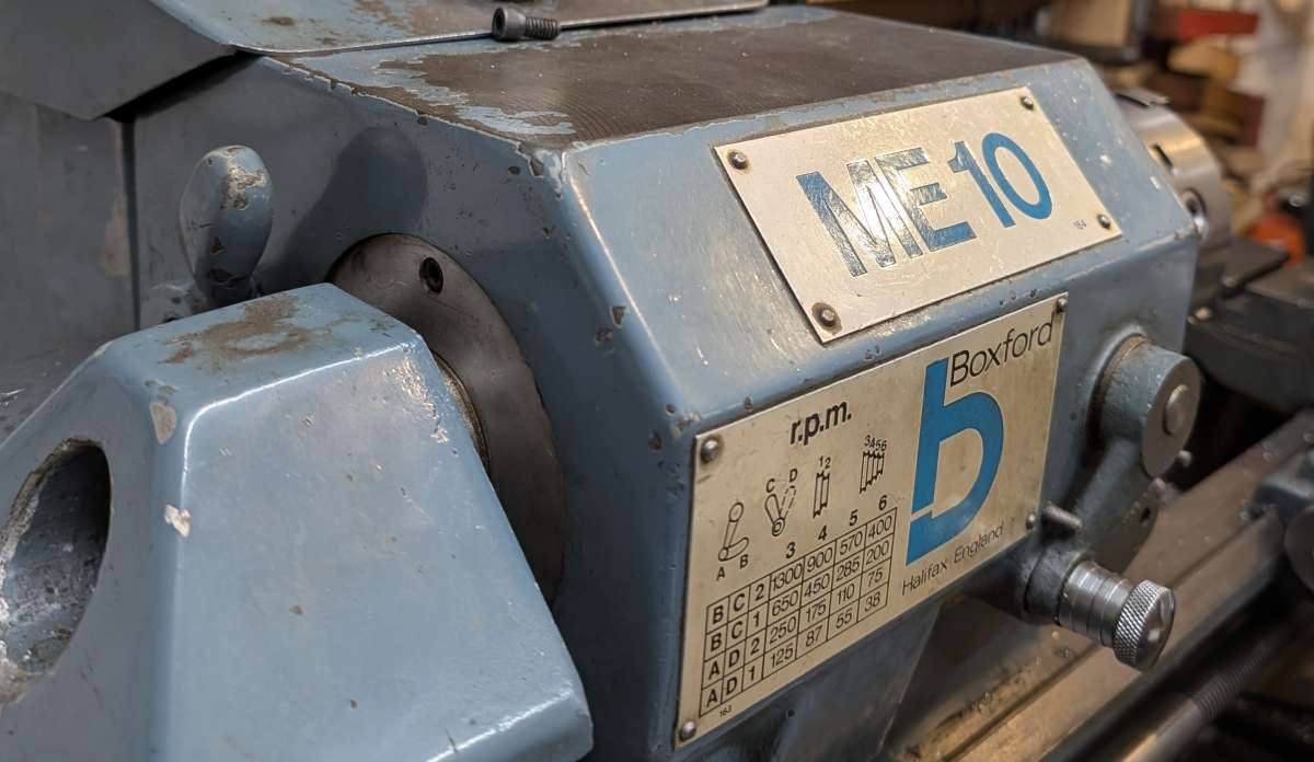

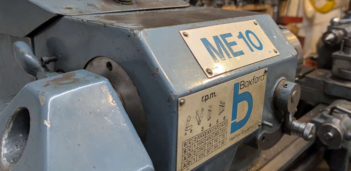

                  The Boxford isn’t quite the same:- Two pictures showing fast and slow back gear positions, the lever on the front may need the spindle to be jiggled to get it to engage.
                  FastSlow

                                  The lever on my lathe moves from C to D with a slight but distinct “over-centre” feel as the gears engage. Possibly the movement on the OP’s machine is slightly restricted, but I don’t know of any means for adjustment.
