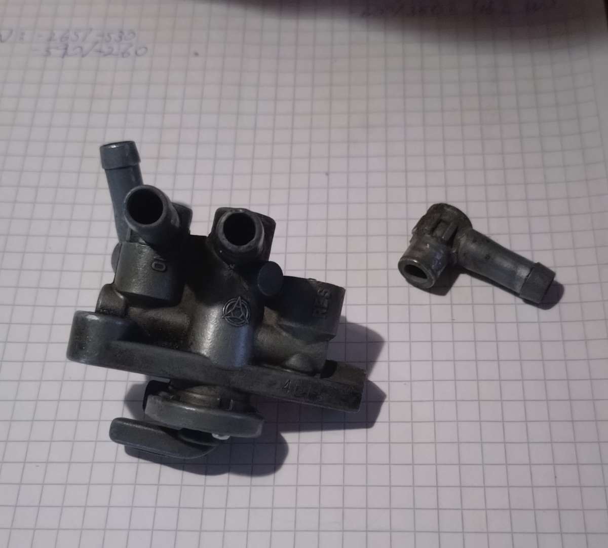

      My ol’ Suzuki has developed a leak in the fuel cock. The hose nipples are fixed to the main body with a cylindrical fitting that has become loose over time.  There isn’t any signs of sealants or gaskets so I’m assuming it was originally just press fit, but obviously that’s no longer good enough. The material seems to be zinc based, new or even used replacements are unobtanium, so I have to work with what I’ve got.
      I’m thinking epoxy but perhaps there are better products available for a reasonable cost?

            ANy chance of a photograph?
            My old Honda came with the new, non OEM fuel tap which might have been from a later model.   I assume the  original had started to leak. Is there a possibility of just changing the fuel cock for one from a later bike.

              There isn’t much room for anything except a bespoke part, and if there are other parts that will fit I have no idea how to find them.20250512_174544~220250512_174624~2

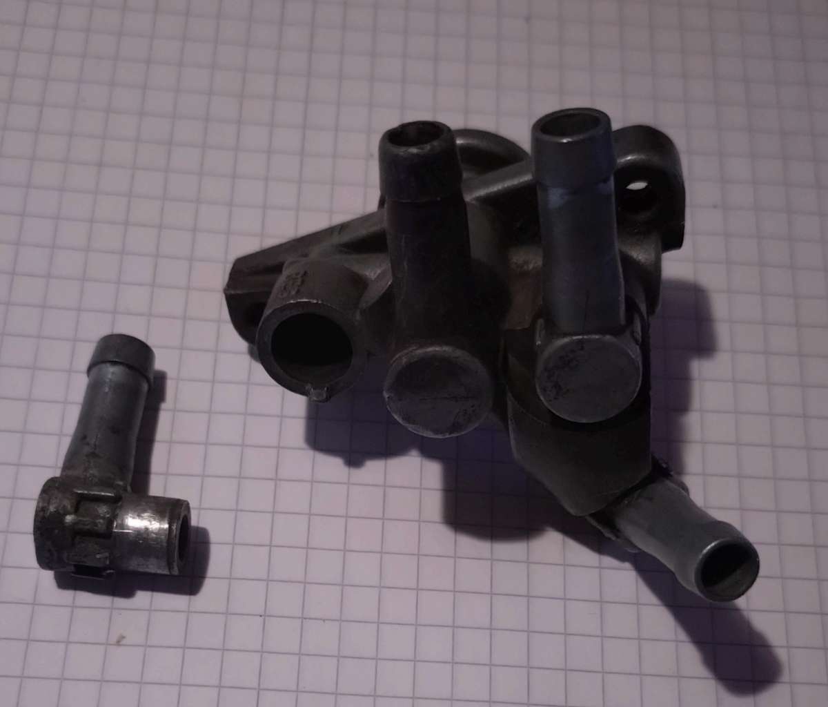

                Edit I was typing when photo posted. Definetely a job for loctite . 270 or 641

                    After seeing the data sheet for loctite it seems to be a very good fit (95% @ 5000h). As it is right now it’s more or less a tight slip fit, so there isn’t much space to fill. Not sure if epoxy will work well under those conditions.

                                          Presuming [as I think one reasonably might] that the failure-mode is as per the Weber carb. … the clearance between the components will be tiny !
                                          Loctite 638 or whatever, plus a pin or screw, seems the way to go.

                                              Anaerobic sealants work best with just a thou or two clearance, (0.025 0.05 mm), so if the connection is a slip fit onto the body, my inclination would be ensure that both fitting and bore are clean, apply Loctite, rotating to ensure complete coverage, and leave to cure for several hours.

                                                Re: cast in: Interesting idea bit I don’t think so. Both parts are pot metal and the bore has a tapered bottom that does not correspond to the end of the nipple. Besides the nipples are 90° so you can’t insert a pin to create the bore.
                                                I have considered a pin or grub screw, I’ll give it a go with the Loctite 577 first and see how it fares. Annoying to pay almost 30eur for 3 drops, but it’s still cheaper then a fire.

                                                  I really would not use 577 especially if you have to buy some in. Your 641 is just as good as the gap is small. We had trouble with 577 on even fairly coarse parallel threaded fittings. It’s good for tapered fittings.
                                                  Note that it is so thick that it comes in a concertina bottle because it does not flow.

                                                      @Robert: Too late, it’s already glued, reassembled and filled with gas. Checked the glue after 30 minutes and I could not move them by hand, I’ll let it stand with petrol for a few hours before calling it.
