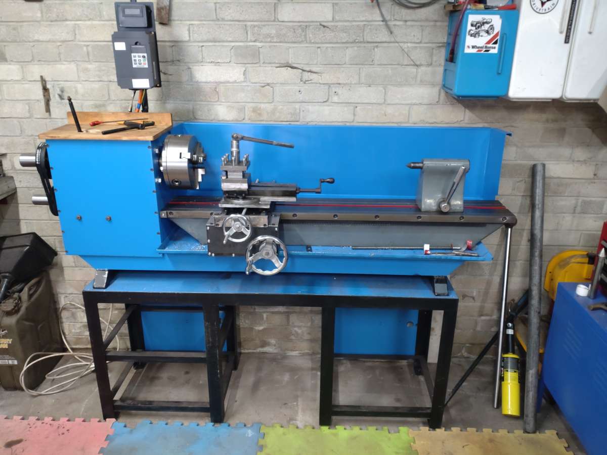

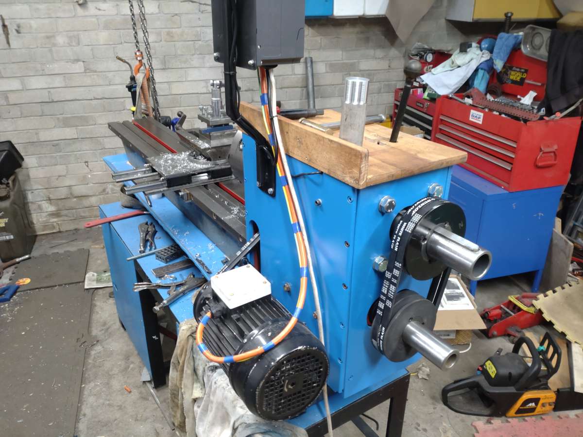

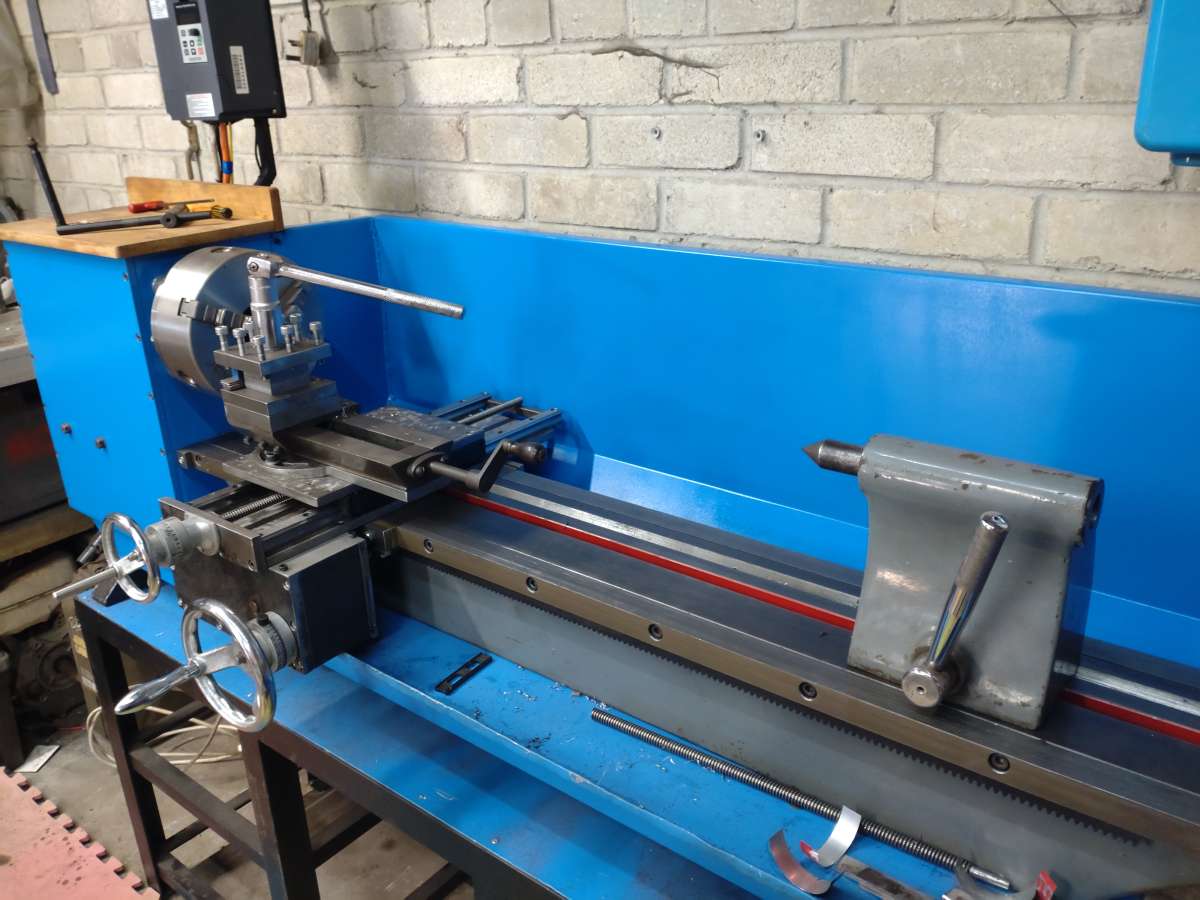

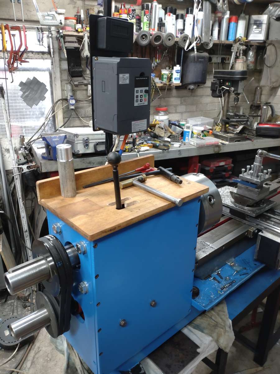

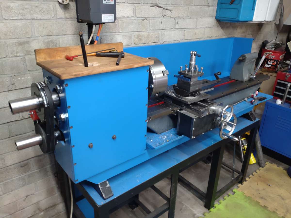

            Eventually got my lathe running and I’m very pleased with it. Less than 0.01mm runout at the chuck. Also got a splash back made. Next step is to continue with the quick change gearbox and power feed. ( ignore the temporary wiring)
            RPM via gears is 144 – 625. Using VFD to speed up and slow down motor, 14 – 1500.
            Short video showing runout.  https://youtu.be/42Oel4Glt60?si=DE4Mb5Fg6isP1a4U

              Very well done Moogie.
              #805405
                Woo hoo, gold medal for best home-made lathe!
                I see no lead-screw though, is there more to come?  Whatever, I’m impressed!
                #805419
                David Senior
                  @davidsenior29320
                  Looks like a perfect candidate for an ELS fitment.

                    Yes Dave, powered carriage in the works. 👍

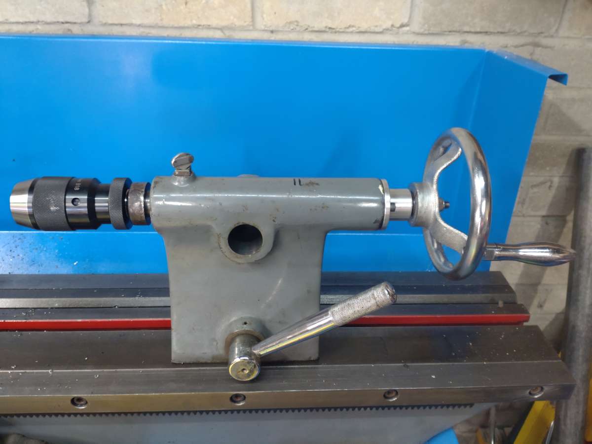

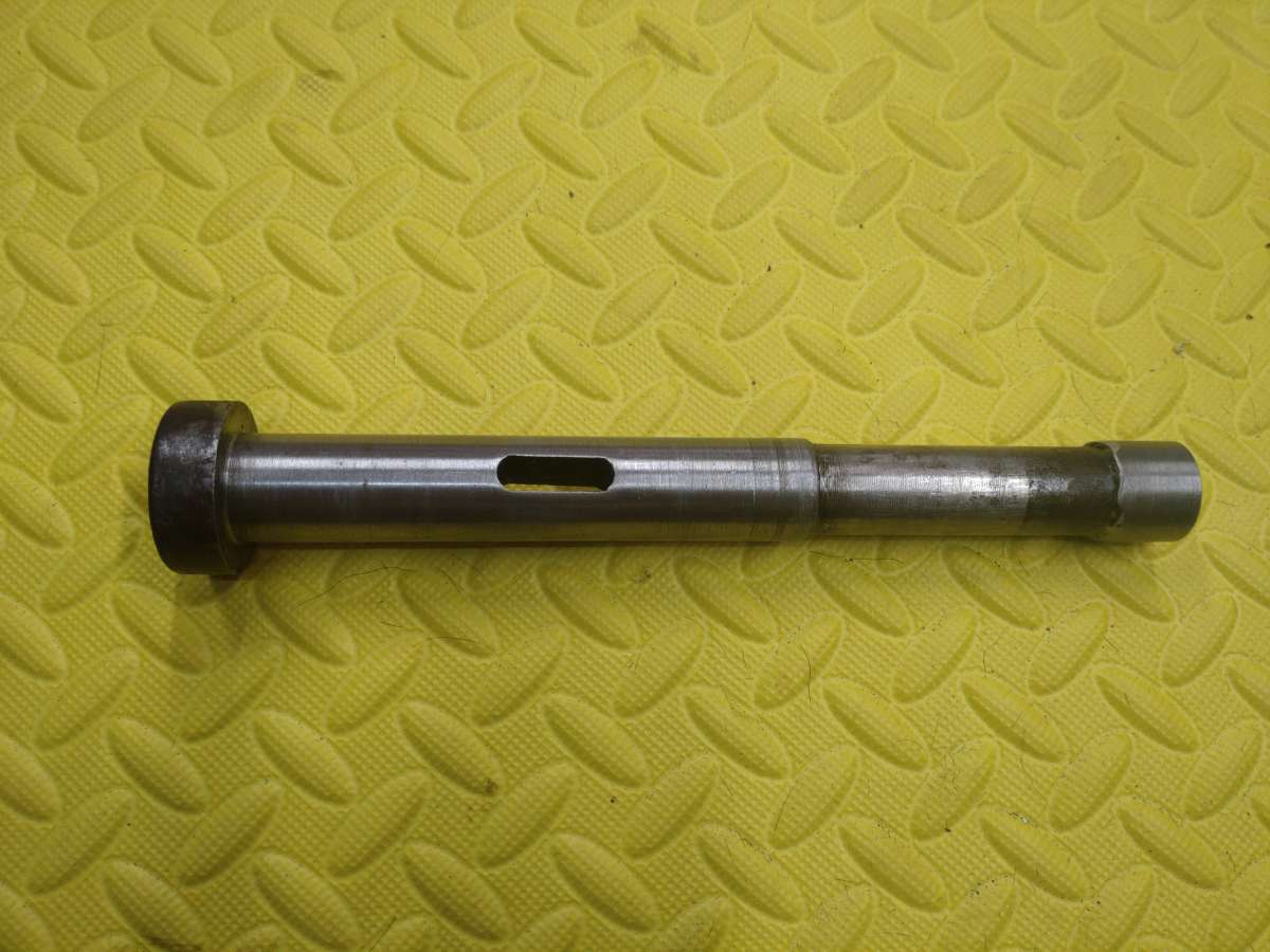

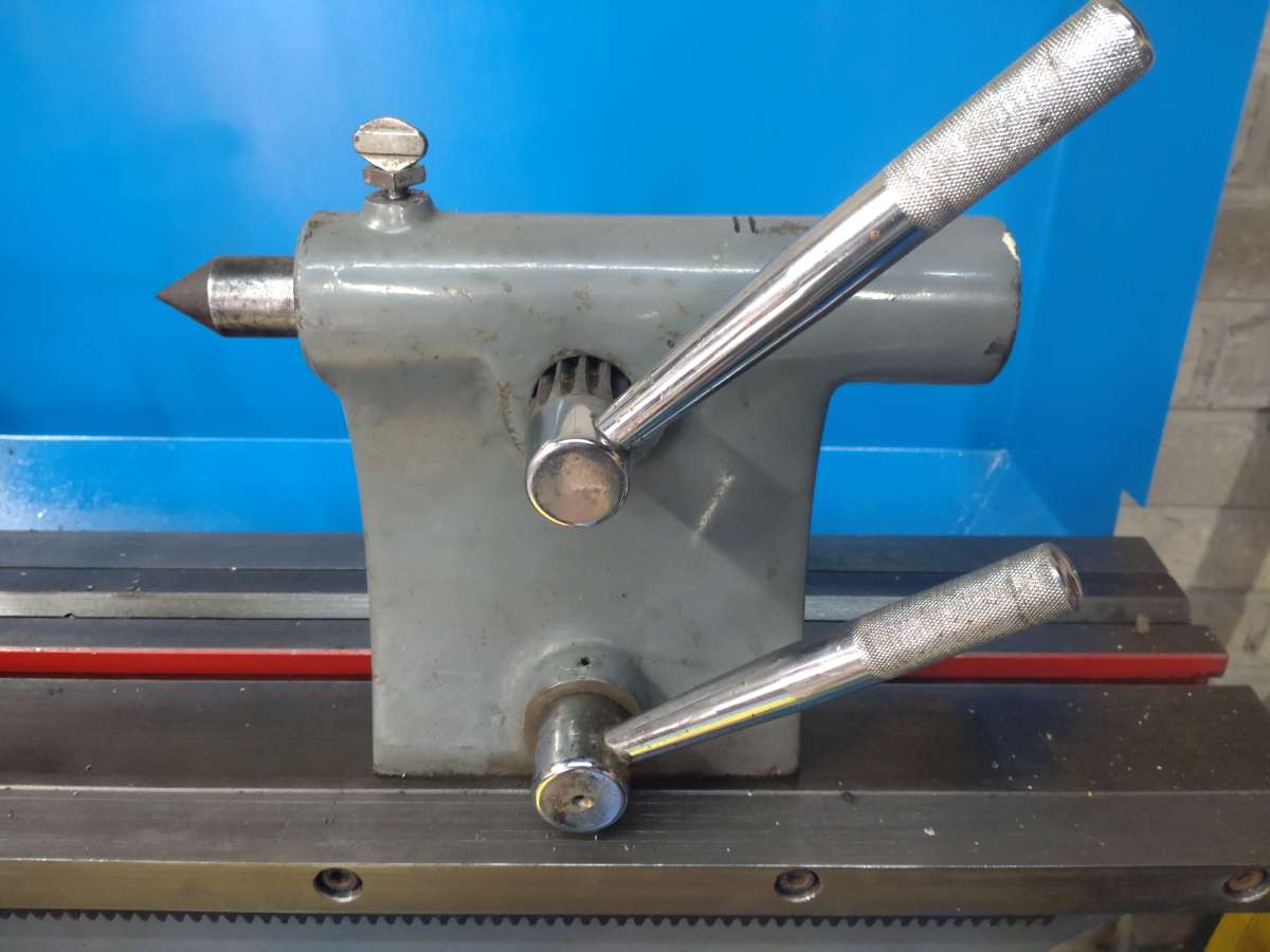

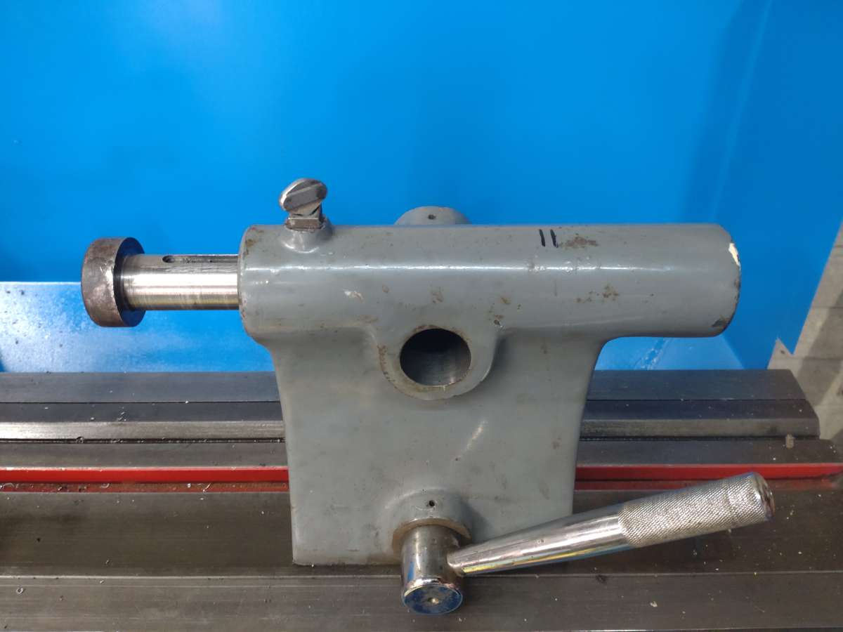

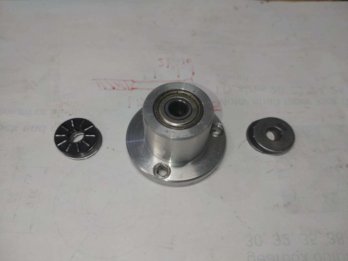

                    Eventually got the tailstock finished.
                    The bed i was given came with a tailstock of sorts. It had very little adjustment and only accepted a dead center.
                    DSC_2283

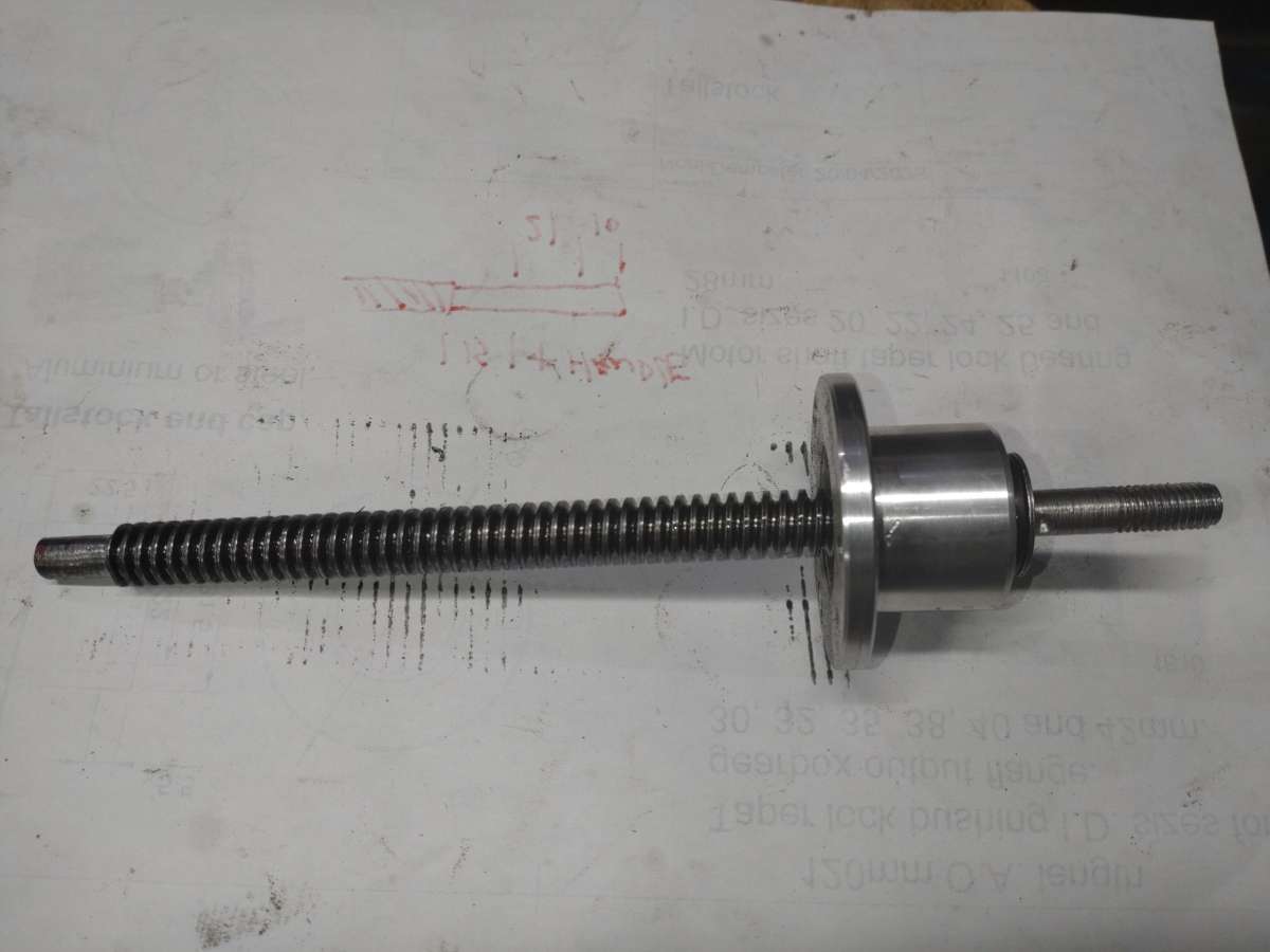

                    I picked up an old 2mt quill (would have liked something a bit bigger but it will have to do) and welded a lead screw nut to the end.
                    DSC_2279

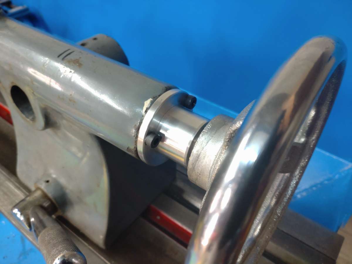

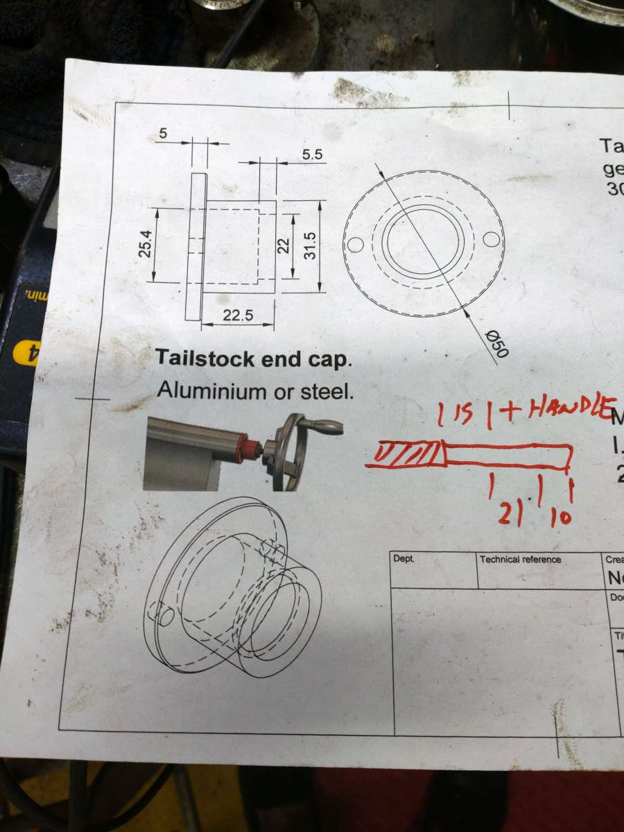

                    Next up i needed to make up a housing to hold the bearings and handle.
                    DSC_2278
                    DSC_2280

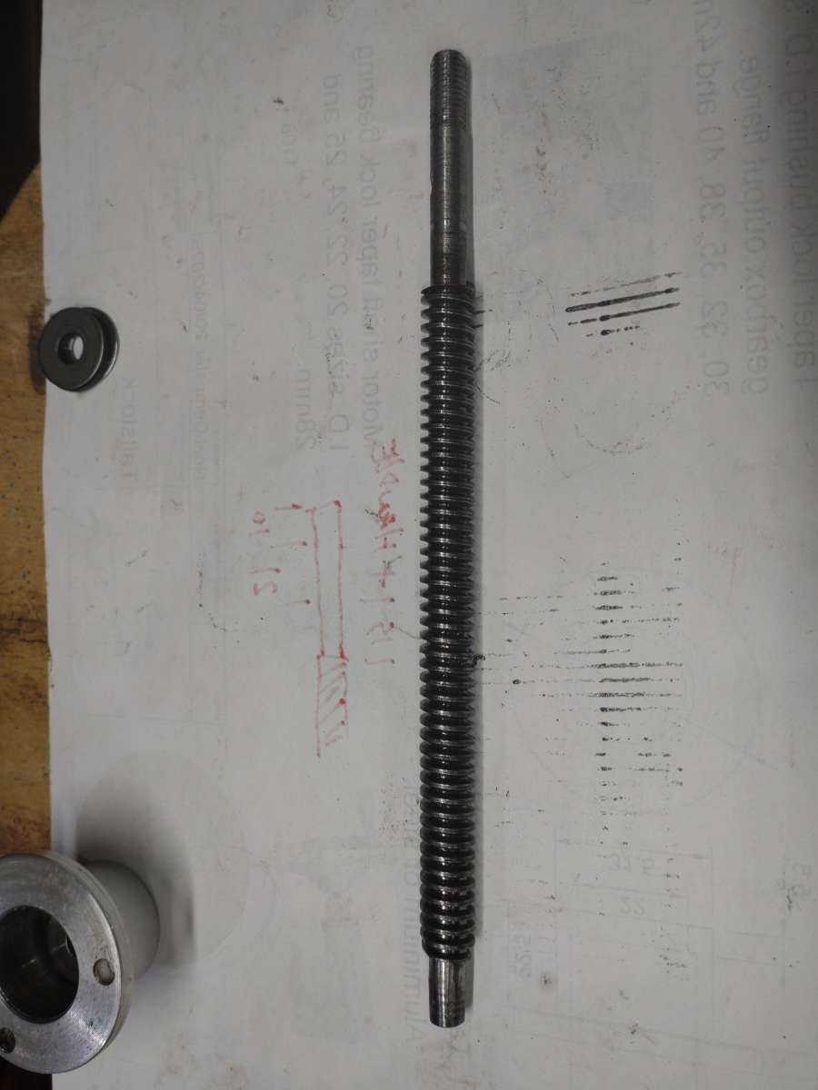

                    A bit of lead screws was machined down to make an ejection pin for arbour and to fit the bearings and hand wheel.
                    DSC_2281DSC_2282
                    This was attached with three cap head bolts.
                    DSC_2285
                    Got a keyway machined into the quill to stop it from rotating, secured with a thumbscrew.
                    DSC_2284
                    And that’s about it for now, more to come !
                    DSC_2286
