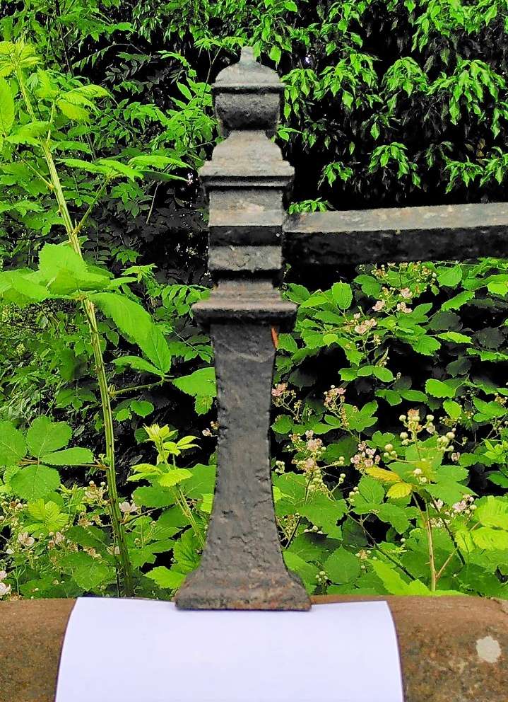

      I have been asked to help in replacing four church railing support columns. Does anyone have a recommendation of a foundry who could cast in cast iron or possibly aluminium from a 3D printed pattern (with suitable draft angles and shrinkage allowance)? Overall length including mounting spike is around 500mm. I am in Manchester, but could easily post the pattern(s).
      Andrew.

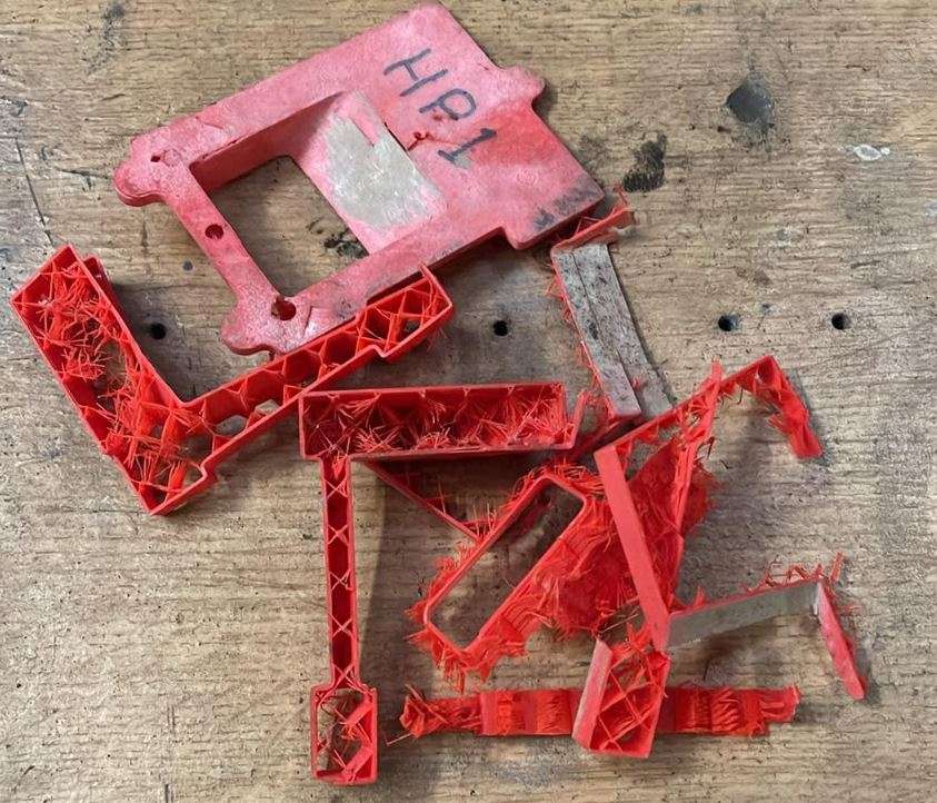

                The patterns I have been making and doing the CAD for over the last couple of years are being cast by these two both iron and aluminium
                Graydon or Purbrite.
                re the 3D patterns you will need to print them with a good wall thickness and at least 50% fill if they are to survive being used for more than one casting, failure to do so can result in this when the pattern is pulled from airset sand which is what most use these days.

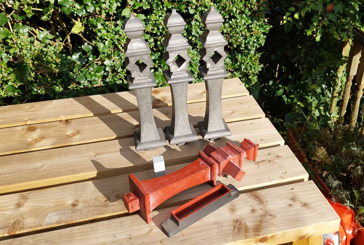

                          20240903_172205Finally picked up the cast iron railing supports from S Whitehead foundry in Altrincham. Perfect job and the 3D printed pattern and core box look like they would survive many more operations. The sand was sodium silicate for both the core and the main casting.

                            Looks like a good result, Andrew. The Whitehead foundry is very close to me.

                                Hi Bill, I was also surprised that the Church could and had chosen to put resources to a cosmetic issue rather than say to a food bank, but it turns out the railings belong to a War Memorial, which may affect funding source. Anyway the cost for casting the the three 7 kg 400 mm high pillars was only £120 including VAT.
                                              I would say that’s an absolute bargain. They look great, a credit to everyone involved
