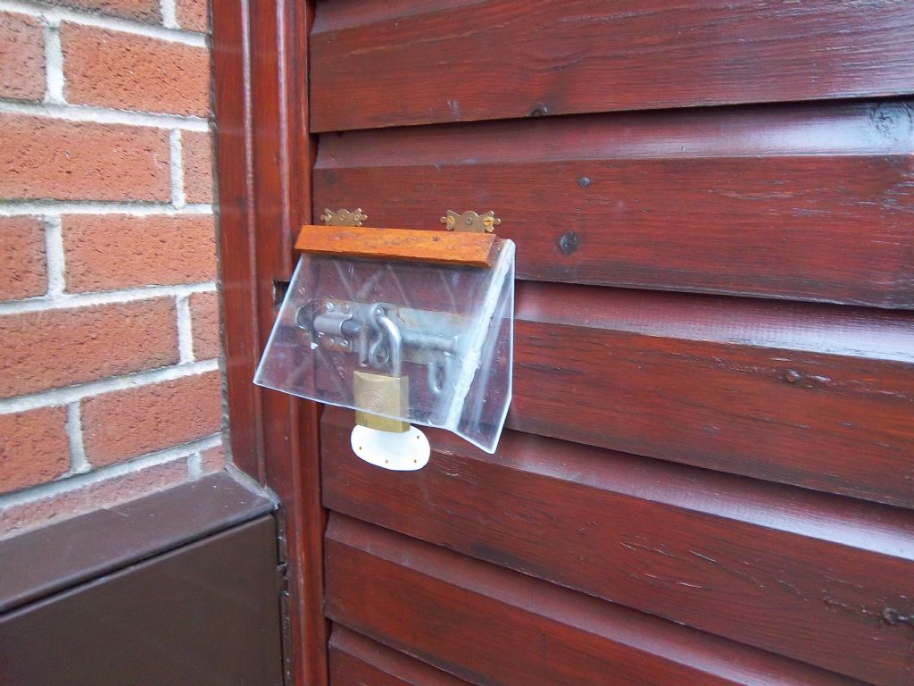

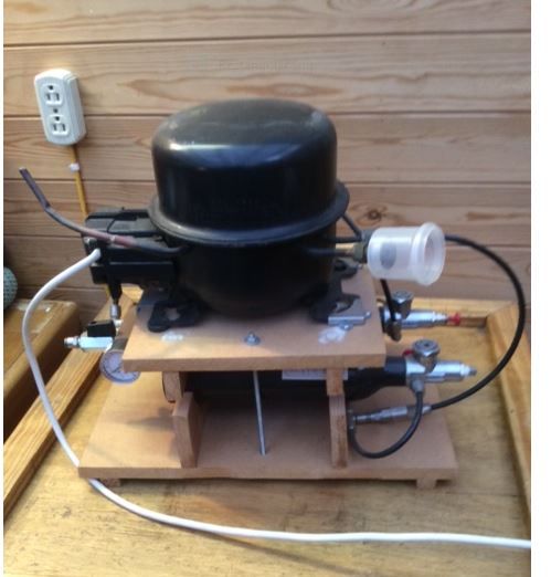

      meet 045.jpgTwo more photos of items/projects made along the way. One of the little compressor put together for powering my models and yes it was degassed at an approved site. Most of the connections are "push in fittings" to allow me to reconfigure easily. I really need a desiccant dryer for use with the air brush. The weather shield over the lock was fitted to save the fumble with a cold wet lock. Not a good start with a session in the shop. I used polycarbonate which had the added benefit of seeing whether it was locked.shop air 2.jpg

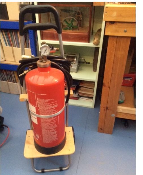

          air receiver rev.jpgAttached to my last posting was a picture of my compressor albeit on its side. Hopefully new shot will show it right side up. The posting should have also included a photo of the air receiver put together at the same time. Quite portable so has been invaluable for group meetings where power was not available to run a compressor. Sitting on the shelf behind the receiver is a beam engine (sure the eagle eyed will have already seen it) and I will post some photos of this soon.air comp rev.jpg

            I like the lock cover could have done with something like that for the first time of having a workshop one of my padlocks was frozen to the point that I could not get the key in
