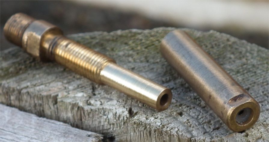

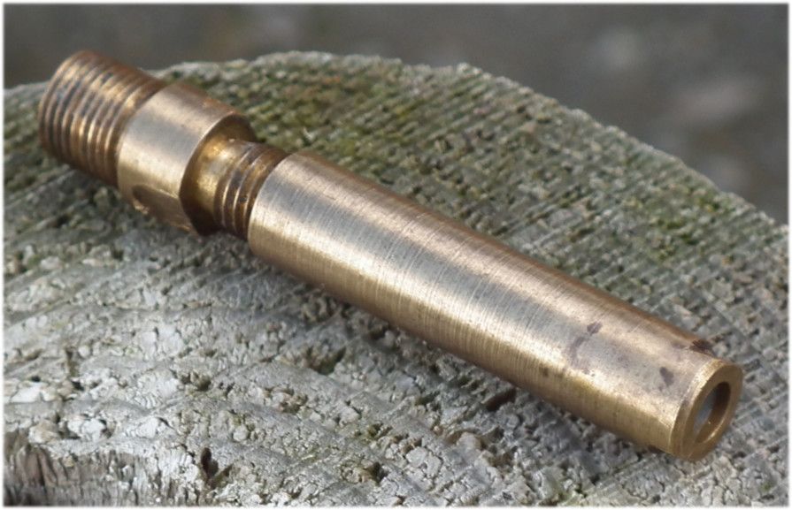

                    Bob Unitt 1
                      @bobunitt1
                      I made this adapter years ago, the plain part has a nylon ring at the end to seal to the nipple. The thread at the other end fits an old Wanner grease-gun.grease1.jpggrease.jpg.
