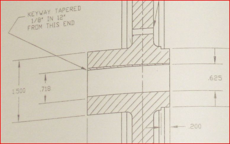

      Engineering reference books give the taper for flywheel keys as 1 in 12. However, no mention is made of making the keyway, in the hub of the wheel, match this taper. Every model that I have seen described has the keyway parallel. However, I have two books with sectional drawings of the levers on Corliss valve spindles. They are keyed to the spindles, and the keyway in the levers is plainly shown as matching the taper of the key. If this was done on these levers, then why not on flywheels? I have seen setscrews fitted to hold keys in small wheels.There would be less chance of the keys coming out if they were driven into a matching taper. Are the keyways in full size practice ever cut to match the key?

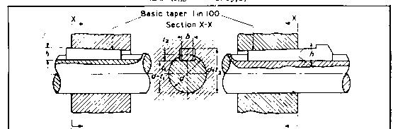

            From my reference books in the real world (ie not model) the keyways in both shaft and hub are parallel as well. The taper on the keys is given as 1 in 100 though not 1 in 12. The old "UK" standard taper was 1 in 96.
            I think your 1 in 12 figure is the taper on the end of the shaft, the reference says that the keyway in such a shaft is "parallel to the side of the cone" and as the "depth of the keyway at the sides therefore alters with the change of section. For determining the correct size of key, the nominal section of the shaft is taken to be that at the larger end of the cone". (Kempe's Engineers Year Book, 1965)

              Machinery's handbook shows a tapered keyway in the hub.
              Easily done by slotting at an angle or using a standard keyway broach by making a guide bush that has a tapered slot.
              There is a lot of force on a flywheel key and if only secured by wedging against the corner of a straight keyway in the hub it may come loose. My Ruston TE has 2 x tapered keys at 90 degrees to each other. Also adding a cap on the end of the crankshaft to retain the flywheel in case the keys come loose.

                The 1 in 12 is actually 1/8" in 12" = 1:96 these are imperial key tapers, metric use 1:100
                Funny you should asj but I have just machined two flywheels and a pully that will need tapered keyways to suit the supplied tapered gibb head keys. I will just make a bush with a 1:96 tapered slot to guide the broach as I have done in the past
                If you need to make the tapered keys then an easy way to set the taper is like this, just space the packer the correct distance along the rule. For a 1:96 taper I would place a 1/16" packer 6" from the unpacked support. The rule acts as aparallel to support your key blank. Some may say poor mans sine table but what else will fit when machining a narrow key

                  You are correct about the taper ratio. My Machinery's Handbook is the metric version.
                  Instead of raising one end of the bush with the 1/16" packer over a measured distance (sine gauge method) you can use the tapered key as an angle gauge. You do not have to measure anything. It is already at the exact angle that you are trying to achieve.

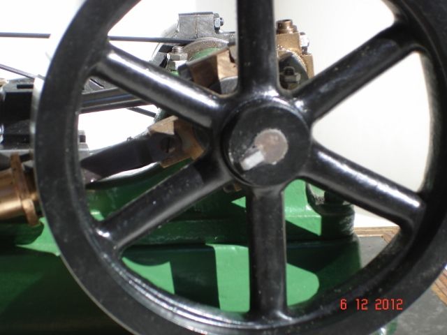

                                        Not a good photo of the key, but this is the one I made to fit the flywheel on a Stuart Turner S9 that I rebuilt.

                                          No disrespect intended & maybe my view of the pic; but it looks like the key is upside down in the keyway, with the gib facing the shaft..?
                                          I have always fitted gib keys with the taper of the key matching the taper in the flywheel, with the flat bottom of the key fitted into the parallel keyway on shaft.. if it's my eyes then I stand suitably admonished.. may be a pic from an oblique angle to show the key better would clarify, as I see it now it immediately hits me as something wrong?
                                          Respect..thumbs up
                                          George.

                                            George, no it's round the right way, just the angle of the photo. Thought I had a better one than that. The motor is in a local museum now(it was the museum owner that got me to do the rebuild).
                                            Ian S C

                                              Thanks, it confirms that my eyes plus the angle of the pic are what confused me; I guessed that a man of your calibre would have it orientated correctly.
