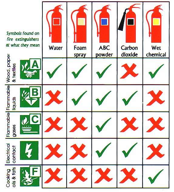

                      This chart summarises what types of fire the main types of extinguisher are good and bad at:
                      FIRE-EXTINGUISHERS-chart
                      Confirms that the best all-rounder for a metal workshop is the powder type, though I vote for CO₂ in the optimistic hope it will put the fire out without leaving an enormous mess!   Another disadvantage of CO₂ is that, handled incorrectly, they frost-bite the user.  Always read the instructions.
