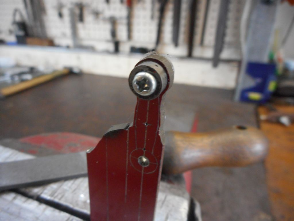

                            Hopper
                              @hopper
                              Posted by martin perman on 12/07/2022 08:08:13:
                              Gentlemen,
                              Never come across filing buttons before could somebody please tell me what they are and how to use them.
                              Martin P
                              If you want to file a radius on something, such as a half-round end on a piece of flat bar, or the round small end on a model engine connecting rod, you turn up two pieces of silver steel of the correct diameter with a hole in the middle and harden them. Then put them either side of the work with a screw going through the filing buttons and the work and tighten up. You then take a file and file the job down undil the file just hits the hardened disc. Result, a perfect rounded end or radius.

                                          #605463
                                          Hopper
                                            @hopper
                                            Posted by martin perman on 12/07/2022 09:46:40:
                                            Hopper, thank you for your description of filing buttons.
                                            Larry, I'm sad to say that I've never heard or seen them even during my engineering apprenticeship they never popped up, I dont do model engineering, my grandfather did, but I restore old engines and have my own workshop and have always filed radiuses using radius gauges and following scribed lines.
                                            Martin P
                                            Hardened filing buttons set up ready to use. No files were noticeably harmed in the making of this part. File was stroked from the right to left of this photo, rocked so it followed the shape of the desired curve and so the file contacted the curved surface of the hard button when down to size, not dragged acrross that sharp edge at the front in this view.
