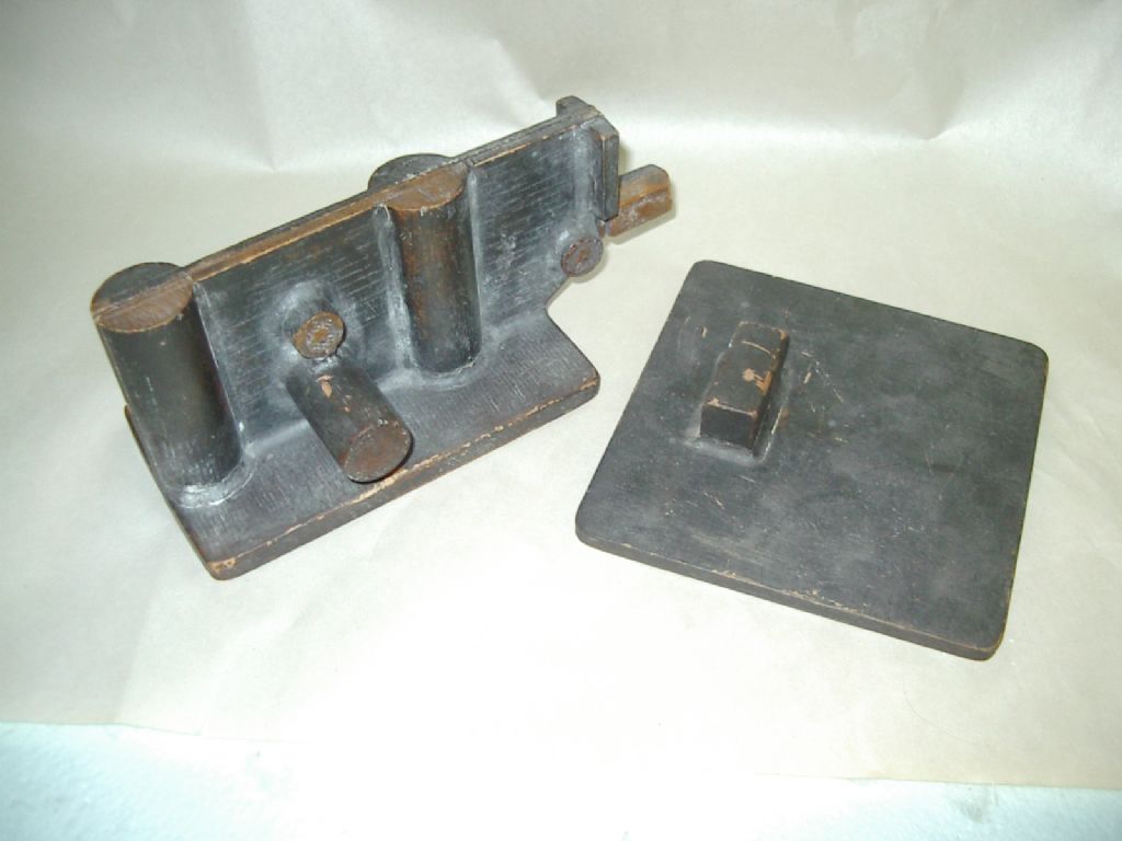

                            #46191
                            Charles
                              @charles
                              The die filer on the cover OF MEW 155 was made by me.  It was made from a set of castings in aluminium which is the preferred material as one has been made locally in cast iron and the extra reciprocating weight had it leaping about like a kangaroo.  If anyone wants I can supply a crude sketch showing the essential dimensions and photos of the patterns used.

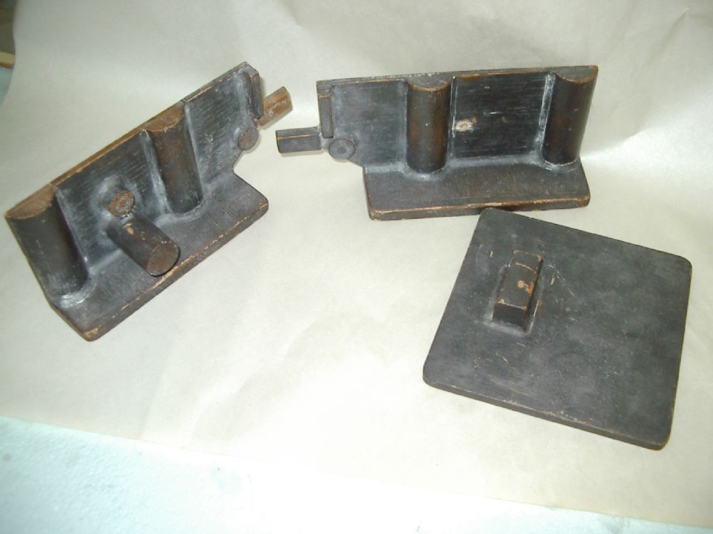

                                    #55684
                                    Howard Jones
                                      @howardjones35282
                                      axel
                                      this is the sketch charlie was referring to.
                                      I’ll visit him tomorrow and we’ll post some photos of the two moulding patterns.
                                      basically if you sit the two arms down on top of the body you have the casting shape of the main body. these arms are sawn off the casting and then machined.
                                      the other casting is for the table.
                                      they are a copy of a swiss filing machine in the early 1900’s.
                                      Howard

                                          #55712
                                          Charles
                                            @charles
                                            Here are photos of the pattern
                                            Here is the pattern split apart
