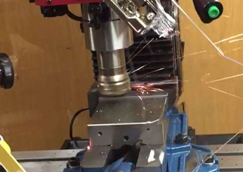

                                  I seem to recall that Ketan has had the shell mills upto 5000rpm cutting stainless on the 3.5 machine, he may be doing it again in a few days when it’s Fireworks night.
                                  I’ve had a 50mm one at 5000rpm on the CNC but not cutting steel
                                  sparks
                                  #685489
                                  Andy Stopford
                                    @andystopford50521
                                    5000rpm sounds pretty plausible, the Warco goes up to 3000 and that worked fine, but I’d need to rig up some swarf shields to avoid playing too personal a role in the firework display.
                                    edit: What’s it cutting in the photo?
                                    #685498
                                      That is Ketan from ARC cutting some non free machining stainless steel. I’ve found the video now, will upload it in the morning.

                                          Ketan Swali
                                            @ketanswali79440
                                            As Jason YT link says: ‘Don’t try this at home’
                                            The video was taken back in 2018 when I was testing the limitations of the SX3.5. It was one of many tests conducted with shell mills on the SX3.5 at the time. If one was to use it at high speeds, appropriate guarding should be considered, as the the swaft/bits which come flying towards you are hot and if they imbed into any exposed skin, you will remember it. For the purpose of the tests, machine fitted with a power feed was used.
                                            The shell mills with inserts are designed to be run at high speeds.. usually for CNC applications which run at much higher speeds.. This is a positive attribute, especially for finishing cuts.
                                            When used with a BRUSHLESS motor SIEG SX2.7 or similar range, one has to consider rigidity of the machine, along with delivery of toque.
                                            The SX2.7 is a hobby machine with lighter weight casting than an industrial or CNC machine. If you try to run it too hard with a shell mill – higher dept of cut + low speed : greater diameter of cut, there will be greater vibration/stall event, followed by everything becoming loose/slack…. especially the table/head which could need re-adjusting of the gibs.
                                            The toque on the SIEG range of BRUSHLESS motor machines is delivered by the programming on the control board. The programming on the control board is based on the maximum speed the machine is expected to deliver. The SX2.7 has a 750w output brushless motor with maximum speed of 2000rpm. The torque delivered at higher speeds will be greater than that at low speed.
                                            So, based on the experience I have hand with these machines, it is better to run them at high speeds with low dept of cut when running full diameter … at a particular comfortable feed rate… based on the material being cut. Similarly adjusting the feed rate (reduce) for half or quarter diameter of shell mill being used for increased DOC.
                                            Feed rate: to get a consistent feed rate, as well as to protect one self from flying swarf (even after shielding), I found it useful to use a power feed. This helped me to get the right combination for consistency and finish, for the material being cut.
                                            I have spoken with Jason about this, and I understand that he will be putting up some photos/videos of his SX2.7 performing the above tests, in the coming weeks.
                                            Ketan at ARC.

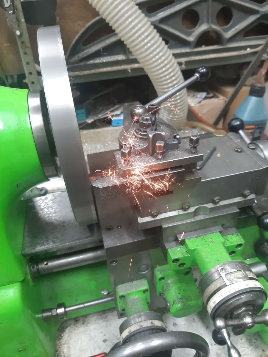

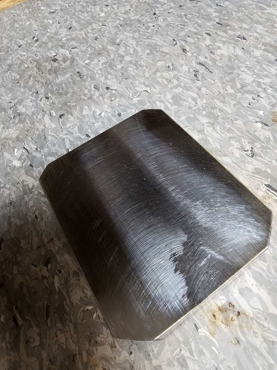

                                                On the lines of ‘don’t try this at home’ (why not, I did 🙂 ) :-
                                                Skimming a 10″ dia cast iron lapping plate with a diamond insert
                                                20200616_123835

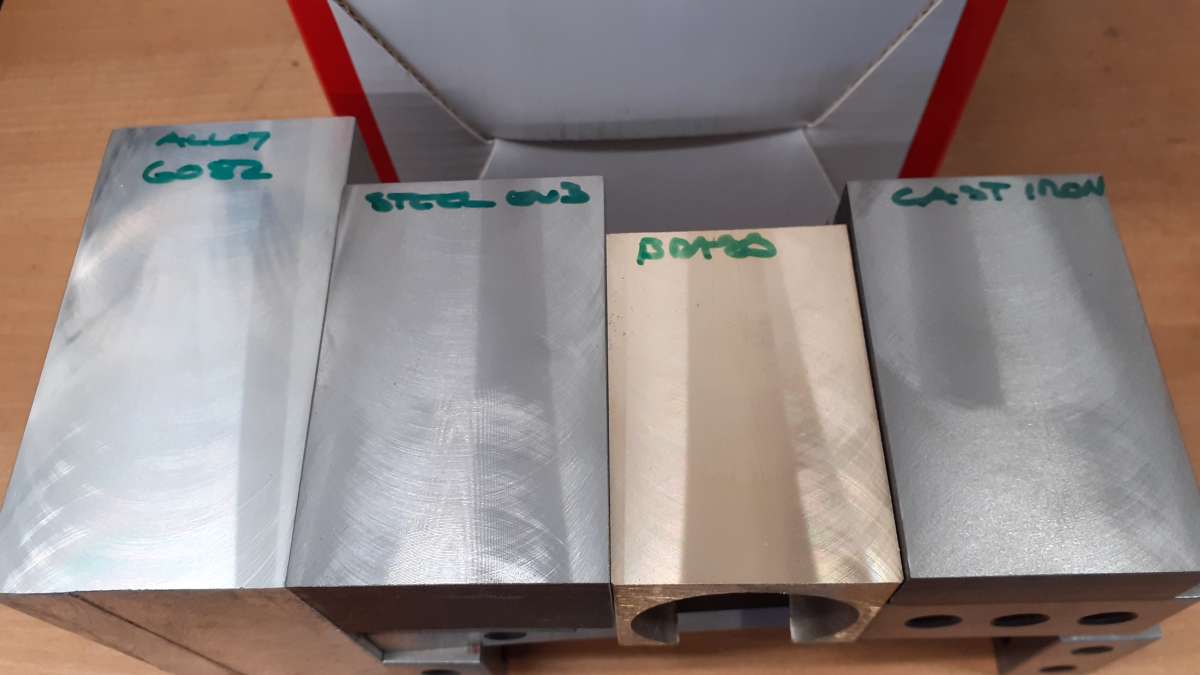

                                                  With the arrival of a power feed for the SX2.7 from the nice people at ARC I was able to up the feed rate a bit more.
                                                  Still some testing to do and I’ll write it up more fully in a few days but the swarf has been flying. Suggest you watch it on YouTube at full screen size then you can see my fingerprints reflected on the finished surface.
                                                  Sieg SX2.7 Mill
                                                  ARC 50mm 5T Shell Mill with APMT Inserts
                                                  2000rpm = 314m/min cutting speed
                                                  450mm/min Feed Rate = 0.045mm Chip Load
                                                  48mm wide x 0.5mm deep cut
                                                  EN3 Steel.
                                                  #688165

                                                    The feed rate looked a little fast. It looked as if you were working on a hobby CNC machine.
                                                    Hopefully this visual demonstration helps answer the OPs question better, using the coated inserts he has, for the ferrous material.
                                                    Ketan at ARC
