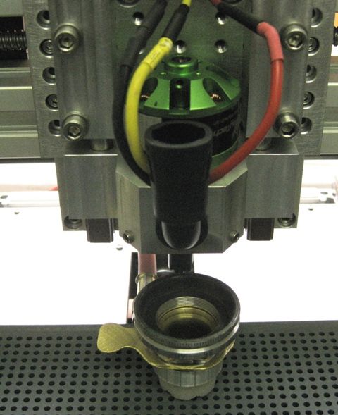

                          As said, rather use a D engraving bit. I have great success with them. I built this CNC engraver specifically for PCB Isolation routing. The spindle motor is an RC Outrunner, turning at about 30.000rpm.
                          The cutter penetrates about 40 to 45um( the copper is around 35um on my FR4 PCB).
                          The trick with these engraving cutters is that the PCB has to be flat, and co-planar, else the tapered cutter cuts different widths as it penetrates the copper more or less. I gave up on trying to engrave with PCB just mounted 'flat' on the table – it was never flat or co-planar. Some cad packages can do auto-leveling, and you may have success that way. I made a floating head for my machine – floating on a teflon foot, with vacuum cleaning away the cuttings inside the foot, to ensure it always rides on the copper.
                          I also tried a vacuum table, but the PCB still is never flat enough – 20um makes a huge difference, and 20um is very small…
                          The PCB in the photo below has a pad spacing of 0.5mm. Tracks are 0.3mm wide, with 0.1mm isolation cut away.
                          The engraved finish is very good – no burrs, with some cleanup required of fine slivers sometimes left isolated between tracks.
                          EDIT:
                          Forgot to add – feed is straight down into the material ( only 45um into copper..) @ 400mm/min and cutting @ 600mm/min in X and Y. I can achieve those speeds as the machine is small, and VERY rigid. You would probably have to go down to around 40 to 80mm/min with a spindle speed around 6000rpm…
                          Cutter geometry is VERY critical. The cutting edge and cutter relief makes the difference between a terrible burred edge, and a clean smooth cut. Cutter relief at the very tip of a 10degree engraving cutter is not a trivial exercise to achieve, so get quality cutters if you can. I bought many 10's of cutters from banggood – 10 in a pack, and typically get 3 to 5 in a psck that work well – the rest vary from useless to 'good enough' for rough boards. Then I grind them again on my small T&C grinder, and after 2 or three grind attempts, I have another good set..
                          I use cutters with included angles from 10deg up to 45deg – they all do the job. For very fine tracks and pad spacing you would need the 10deg cutters. I have done down to 0.25mm pad spacing, with tracks of 0.12mm width..
                          Joe
                          Floating head lowered
                          And Raised a few mm
                          PCB Being Engraved
                          Small IC placed on engraved PCB
                          Edited By Joseph Noci 1 on 30/05/2019 23:42:06

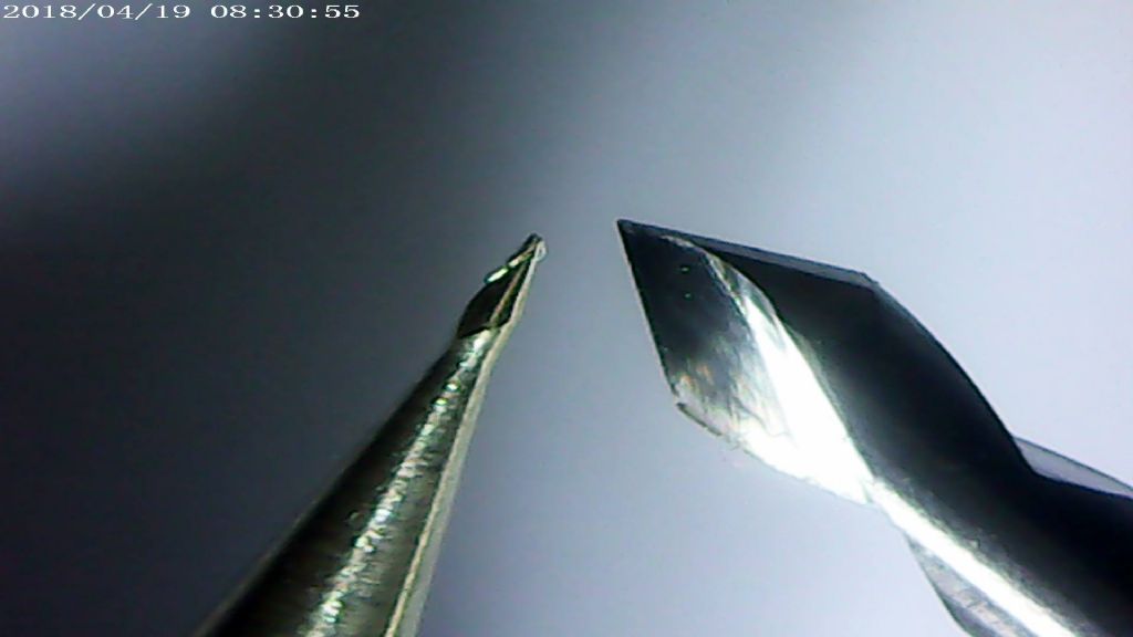

                                  Attached image are two examples of the Think & Tinker bits.
                                  Left hand one is their 15 degree 2 flute tapered stub ZrN coated and right hand one is 60 degree mechanical etching bit.
                                  Both have 5 thou tips.
                                  Sorry about the image but was struggling at this magnification.
                                  I prefer the left hand one as the taper is so slight that it eliminates width of track variations on my vacuum table.
