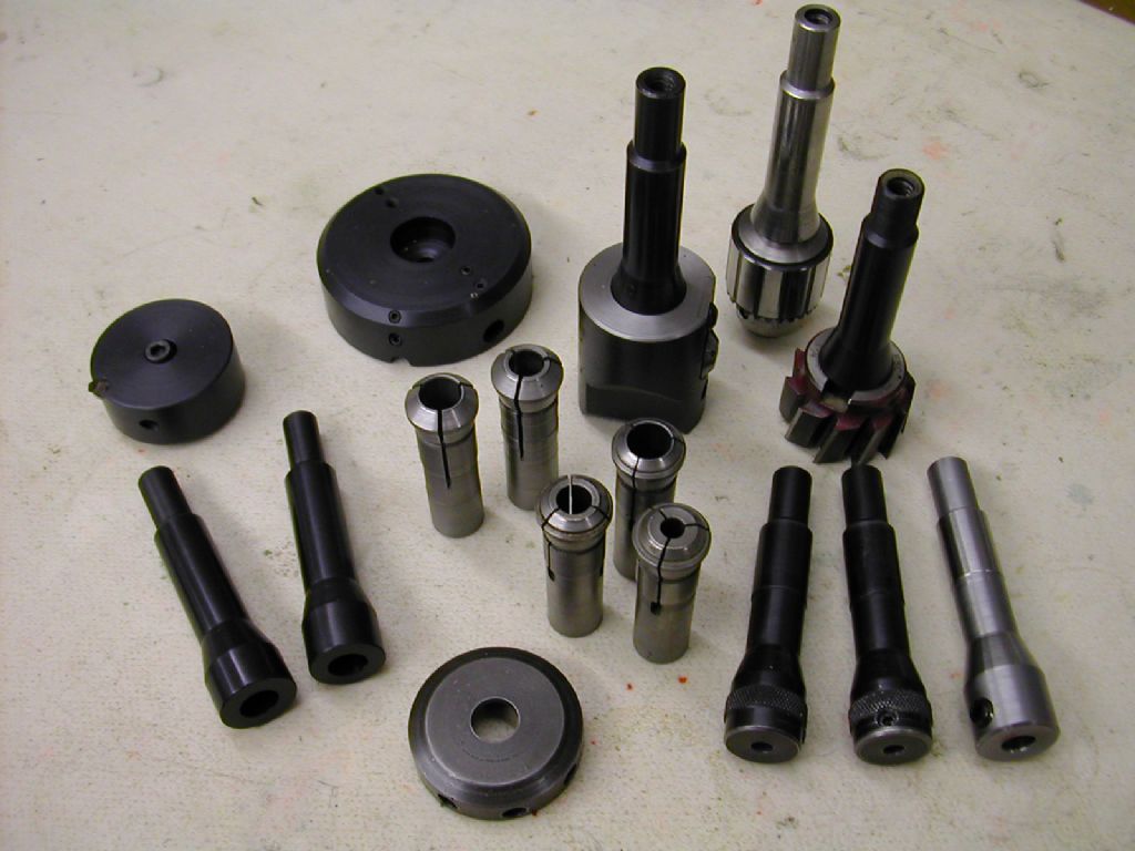

              #500395
              Ramon Wilson
                @ramonwilson3
                Hi Mike, yes thats just what I was thinking of yes
                I have just had a look on google – can't find an image of one anywhere but heres a picture of mine that may give Ian an idea
                The two tool holders are bottom right beside the un-blacked 10mm dia version. All this tooling is 'soft' but made from tool steel – similar grade to silver steel, The five collets are from silver steel. I remeber my foreman at the time telling me they would be no good if they weren't hardened – well – they are still in use today
                My old Linley mill has a spindle that takes Schaublin collets – basically a half size R8 – no tooling or collets were available when I bought the mill hence the need to make some. This is all well over 35years old, the collets even more so so has stood the test of time
                Obviously the drill chuck, cutter and boring head are bought in
                Hope that helps Ian a bit more

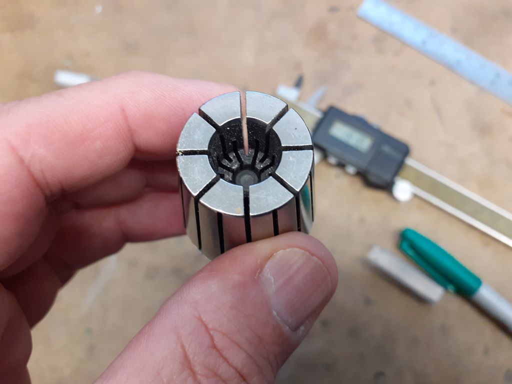

                  peak4
                    @peak4
                    I see other folk have been posting whilst I've been playing with a camera.
                    I also have the one Clarkson adaptor, shown here in my album of Milling cutter chucks to give a feeling for size.
                    I do sometimes use it in an ER25 chuck as it's less bulky than either my Clarkson or Tiitanic milling chucks, so sometimes allows easier access to the work in hand.
                    Amongst my other bits and bobs, I have a Quorn grinder, so I made an arbor for that, but rather than taking a wheel directly, it duplicates the collet chuck on one of my die grinders.
                    This allows me to use mounted points in the Quorn, the two collets being ¼" and 6mm.
                    I've not used it for much yet, but the idea was that I could use the Quorn head on the lathe as a toolpost grinder, with mounted points for internal work.
                    There's no reason why something similar couldn't be constructed with a parallel shank along the lines of the top one in the image, but shorter and slimmer.
                    I made the long one at the same time whilst I was set up for the smaller arbor, so I could use it for holding FC3 cutters for re-sharpening in the Quorn on a conventional wheel. My ER collet chuck is a 25, so the whole assembly is quite chunky for small grinding jobs, hence adding this one.
                    The official Clarkson 6mm one is shown lower right for scale.

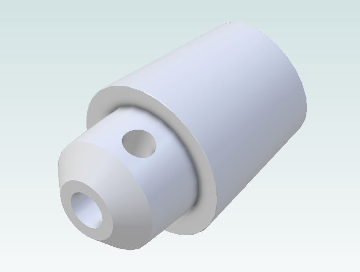

                                    Is your spindle hollow?
                                    If so you could make up a holder with the shallow angle of the ER25 and pull that into the nose with a drawbar, this would have the advantage of doing away with any form of nut so you could get closer to the work
