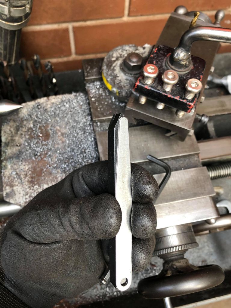

                  I think it's a mixture of perhaps inexperience and poor adjustment of the tailstock. I do step up gradually, but perhaps not as gradual as i should. I suspect my headstock is not approaching the stock perpendicular to the horizontal axis (if that makes any sense), but i haven't checked yet. Either way i'll keep tuning it.
                  As for the tooling i think the issue is the nose radius of the inserts. It cuts fine even at low speeds, however the point is not conducive to a nice finish AFAIK. Ill buy some HSS and grind a softer point and see where that takes me. Same principal as the circular insert tooling, i might even buy one to test it out. I did get this entire set for free so i cannot complain.
                  Cut up and bent a few spanners today. I think they make really nice levers. I'm honestly so tired of picking up a spanner every time i need to lock or unlock something.

                    I like the thing with the spanner – I've never thought of abusing my toys in that way.
                    On my lathe the tailstock dovetail locking nut is drilled and tapped for a simple lever made from round bar that screws in – same diameter as the lever in the barrel clamp. I've freed mine up so that I can take the lever out when I want to otherwise I cant take the tailstock off the bed without removing the leadscrew handwheel. You may find a threaded hole in one of the flats on your nut (or maybe not if it has been swapped).
                    I always keep a 3/8 Whitworth ring spanner handy (pre-war size so almost exactly 18mm A/F) – that size crops up all over the place on my lathe.

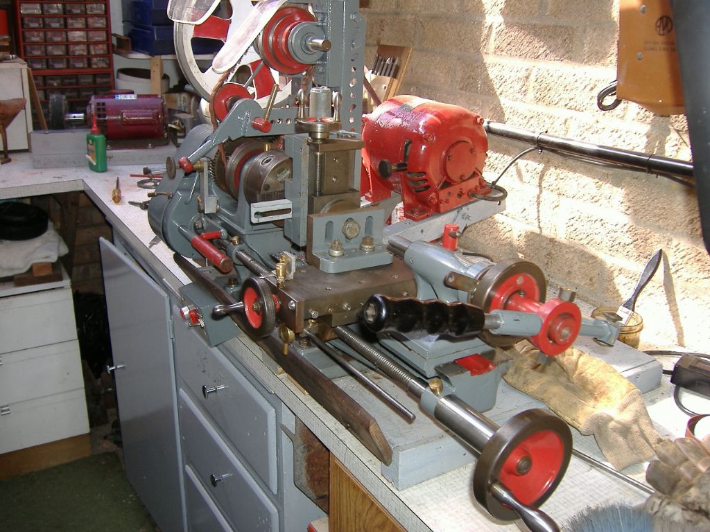

                        Hi Jacob Hope you are O/K Please Find Photo of my lathe set for Milling a Slot Regards Brian.

                          It was only $1 from the hardware store so I didn't feel guilty. I actually spent 15 minutes looking through a box full off odd old spanners and couldn't bring myself to chop anything up. I have a 3/8w spanner laying around also for a nice snug fit.

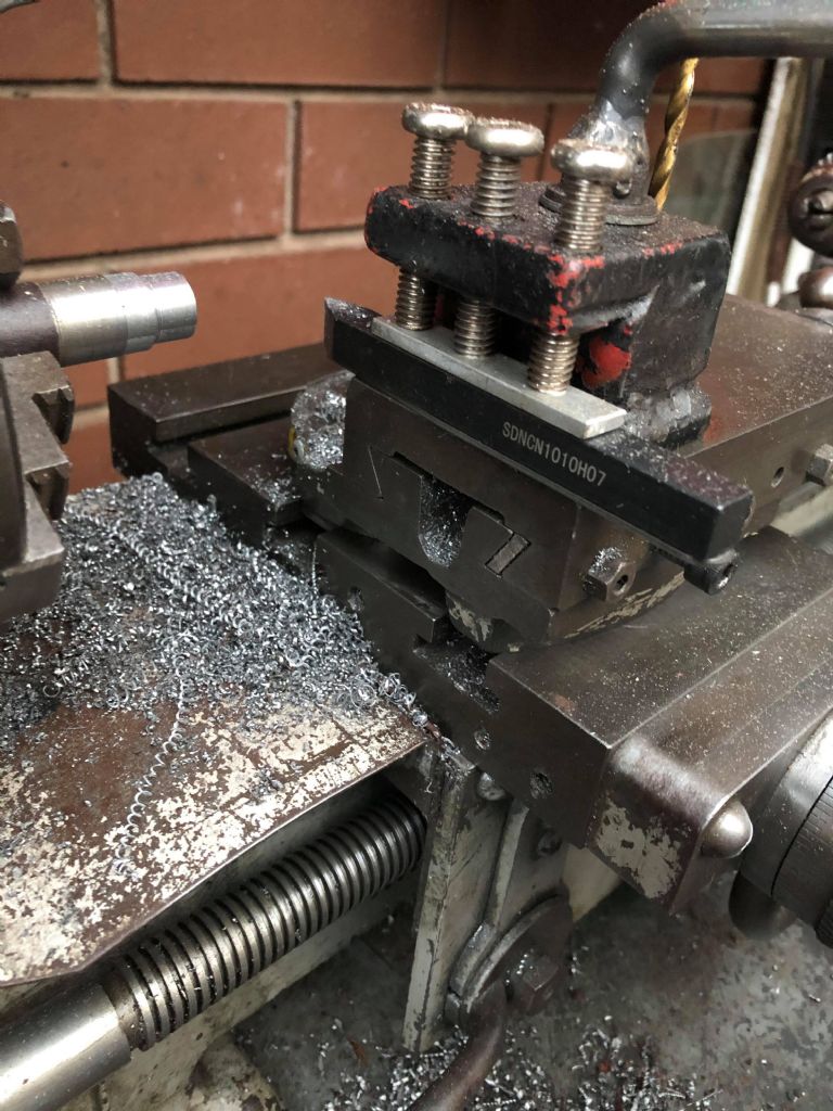

                          I ended up getting some HSS tooling and I ground a much rounder radius which didn't seem to improve the surface finish too much. Might have to just leave with it as it is. I'm expecting shiny cuts and I think that just not possible with this equipment.

                              Nice setup Brian. Does the knob poking out of the motor indicate a repulsion start motor?
                              @Jake: The compound slide dodge would be a little different for the 'Senior' because the compound is different from Brian's – on ours the pivot sticks out to the side of the compound. I think the angle plate dodge would still work but would perhaps be less rigid than Brian's version. It does have the advantage of allowing a choice of angles for the slide feed, unlike many milling slides which only go straight up and down. Then you 'simply' need to figure out how to attache a vice (or the job iself) to your compound
                              I got a vertical slide with my lathe so haven't needed to try the compound thing but I might give it a go some time.
                              You'll also be needing some 'T' nuts to fit your slots… or maybe modified coach bolts. Most modern off the shelf 'T' nuts will need modification to fit the rather shallow Faircut cross slide slots.
                              #490039
                              Brian Morehen
                                @brianmorehen85290
                                Hi Andy
                                The black handled knob is for revesing the motor first switch of and then lift lever up sitch on motor reversed.
                                The vice on the compound slide was made to the compound slide size and is held in place with 3 Allen Screws on each side that have had holes bored into the slide works great.
                                Best Regards to both of you
                                    I noticed this and wondered whether you have tried GHT's advice of setting the tool round so that it almost rubs for the finishing cut.

                                        It does make a difference, albeit not as great a difference as i expected. I'm going to experiment with rounding the nose more and more until i get more favourable results. I was experimenting a little more and it seems to be improving slightly. Im tempted to buy a circle insert cutter but it would be no better than HSS ground to the same radius.

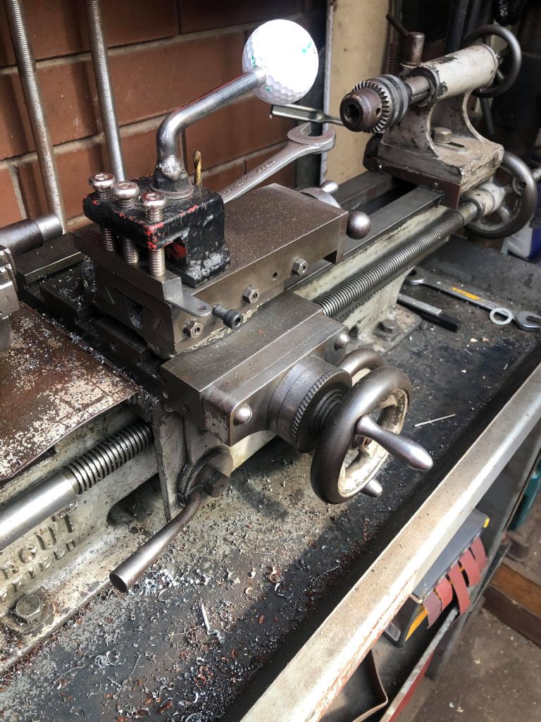

                                          So now that i've modified the toolpost and worked out the right combination of shims i'm quite pleased with how quickly i can change tools. This entire time i thought this type of toolpost was rubbish until i realised its effectively quick change as you can take all the clamping pressure off the tool by loosening the tightening lever. The three socket head screws dont require adjusting each time. I also added a golf ball to make it easier on my palm.

                                              Nice handle Jake
                                              I'm not sure about the clamp screw thing. I wouldn't advise doing that with a Faircut cast toolpost – I've seen photos of several where the rear edge of the toolpost has broken away. My assumption is that this is caused by forgetting to loosen the tool clamping screws before tightening the nut on the toolpost stud. If the tool is thicker than the previous one this will put the toolpost onto an angle and put pressure on the back edge of the toolpost. Probably not an issue with a steel toolpost but not recommended for a casting.
                                              Milling… I always take the attitude that a milling machine is trying to damage itself, the job, me or all of the above. It needs rock solid clamping of the job and the cutter and excellent rigidity. Milling in the lathe is definitely compromising some of those things. If you have backlash in your slides then milling will find it and either push the job away or (worse) dig the cutter into it. Cutters can also dig in axially (think of them as a self tapping screw). So, yes, milling in the lathe is possible but it needs a lot of care and scaled down expectations.

                                                Hi Jake Like the Golf Ball Handle
                                                Your Lathe cutting tool has a sharp point that is giving you the cut that is also giving you the appearance of a thread when you have made a cut. Try and grind a small flat onto that point and take things very slowly on a scarp piece of bar and see if this gives you a smooth shiny cut
                                                Good luck Brian

                                                      Yeah Andy I see what you're saying. In my case the tool post is mild steel and all the tools are the same height (10mm). So locking the tool post back down is only going to apply roughly the same amount of force as when the caps crews were first adjusted. Im actually quite pleased as it's negated the need for a QCTP (for now).
                                                      I think what you're saying is that you need to invest in a mill wink
