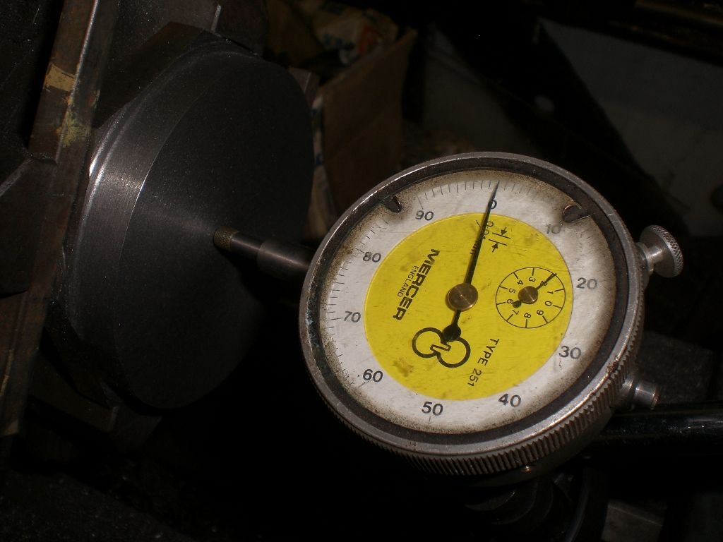

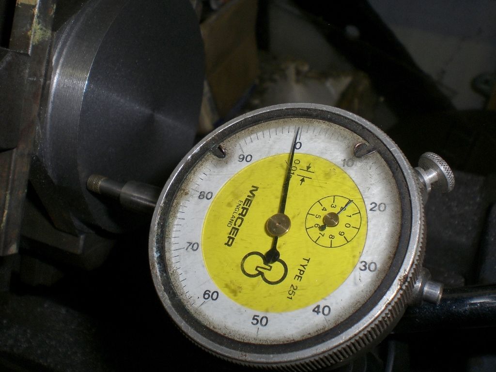

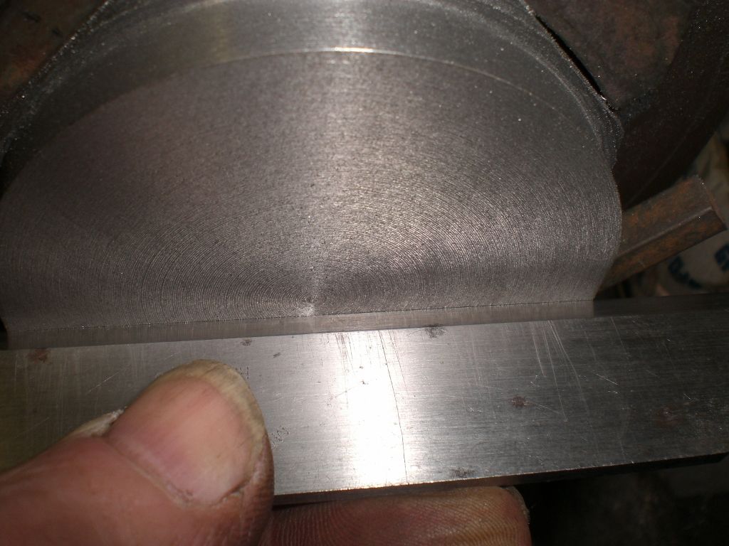

                Hi, as it happens, I faced up a piece of cast iron cut from an old bearing plummer block for an 80 mm 4 jaw. I found no significant out of flatness at all. First checked it with a straight edge.
                Then with a DTI and the error was not much more than the width of the pointer. This was done on my Boxford lathe.
                I'm wondering if SOD's back plate has become progressively harder from the inside to the outside during its manufacture for some reason, which could attribute to the concaving, just a thought.
                Regards Nick.

                  Again, we need to be sure that we are clear that mounting a dial indicator on the toolpost or cross slide and then sweeping the pointer across the freshly faced surface does not give any indication whatsoever of flatness. The dial indicator is following the same path the cutting tool just took. So if the tool cut a surface with a 5mm dish in it, the dial indicator will follow the same path and show no deflection of the needle. (Providing gibs are tight, topslide is locked and no other random slop or movement is allowed.)
                  The straight edge test is good.

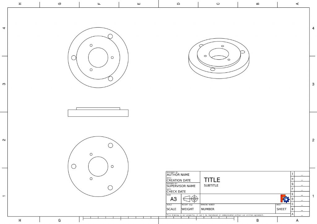

                                      Just a quicky for hopper, there's no secret about what I'm making – it's a chuck back-plate being made from a casting for the same lathe.
                                      Not sure how to get FreeCAD to add dimensions to a generated drawing, but the plate is 160mm diameter and 18m thick.
                                      I don't think what it is makes much difference to the facing error, I could be facing anything. The way the casting was held in the chuck is more suspicious: although it felt firm, cutting pressure might have been rocking it.
                                      I've decided to finish the backplate and will re-open the investigation when I face off the other side. Got a number of suggestions to try.

                                        Gary Wooding in the posting "Lathe facing convex or concave" made a nice drawing of what the DTI is indicating. Sorry, no idea how to make a direct link to that posting so you have to look it up. Niko.
                                        #367294
                                        Journeyman
                                          @journeyman
                                          Dave, I don't know whether that drawing is for the finished item but if so it does not show the register that mates with the lathe spindle. There should be a recess in the backside (about 52mm diameter an 4mm deep, if I remember correctly) which locates the chuck radially on the spindle.
                                          Perhaps I am looking at the drawing incorrectly and the hole through the middle is the register? I should have looked at my own backplate making effort first *** Collet Chuck *** DOHblush
                                          Edit: 2nd Thoughts!!
                                          Edited By Journeyman on 14/08/2018 12:07:18

                                                OK. So the backplate should be bolted to the flange and finish turned across the surfaces the chuck mounts to while in situ so the chuck ends up running true to the spindle axis. (Is there a spigot or register of some sort on the spindle flange side of the backplate to ensure it always runs concentric to the spindle?)
                                                If your facing cut is somewhat concave, it will not matter too much on the shown backplate. The chuck is located by the OD of the register step and the narrow flange of material outboard of that, which if slightly concave will not matter a whit. Chuck will locate on the outer area without rocking, which it would if the surface were convex.
                                                Hard to see how the blank could be loose enough to magically wobble around in a conical shape without falling out of the chuck all together, or at least jamming up the tool etc.
                                                If the cross slide is moving at an angle to the spindle axis, it might be a matter of cross slide gib adjustment, but it could also quite likely be a matter of the saddle sitting skewed on the bed, causing the cross slide dovetails to be skewed. Could be poor machining on the ways in the saddle, or wear, or just a bit of swarf in the wrong place.
                                                Edited By Hopper on 14/08/2018 12:57:59
                                                #367325
                                                  The hole in the backplate fits onto a 10mm or so long spigot that protrudes from the flange so the drawing is correct.
                                                  The raised register that is shown on te drawong is the usula register for a chuck, I assume a 160mm chuck from the size given.
                                                  I did mention early on that it was a flange mount plate and the cast boss would get turned away and stud holes drilled.
