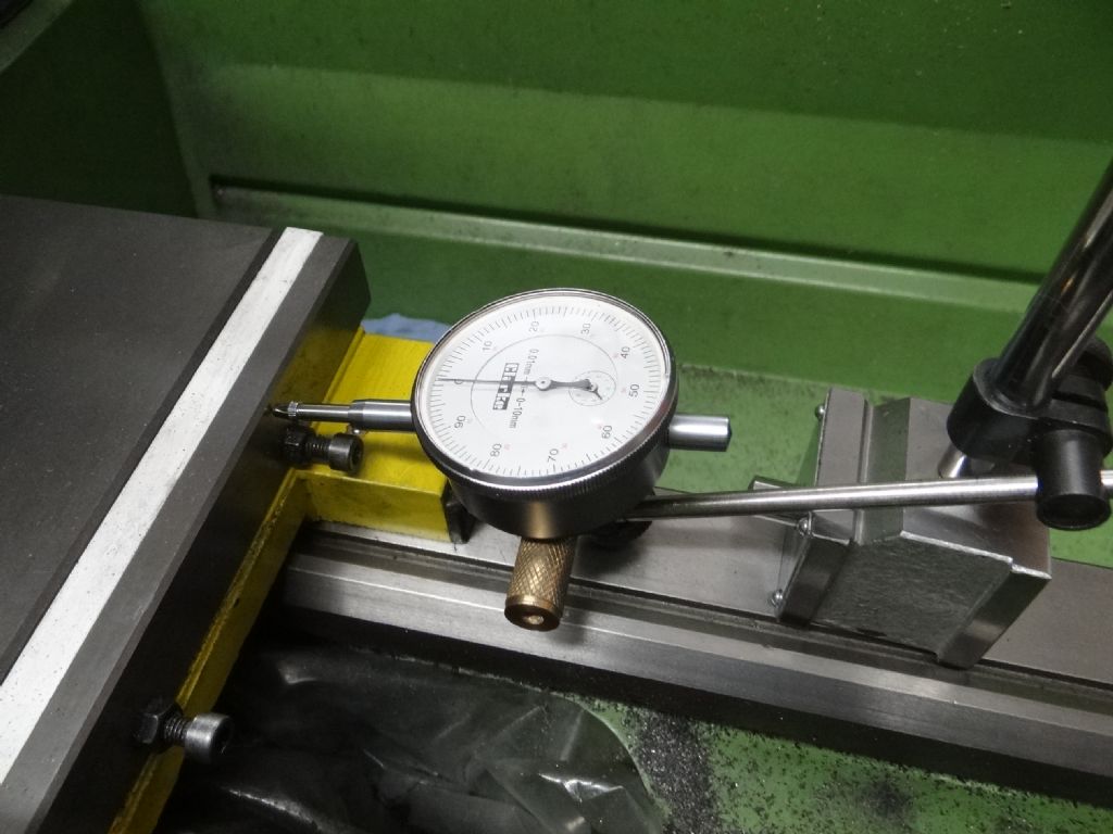

                        In the last face-off I put my DTI on the side of the slide to see how much it moved during cutting. Not enough to explain the facing issue – less than 0.03mm over 150mm.

                          You need the DTI magnetised to the cross slide – not the lathe bed!
                          Once on the cross slide, run the DTI on the operator side of the backplate – this will show deflection/play when you faced up the part. Then run the DTI on the other side (far side, same surface) of the backplate – this will show twice the actual error you are getting.

                            I really don't think that last measurement of yours is meaningful. As the cross slide goes past the DTI, all you have discovered is the flatness of an unimportant face on your cross slide. Imagine if there were corrugations on that rear face you've just measured, how would it affect the machining of the tool tip? Frankly, not one iota. It does show, though, that actually you have a nicely made machine. It is of interest, but of no consequence to the possible squareness or not of the cut.

                                  A misunderstanding Martin. When I measured the facing error the DTI was positioned on the saddle. This set-up was intended to show if the slide drifts to one side as it's moved along the saddle's dovetails. It appears not, though Richard makes a good point that the test is dubious because the face is cosmetic.
                                  Keep it coming, I feel we're getting closer as possibilities are eliminated and my dodgy measuring technique is improved thanks to criticism.
