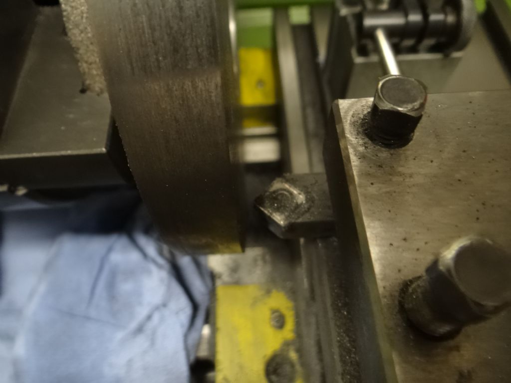

I've confirmed there is a problem. I took another 0.2mm off the face last night and got a similar result. Locking the top-slide properly nearly halved the error, so that was part of the problem, but locking didn't eliminate it.

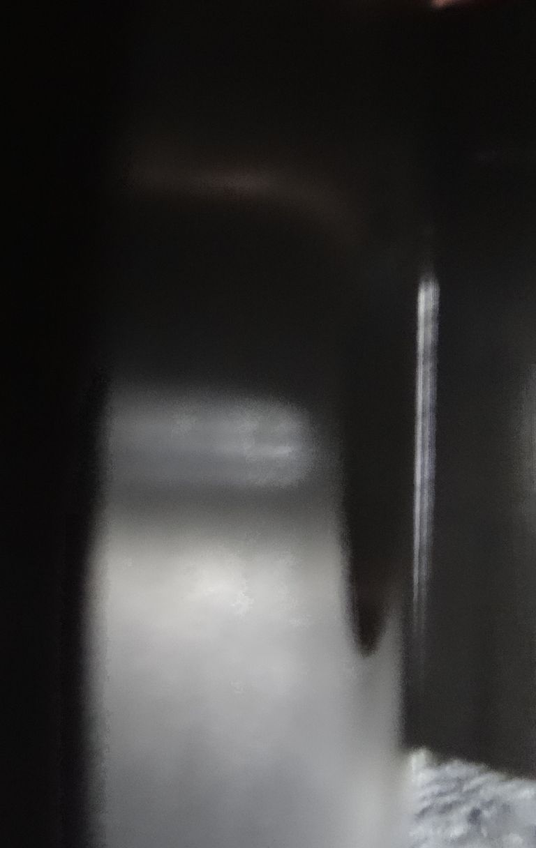

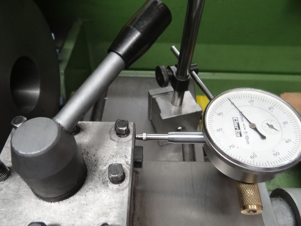

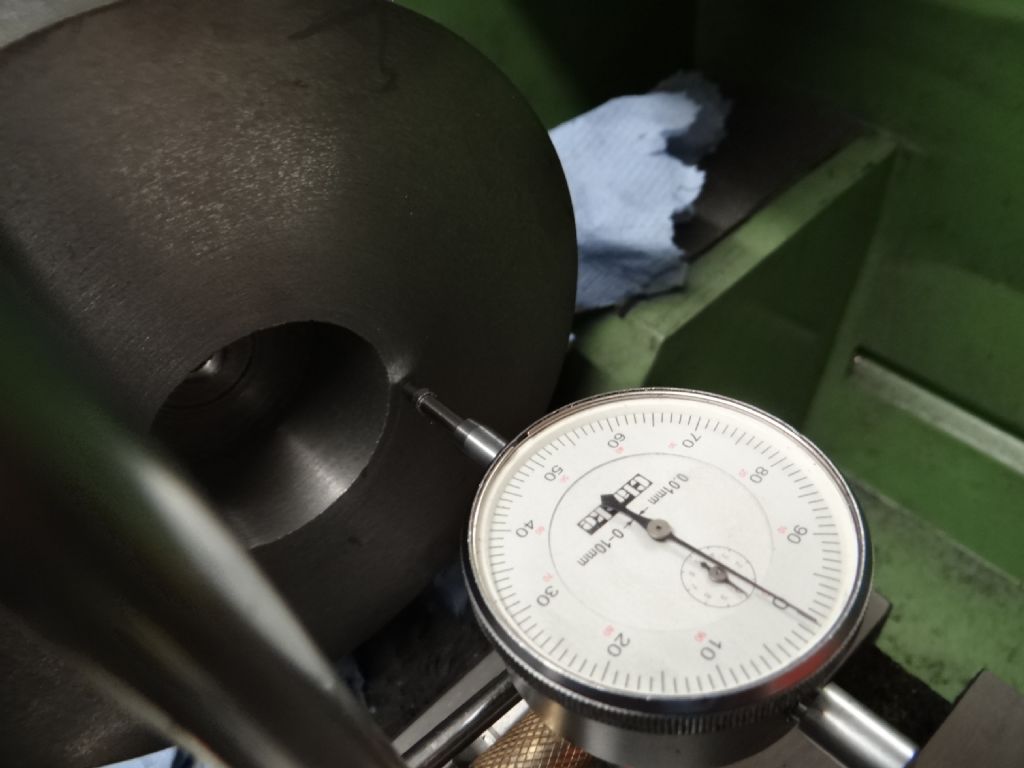

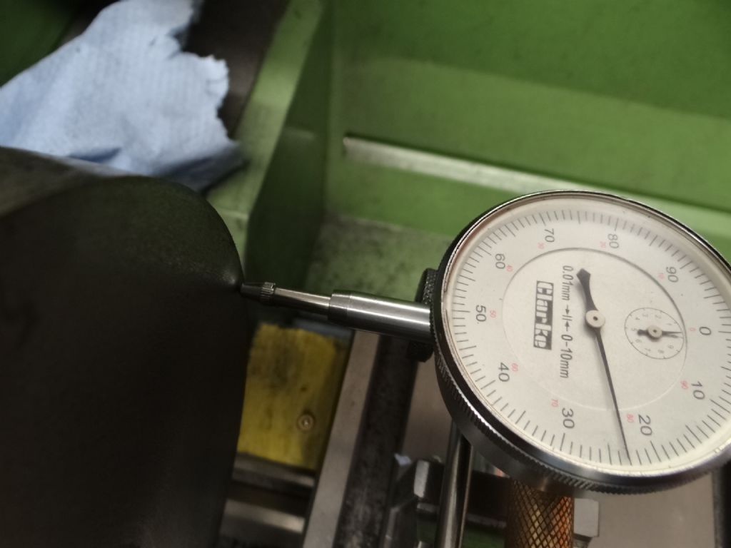

The test I believe confirms the error is the amount of visible light appearing under a straight-edge. The straight-edge shows the lathe is cutting concave (which is correct). Assuming I'm applying it correctly, a DTI shows the error to be excessive (about 0.08mm over 50mm) . For comparison Schlesinger's target for facing is 0.02mm over 300mm. (Thank you Michael for that information.)

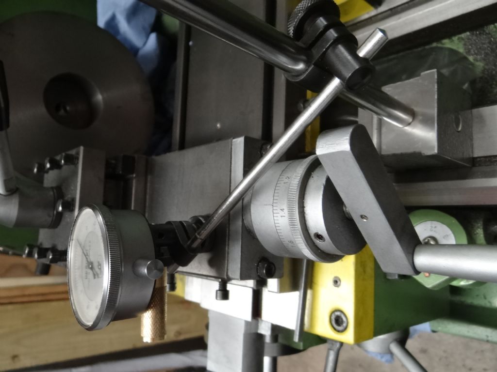

I need to finish the job I'm doing and then investigate further. At the moment the lathe is filthy (cutting cast-iron), and everything needs a good clean before jumping to conclusions. Sleeping on it, I thought of a few more checks. I don't think they're likely to be loose but I need to confirm the tool-shank is clamped firmly to the top-slide and that the top-slide is tight on the saddle.
