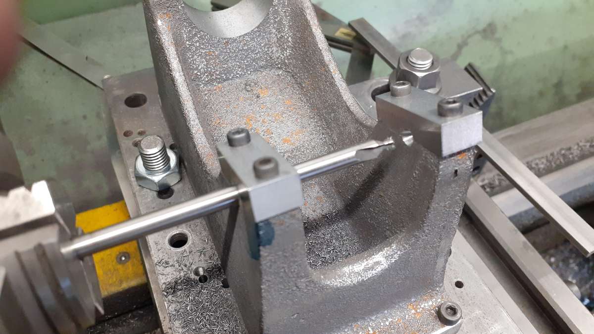

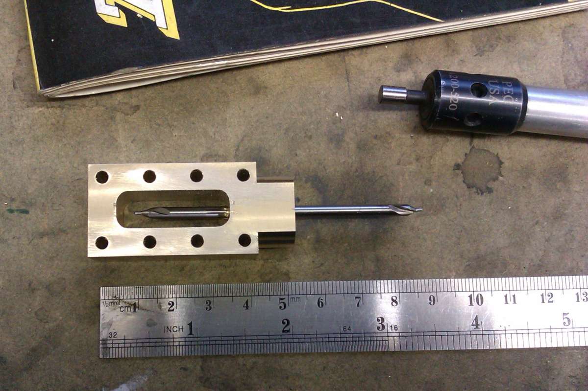

          #743217
            MSC have them in various lengths and diameters both metric and imperial.
            Bernards method is OK for soem jobs but not when you want to do someting like the rod guide hole on the far end of a steam chest where you only have a small entry hole.
            IMAG0130
            Or on a job like this, starting a hole through a previous one that can be reamed to help guide the long bit.
            20240303_150040

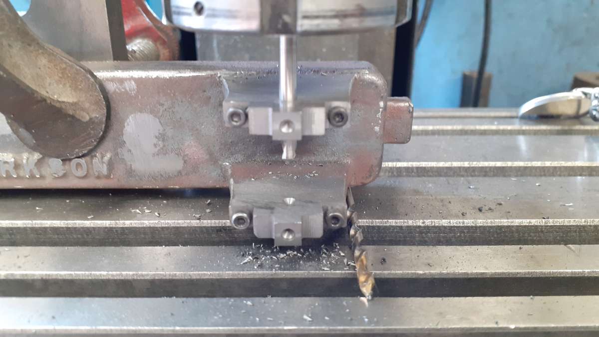

                    #743258
                      Although I too much prefer a spot drill the price of long series ones is a bit silly, take a look at the ones on teh Drill Services site as an example.
                      Some of the standard length spotting drills may get you deep enough I have a 4mm dia x 50mm long and a 6mm x 70mm long which can be handy, the 4mm gets used when a cross hole is close to a collet or the spin indexer and anything shorter will see the chuck crash unless the work is sticking out a long way.
                      The 4mm spotting drill here being used in a similar way to the image of a long ctr drill I posted earlier
                      20240614_134525
