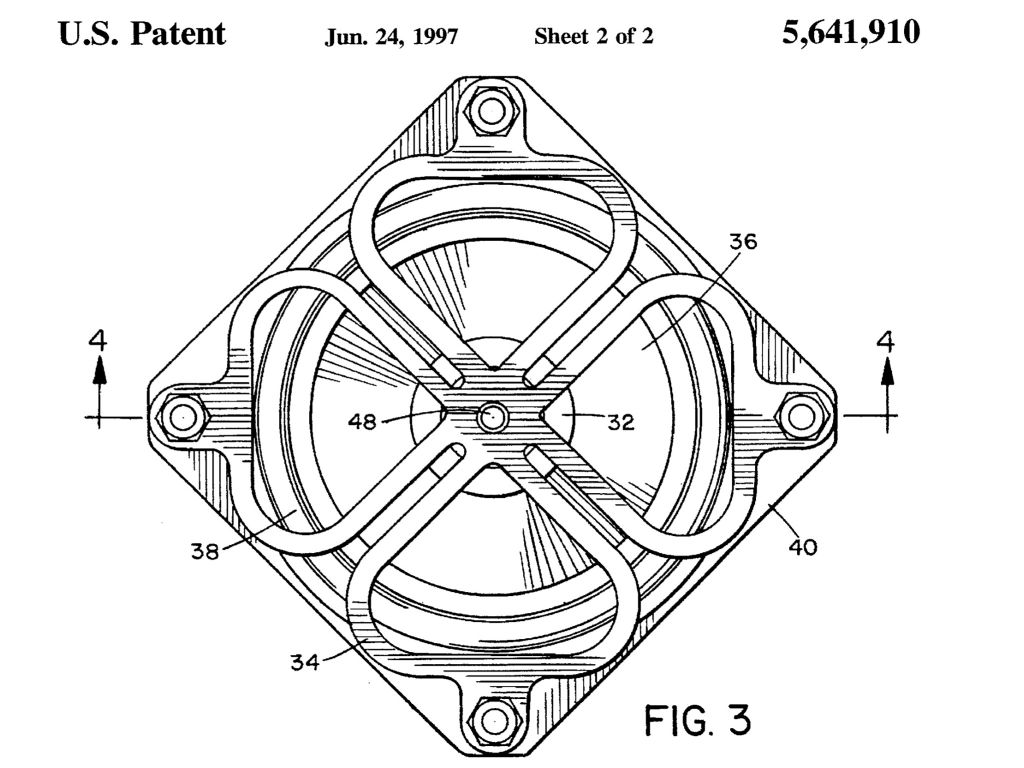

Good to see you progressing with this, Dave … but:
May I suggest that you re-engineer your loudspeaking shaker ?
The actual modification would depend upon the donor loudspeaker, but in essence you should replace the cone with a ‘spider’ … this keeps things nicely linear, and filters-out most of the irrelevant noise.
Hint:
Yes, please do suggest re-engineering the shaker, and thanks for the patent drawing. Deciding how to make the cloverleaf will keep me amused for a while, and as for replacing the cone? Now where's my Stanley Knife…
Hi-Fi Buffs look away. At the moment the speaker is glued directly to the biscuit tin with no consideration of efficiency or acoustics. As a speaker enclosure, nought out of ten.
This is how engineering projects spiral out of control. To find a suitable accelerometer, I have to develop a Vibration Table / Shaker, which is yet more technology I don't understand…
