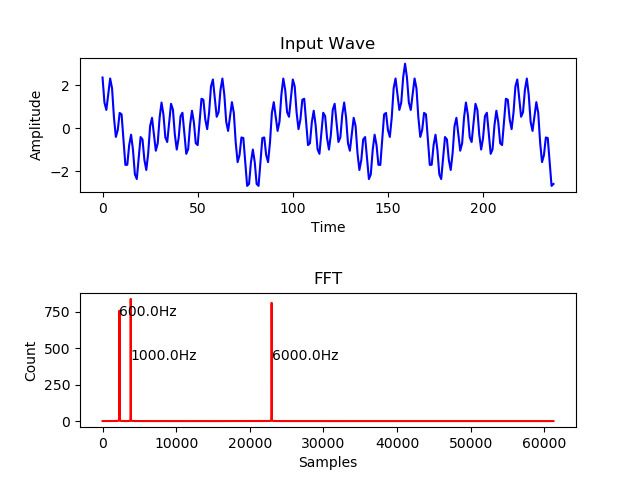

      Next is identifying frequency spikes in the sound. A wav file is a list of numbers representing frequencies changing over time. The image below is a simple test wave made from 3 clean sine waves and its already hard to see what they are. A Fast Fourier Transform converts the wave from the time domain into the frequency domain producing a sort of histogram showing how frequencies are spread across a spectrum.
      Wunderbar, FFT found 3 inputs!

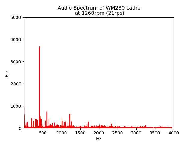

      Applying FFT to the WM280 recording:wm280fft.jpg
      Complicated result, but big spike at 400Hz, which seems nicely related to the chuck at 21rps (19*21). Also related spikes at about 200, 600, 800, 1000, and 1200Hz.
      No conclusions yet! Next, I'll look for lathe settings producing poor finish and repeat to see if it occurs at particular frequencies.

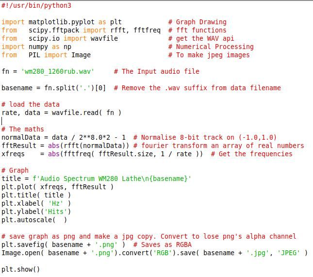

      Python program doing the work:
      Don't understand why I had to multiply frequencies by 44 to get the graph X scale right. Hate fudge & I'm baffled! A promising start though. My brain is cooked…

            I expect the odd multiple to get the frequency axis correct is due to incorrect scaling in the time domain to start with. Caveat, see next paragraph.
            If the chuck is rotating at 21Hz why is 400Hz (and the times 19) important? I'd expect a fundamental at 21Hz and multiples thereof depending upon the number of teeth on gears.

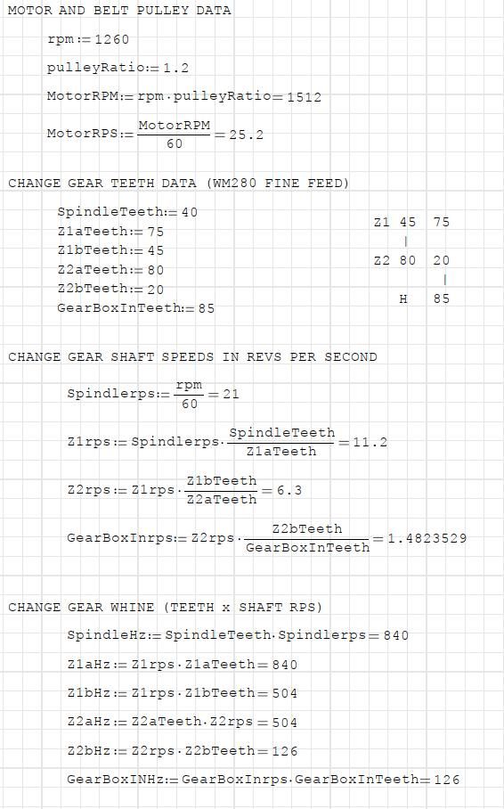

                Tried to justify my 400Hz and times 19 spindle speed claim by relating it to the lathe's change gear set-up and FAILED. On the assumption the noise is change gear whine, I reckon I should be seeing 126Hz, 504Hz and 840Hz. Calculations:
                I had the fixed gearbox engaged on the half speed setting and turning the Feed Shaft, but not driving anything. I doubt it explains the discrepancy.
                I assumed 19:1 would be the change gear ratio. Not so, if I've done the sums right, fine feed on a metric WM280 banjo is 14:1.
                Back to the Drawing Board…

                      Could the "44" be the 44 Khz audio sample rate ?

                                  The multiple frequencies you are seeing as harmonics (200, 400, 600, etc) could also be created by 'aliasing' if the sample rate is not correct.

                                    Just a thought re your 44 fudge factor 8000/180 = 44.44444. Your scaling factor in the fftfreq is 8000/size and size is 8000*180

                                      The 44 fudge factor mystery is solved. My mistake – I plugged in the wrong sum instead of 1/sampleRate.  See AdrianR's post!
                                      Latest version of the Python program that does the analysis:
                                      Probably ought to mention in connection with the maths that 'data', 'normalData', 'fftResult' and 'xfreqs' are arrays of numbers, not individual values. An audio sample lasting 15 seconds consists of over 100,000 numbers, so – despite the programs' apparent simplicity – it's doing millions of floating point calculations. Not a job for a slide-rule or calculator!

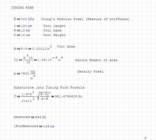

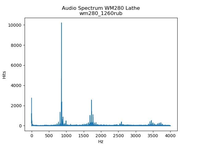

                                      Anyway, next analysis is of something bad! I rubbed a carbide insert on the shoulder of ⌀38mm steel at 1260rpm, which produces an awful 'stop now you idiot' screech. The frequency spectrum is:
                                      There's a fundamental at about 864Hz, second harmonic at 1728Hz, third at 2592Hz, and maybe 4th at 3456Hz. Rubbing vibration completely dominates whatever other noises the lathe is making. So what's vibrating at 864Hz? It can only be the tool.
                                      Applying the tuning fork formula to the size and material of my insert holder gets close:
                                      The formula suggests a 12x10x106mm steel tool would vibrate at 864Hz, which is delightfully close to its actual size, 12x10x100. However, I don't believe it! Unfortunately the tool is clamped to the tool-post with three bolts, and its overhang is only 17mm. I think I'm measuring the vibration of the tool, tool-post, compound slide and saddle. Also, because the tool is rubbing, the vibration may be more forced than free. Not sure what part is played by the tool rubbing on a 33mm diameter shoulder rotating at 21 revolutions per second. Is my insert-holder & tool-post vibrating in tune like a violin string, or is it just responding to a frequency generated by the spindle and tool rubbing at a surface speed of 2.5m/s? I've no idea!
                                        That's good; it's saved me writing out the mathematics of the Discrete Fourier Transform to demonstrate the relationship between the x-axis in time and frequency domains. The original FFT algorithm by Cooley and Tukey reduced the number of operations for an N length transform from ~N^2 to ~Nlog2(N), where N is a power of 2. Note that these operations are complex as the Fourier transform uses complex numbers. So each complex multiply is four real multiplies and two additions.

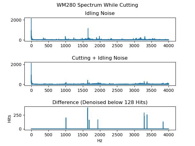

                                          Digitising data and the FFT opens the door on applying mathematical filters to data. In this next example I took two samples. The first is of my lathe running at 1260rpm without doing anything useful. The second is the same settings but with the saddle engaged to take a 0.2mm deep cut out of a 38mm diameter steel pipe.
                                          The idea is to extract vibration due to just spinning from vibration due to spinning AND cutting. The subtraction should highlight vibration due to cutting while hiding vibration due to normal running.
                                          So two samples are taken, trimmed to equal length, normalised, and both are analysed by FFT to produce a pair of frequency spectra. Then the difference of the two is taken, and the random noise filtered out by ignoring any frequency counts below a convenient level. What remains is vibration due to cutting.
                                          Three graphs:
                                          The Difference graph shows 7 frequency spikes appear whilst cutting. The good news is they are all small compared with ordinary running : it suggests my lathe doesn't have a vibration problem at 1260 rpm whilst cutting steel at feed-rate 0.28mm per revolution. I've no idea why my test combination of gears, belts and cutting conditions produces these 7 frequencies.

                                              …………….the FFT opens the door on applying mathematical filters to data.
                                              Some interesting results, and as you're discovering the biggest problem is interpreting said results.
                                              As for filtering it's a case of what they didn't say in Star Trek:
                                              It's filtering Jim, but not as we know it.
                                              Filtering in the mathematical sense is a convolution in the time domain, which conveniently transforms to a multiplication in the frequency domain. The Fourier transform exhibits linearity, so for two time series x(t) and y(t) we can say:
                                              x(t) + y(t) <=> X(f) + Y(f)
                                              So the subtraction in the frequency domain is the same as subraction in the time domain, if a bit more convenient in the frequency domain. In a sense it's a filter in that one is saying I don't want that frequency and removing it by subtraction. But of course the 'filter' characteristic would change with each FFT unless the unwanted frequency stayed exactly the same.
                                              Feel free to have a beer after that!
