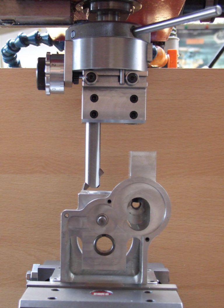

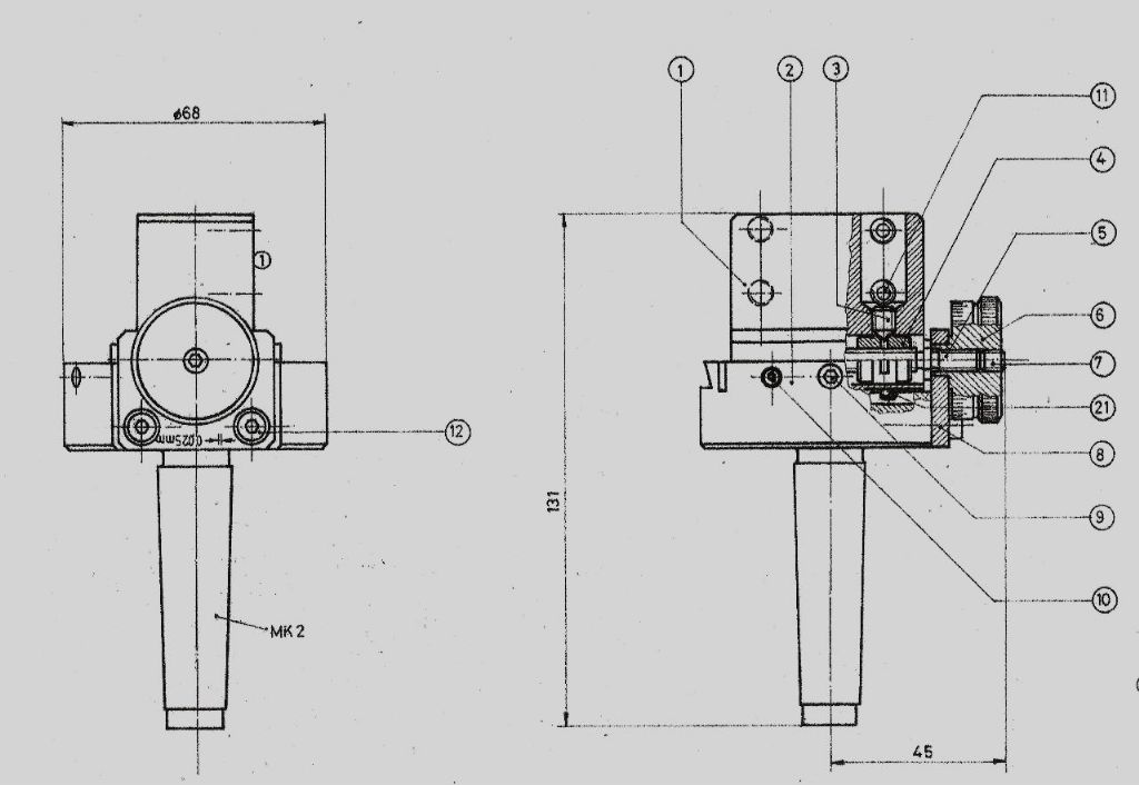

      Back in the late 1980's I adapted the standard Emco boring head design to do facing work as well .
      fig 1 second generation emco boring head, reproduced courtescy of the emco group..jpg
      While many of examples of my Boring and Facing head have been made around the world the design did not suit everyone. Some did not like the original large dial used by Emco, not realising this was in fact there to aid balancing.

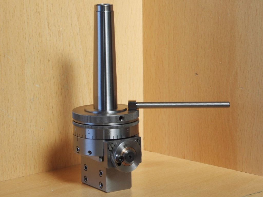

      As the original design was an adaptation to meet an the needs of a pending job at the time. I decided to start with a clean sheet of paper and design a boring head which had the dial concentric with the main body. Certain features of the original Emco design have been retained. No point trying to re-invent the wheel.
      The New version has a continuous drive to the feedscrew during facing operations un-like my initial design which has an intermittent, 2 speed, bi-directional drive. The New head has a single speed but still feeds in two directions. There is an inbuilt adjustable clutch to cut out the feed when the stops are being used.
      The Dial is Zero setting and one complete revolution removes 0.1 mm from the bore. Each numbered division removes 0.01 mm from the bore.
      The largish knurled ring on the end is the selector mechanism for the direction of feed.
      The Mk V head came about after a friend asked me to make him a B&F Head as he could not find one suitable for his new Mill. I must admit I have not seen any to suit this particular mill with a facing capacity. The Mk I being the initial Emco design.

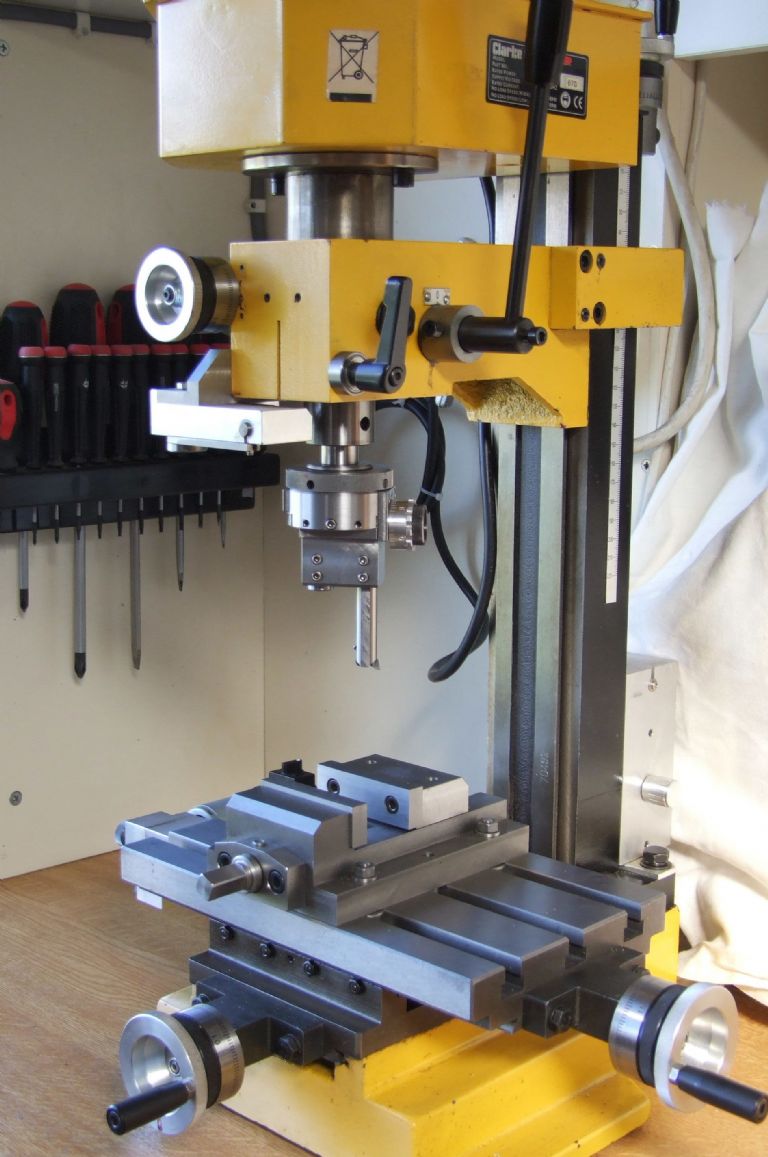

          When I tooled up the X1 milling machine I decided the original boring and facing head, (Mk II), was just too big for this machine. I therefore made the Mk III which has a 50 mm body, compared to the original which had a 66 mm body.
          This boring head saw more use on the Emco FB 2 in the end and it proved to be a much more in keeping with the size of the machine and the work that I do.
          Thus when it came to making a NEW version of the B&F head with constant drive I decided that the 50 mm body would be the basis of the prototype. This then is the Mk IIII, and has seen considerable use on my version of the Clayton Steam wagon and the Fiat 702 Tractor that I am building.

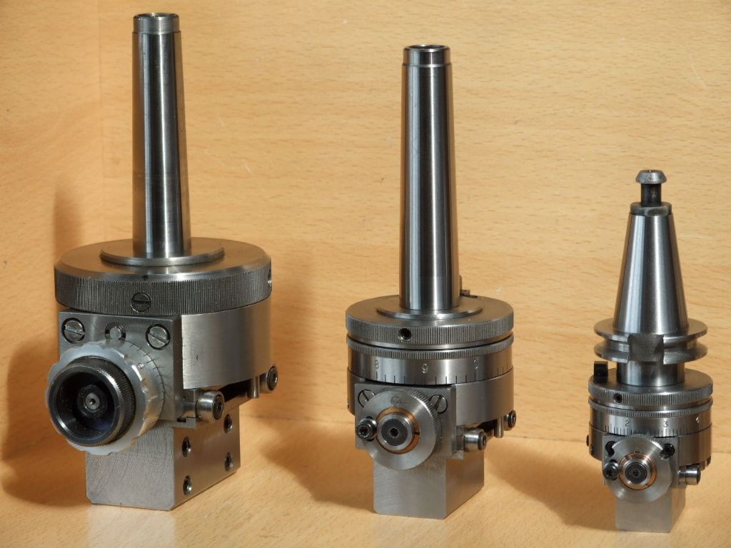

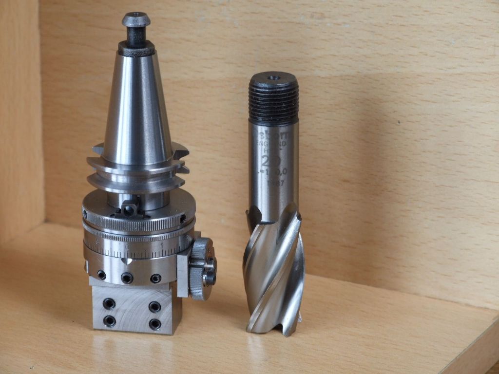

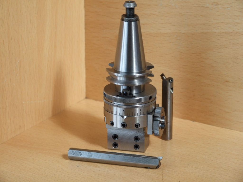

                Thanks for the kind comments, this B&F head was a joint venture. As so often happens lately this head was mentioned in passing during a conversation with John Slater. Who has done some 3D views of the internal workings of the Mk IIII head. When I said I had schemed out a smaller head he said he would like to see the drawings.
                Thus another collaboration started on the MK V. John however was not the recipient of the Mk V shown, that was for another machine. John is building his own version for his mill.
                I wonder how many have thought the Mk V was on an ISO 30 shank?
                The actual taper is a BT 20,
                Regards
                Gray,
                #402693
                Graham Meek
                  @grahammeek88282
                  One last photograph to show the lineage,
                  Regards
                  Gray,

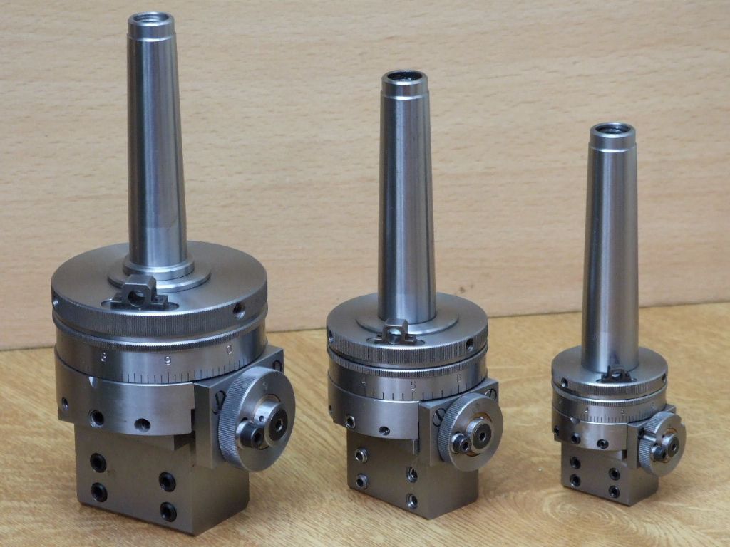

                      #479066
                      Graham Meek
                        @grahammeek88282

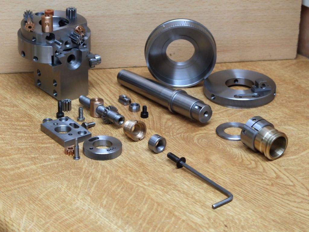

                        Following numerous requests for drawings of a larger version of the 36 mm and 50 mm Concentric Dial B&F Heads. Of a size along the lines of my original 66 mm design that appeared some years ago. I have recently completed this design of a 66 mm Concentric Dial version and thought I would share this with the Forum.
                        I have also included a view of the component parts prior to assembly. The worm drive for this version is a modified 2.5 mm pitch screw thread and the helical worm gears are 30 degree Pressure Angle. Many have asked how the drive is achieved in previous postings on this Forum, and elsewhere, so this should give those wishing to know most of the answers
                        Articles on all three versions are either in hand, or already away at the publishers.
                        Regards
                        Gray,
