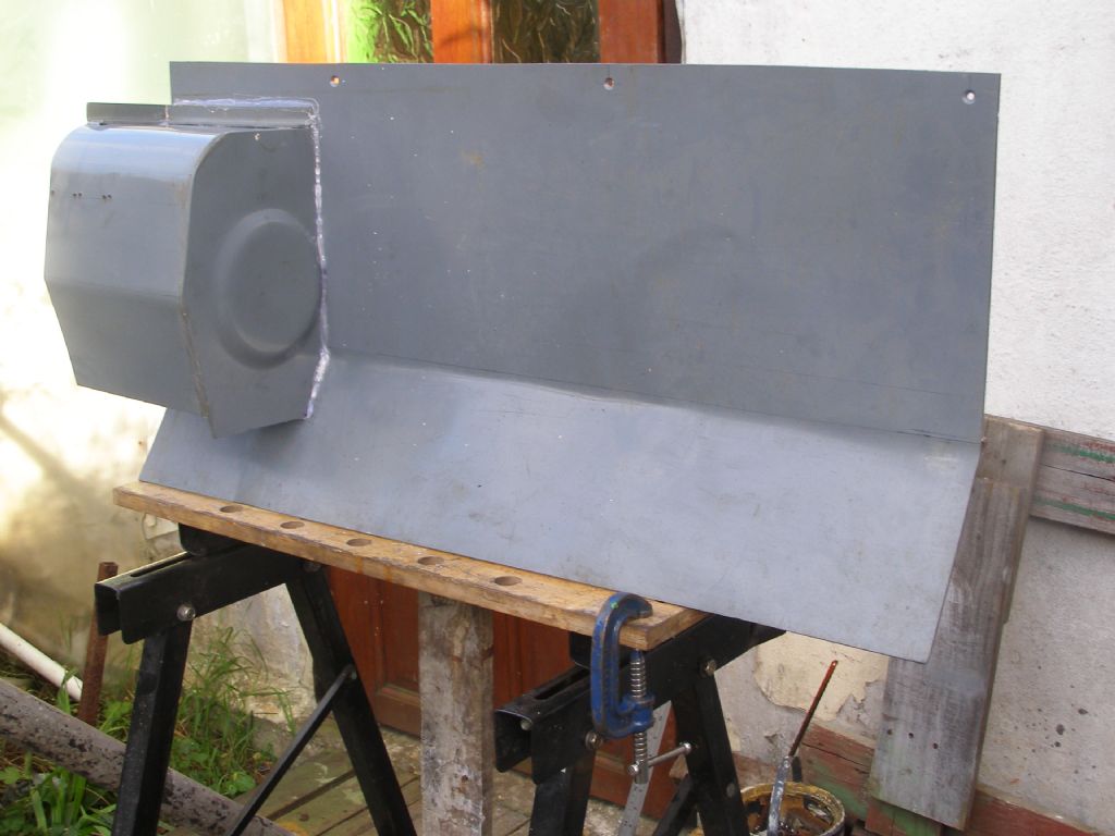

                I fitted a Newton-Tesla (others are available!) motor + inverter set on my ML7, and following that experience, to my Harrison L5 lathe, Myford VMC milling-machine and BCA jig-borer.
                For each case I told the supplier which machine, so the conversion is appropriate. The motor for the two Myford machines were straight swaps but I needed make an adaptor plate for the BCA, and built a completely new motor frame for the Harrison anyway.
                Also, I refused to fall for "You can now throw away the countershaft". The speed controller allows running the motor at speeds well below its best, if only best for cooling, but that is bad practice, and loses the torque advantage of the mechanical transmission.
                For example, the spindle on my Harrison, with its all-geared headstock, can amble round at about 70rpm with the motor happy at somewhere approaching 1000rpm – the pointer on the speed knob well inside the green sector on the scale.
                Having so fitted these machines, they all run very well indeed.
                The first gain for the ML7 was that the cabinet does not resonate as it did with the original 1ph motor. Is it fast enough with a 3ph motor? Yes: I think the motor is of the same top speed as the original 1ph (I keep as spare); but I rarely need use top pulley speed, even with carbide-insert tooling that "received wisdom" says only works at terrifying speeds – just because it can!
                You must shield the motor without blocking the air-flow if an open-frame type, because if swarf enters it and causes a short-circuit it will wreck the electronics before the motor. As I found when a long ribbon of bronze sneaked round the somewhat crude shield….
                I append the photo, pre-installing, of the motor-guard / splashback I fabricated from 3mm PVC sheet.
                Also note that although the Newton-Tesla inverters for the Myford lathes are enclosed (at least, mine is) some of the other they sell are a bit more generic with much more open cases. These should really be installed in proper enclosures. (I'll do that….. one day.. I did ensure they are well away from any swarf etc. though.)
                Finally, they warn not to use the emergency stop-button as the routine off-switch, as repeated such use can damage the electronics. This likely also applies to safety treadle-switches.
                So by all means convert your ML7 – but go for a decent make and a kit specified for the lathe.
                Myford ML7 splash-back. The circular bulge is to give more room for cooling air. I pressed it by softening the plastic using a heat-gun, and pushing down between wooden former, using the bench-drill arbor.
