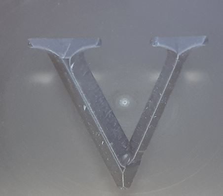

                    #504559
                      I was engraving some plastic in the week and used a drill mill which is a bit more sturdy than the more slender engraving cutters having a 90deg point which mat save you a breakage. I was running at 5000rpm and feed rate was 200mm/min so with the 2-flutes that was a chip load of 0.02mm. I can't show it all but I'm happy with the cut.

                          #504579
                            These are 8mm high numbers with a 6mm shank version of the same type of cutter, I did some 6mm lettering on that clear acrylic that had the V on it no problem.
                            You can get 1/8 shank Vee cutters with various width ends which would allow you to get slightly further down into the second colour while keeping the font thin, I recently got some of these but not tried them yet.

                                Posted by JasonB on 31/10/2020 19:58:56:
                                Ah – a tool organiser. Nice. My ER16s live in their little blue boxes that they came in from Arc Euro… all lined up in a little fancy box that had some chocolate ginger in. Sadly the 1/4 in collet is an odd one out that came in a round see through box. I see you have a similar issue there.
                                I was thinking from your 'V' picture earlier that the mill drill was varying its depth to do thin bits like the serifs. Or am I reading too much into it? Anyway I don't think I have clever enough software to do that at the moment.
                                I think you have correctly deduced that I need thinner cutters (1/8 in max) for the Proxxon. Those German ones look like a 'D' bit… which perhaps suggests a low cost option that would avoid any risk of breaking a milling cutter.

                                  #504588
                                    Yes, F360 will lift the pointed end of the cutter to give "square ends" to the font and also vary the depth where one part of the character is wider than the other. I set the ones in the clear to have more rounded ends as they ar efor a pattern but this shows the tool path for the collet rack
                                    The Sorotec are a more traditional cutter similar to what would have been used on pantographs etc and probably a bit more robust than a 1mm 2-flute milling cutter. With the added bonus that one cutter will do several width fonts just by playing with depth.
