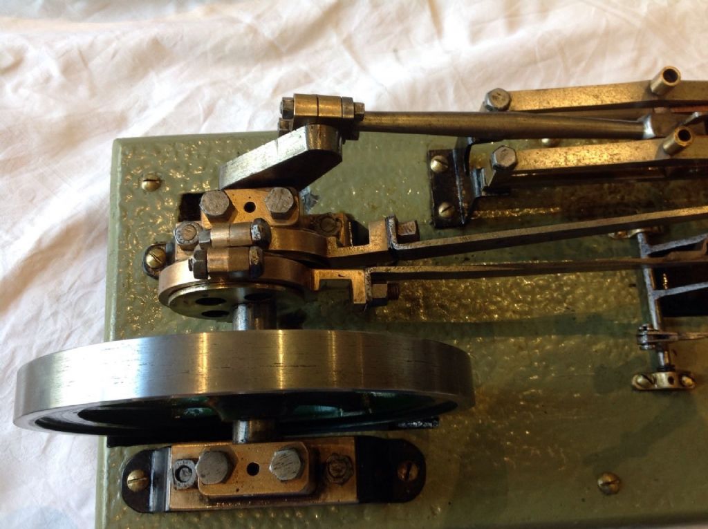

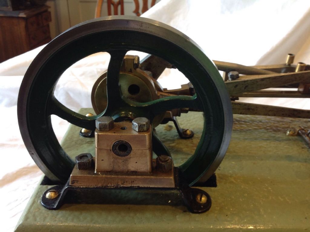

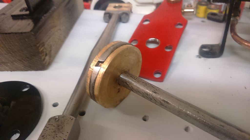

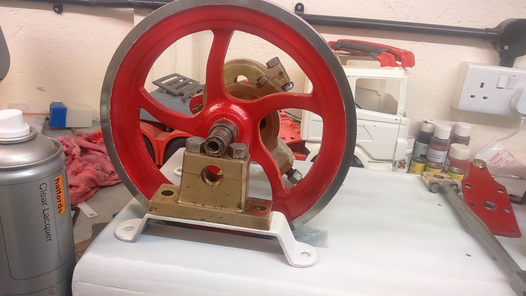

      i bought this engine from flebay the other week i have no idea on its age or whats it based on here a few pictures of the engine before i stripped it down.(from flebay)
      from looks of things almost nothing has been machined. IE: the bushes and spacers are rolled sheet metal.
      $_60.jpg$_59.jpg$_58.jpg.
      my plan is to repair any broken or wornout parts and then update the looks of the engine mainly the base. i have notice that the last owner has sanded off the paint from all the parts. this makes them looks nasty so i have desided to repaint them. but i plan on polshing some of the brass etc.
      one thing i dont like is on picture two is the two oversized nuts connecting the rods to the things on flywheel shaft (i can't spell the name). what do you all think if i brazed them togeather to do away with the nuts ???
      what do you all think ??
      thanks
      Gavin

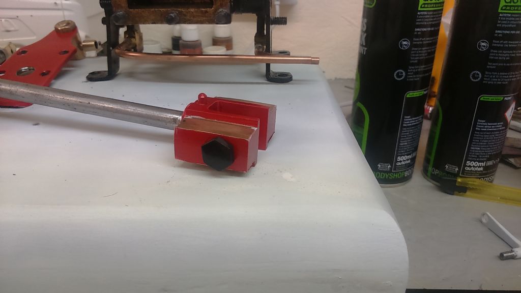

        #215612
          I think I would stay with nuts to join the eccentric rods to the eccentric straps but if you can identify the thread used you could use a smaller size nut then drill it out and tap to the existing thread.
          The way the strap is shaped to meet the "L" bend in the end of the rod would look wrong if you silver soldered the parts IMHO
          #215618
          gavin compton
            @gavincompton68796
            Hi Jason
            thanks for reply. thread is removeable they are studs. you right about the "L" looking werid. guess im just being picky. i could thread a bit of round bar and then blend the round bar on to the other end of the eccentric rods,if the angle wrong i would sliver solder at correct angle. then again if it not broke………..
            i also removed the wood lagging it was rather uneven and unsightly not sure if to put wood back on or sheet metal color matched.

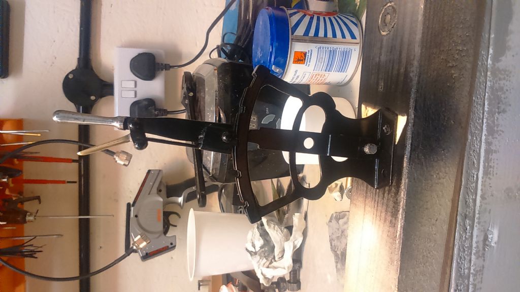

            #215702
            gavin compton
              @gavincompton68796

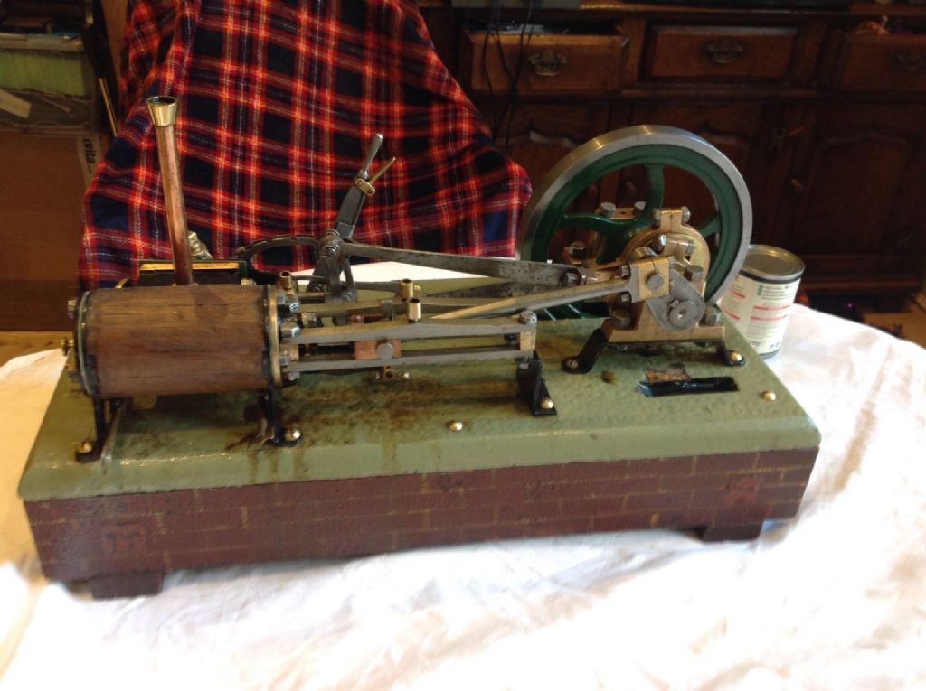

              Hi all
              here a few more pics

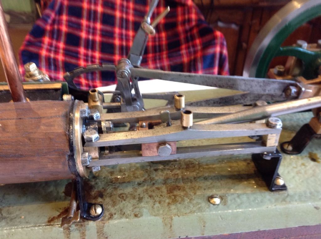

              As you can see i changed the color of the flywheel and striped and repainted most parts. during the strip down i found some lagging as in picture one it came from the center of the cilnder plate where the piston rod go though See pic 9 .it i guessed was used to seal the piston rod it looks like hemp and plumbers mate putty ??????.

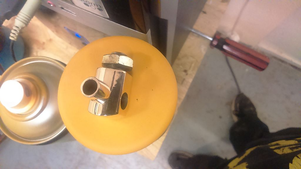

              can anyone ID this for me ? also what would you all recommend as to replacement of this seal ?????.
              also in my last two pics are the results of bit of metal polshing
              Thanks
              Gavin

              #215705
                Graphite Yarn would be the traditional material, this is a hemp type cord with what smells like tallow and graphite powder added, not to be mixed up with the modern dry version that does not last too well.
                You can get it from most model engineering supplies such as Blackgates, bruce engineering, Reeves, etc.
                There is also a modern PTFE version and it is also posible to take plumbers PTFE tape and twist several lengths into a rope but as yours is quite a lareg engine I would not roll my own.

                    I still like the old type. One advantage is that you can unravel it and get smaller size strands, it also packs down into an almost solid section to fill the packing cavity.

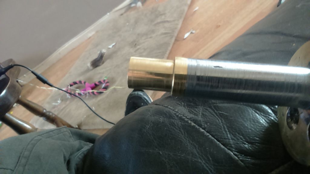

                                Well that this project over flywheel and shaft rolled off work bench and broke the flywheel snaped the spokes im rather shocked it broke ,now i got bits of a engine that going to waste.
                                gavin

                                    i would if i could find one machined i only got a small lathe its not big enough to machine a 8" flywheel

                                      ok so i might of be mistaken as to what size i can turn. i might be able to turn a 8" flywheel. where would people recomend getting a casting from ??
