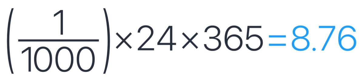

        1 year (non-leap) = 8760 hrs. Therefore annual energy consumption @ 1 watt continuous is 8.76 kWh.
        #745425
          I would express it as
          IMG_9999
          … but I’m very tired at the moment, so might have done something daft.
          Edit: __ <phew> Clive got the same answer.

            The clue is that the fan consumes 1 watt, which is power, or 1/1000 kW.  Energy consumption is then the integral of this, so the fan consumes 1/1000 kilowatt-hour, multiply by hours/year to get annual consumption.
