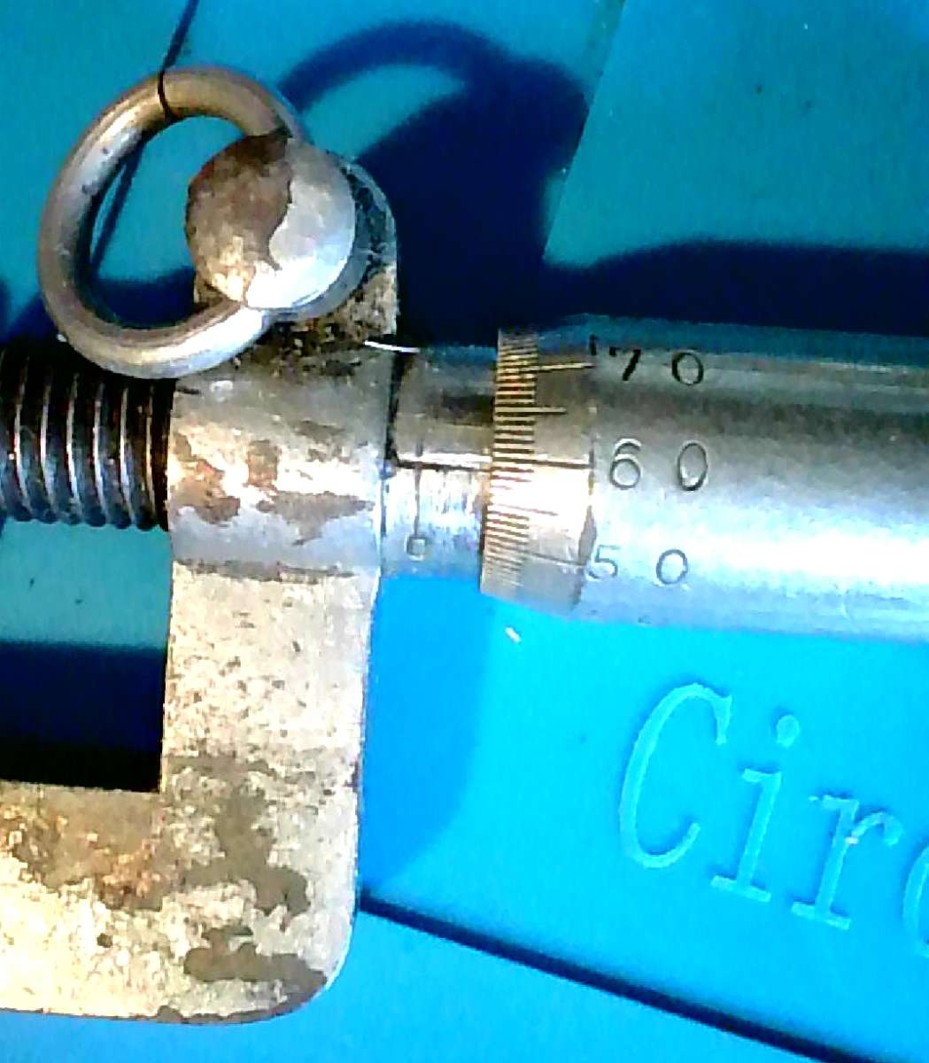

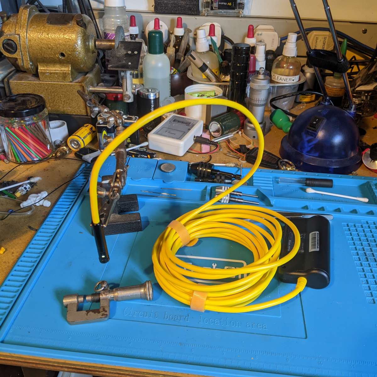

                                  I bought a Depstech WF028 dual lens WiFi setup off ebay for £16.50 last year, which works with a downloadable Android or iphone app, though I’ve only used the former.
                                  It does what I want it to, such as looking inside a shower unit and under a washing machine, as well as examining engine bays for dropped bolts etc.
                                  There are several models all  based around the same WiFi unit, so make sure you know which one you’re buying.
                                  I think the single camera one(s) are higher resolution.
                                  The box for this one claims 1080P video; Faststone claims 1072×1920 for the jpg below of the small micrometer, though I’ve cropped it a bit for display here.
                                  Not stunning quality, but certainly adequate.
                                  Camera phone photo of the setup for the above shot on my clean, workbench upstairs

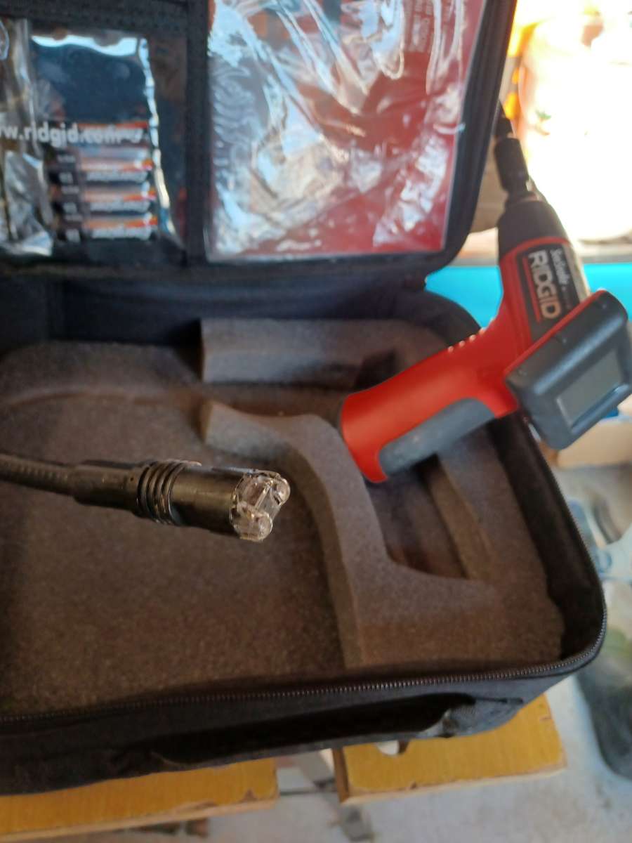

                                            Hi I have a See snake flexible but rigid so you can bend the cable wich then stays in the bent shape to see round and under areas which you cant see normaly. I have had it for around 25 years well before all the USB and other newer and cheaper cameras were available. I believeve it cost around £250.00 to £300.00 which was not cheap but made some repair jobs much quicker and eavan imposible if you couldn’t see what you were doing. It was bought by the company I worked for but as the factory was closed I was allowed to keep most of my equipment. It can see with the two led lights and is waterproof so through oil and coolant.
                                            20240728_071605
                                            20240728_071210
                                            David
