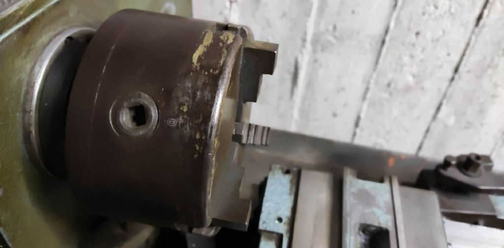

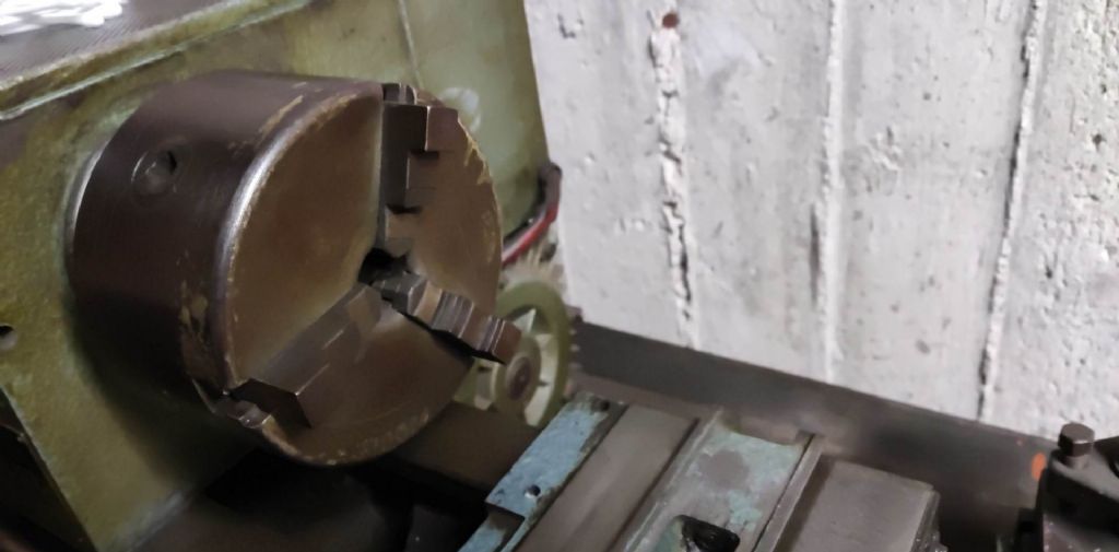

                  – Does anybody have some info on this lathe chuck ? Lathe's s/n is stamped on it – on the back, as well as that "0" that you can see on photos. No other marks.
