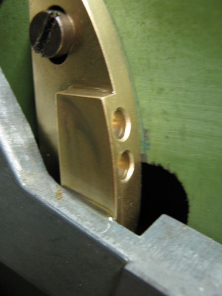

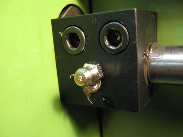

                        Frank Werter
                          @frankwerter48948
                          I am new to this site and came a cross the problems that are occurring to the die cast parts of Emco lathes .Owning a 8.6 myself for more than 37 years I did an inspection on all die cast parts and found several cracked ones.The two bearing blocks and the locking block from the tumbler gears.These parts are no longer available.The replacements I made are of solid bronze see pictures.There was want thing I noticed that only the parts that where market with something that looks like a little bear were cracked all others are fine.
                          #105394
                          Frank Werter
                            @frankwerter48948
                            img_3186.jpgSorry forgot the pictures
                            Edited By David Clark 1 on 06/12/2012 14:51:51

                              Frank; Nice work.
                              My 2 Compact-8 lathes are ok in this regard, but the motor/drive train idler pulley has friction bearings, and these wear, creating lots of noise.
                              I have replaced friction bearings once in my old Compact-8, but my "new" Compact-8 also has this problem. It's on the list to make ball-bearing idlers for both lathes. I note that the Asian Compact-8 clone (eg, Grizzly 9×19 lathe) has a ball bearing idler – obviously they have run across this problem in the original and have fixed it.
                              Another JohnS

                              Frank Werter
                                @frankwerter48948
                                Hi Graham
                                I just sprayed them black with some left over paint may not the best job,but needed my lathe to get up and ready
