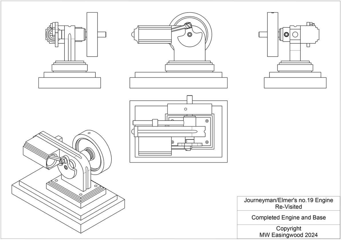

      I recently completed my first engine.
      Having followed the link in a recent thread about the forthcoming Midlands Model Engineering Exhibition, to the Elmer’s no.19, as drawn and built by John on his “Journeyman’s Workshop” website, I decided to make my own version.
      Journeyman’s Workshop.

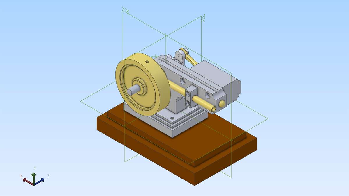

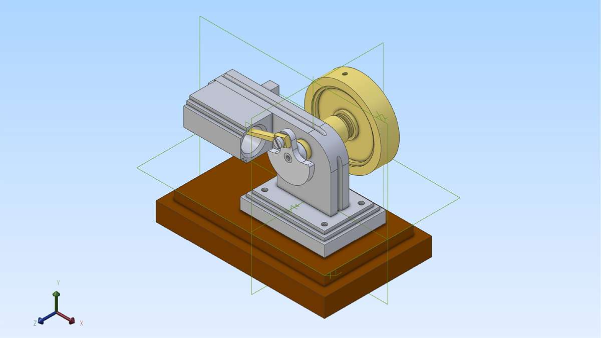

      I used John’s drawings, available on his website, as the basis of modelling my own “Art Deco” version in Alibre Atom, which I have also been learning. I used the same bore size of 14mm and a 50mm flywheel, some other dimensions were altered to suit the available material.

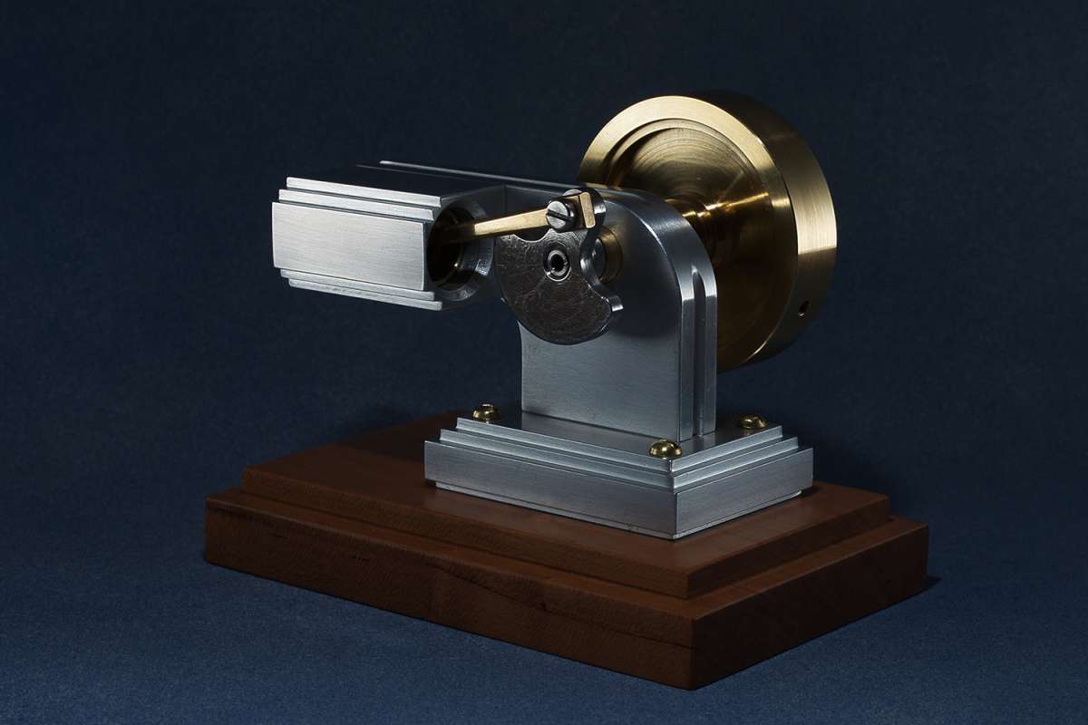

      Not all was perfect first time, I re-made the cylinder, as the first one I bored a little oversize, too busy concentrating on getting a good finish on my well worn Little John lathe, so I didn’t check the size often enough! As I had drawn it at 20mm square, the front cylinder wall was left looking a bit thin, so I re-drew and made a 21mm cylinder.

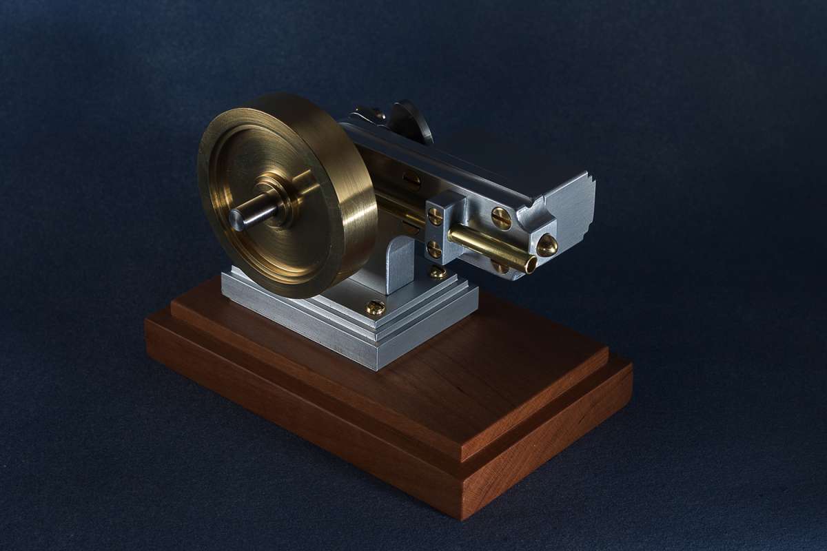

      Once I got the valve timing set right, it ran nicely without any issues.
      The cylinder bore was honed with a strip of emery in a slotted wooden dowel. The brass and stainless steel parts got a polish, and the aluminium got a rub on some fine wet & dry, lubricated with WD40. The wooden base is American Cherry, finished with Osmo Oil.
      The flywheel has a very slight wobble when running, I think this due to using nominal 6mm stainless steel for the crankshaft, and a 6mm reamer for the flywheel, giving a “running fit.” The single grub screw fastener then pulls/twists the flywheel. Although I did select a piece of bar, for the crankshaft, which was as near as possible to 6mm diameter, checking it with a micrometer.
      Should anyone fancy making one, I can make my pdf drawings available, and of course John’s drawings are on his website, he also has details link to the original smaller version.
      Modelling in Alibre Atom.
      Assembly_crop copy
      Assembly-2_crop copy

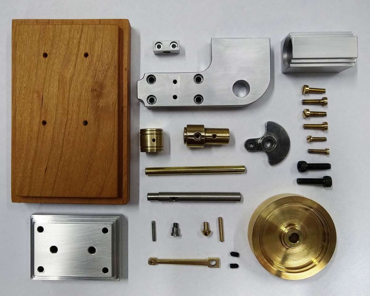

      All the Parts.
      IMG_20240726_WIP copy
      The completed Engine.
      IMG_4140 copy
      IMG_4216 copy

            The 3D Cad drawing programmes certainly make it easier to visualise, and alter/add details on projects.
            The idea to add the detail, to make it “less barstock,” stems from reading your build threads over the last few years.
