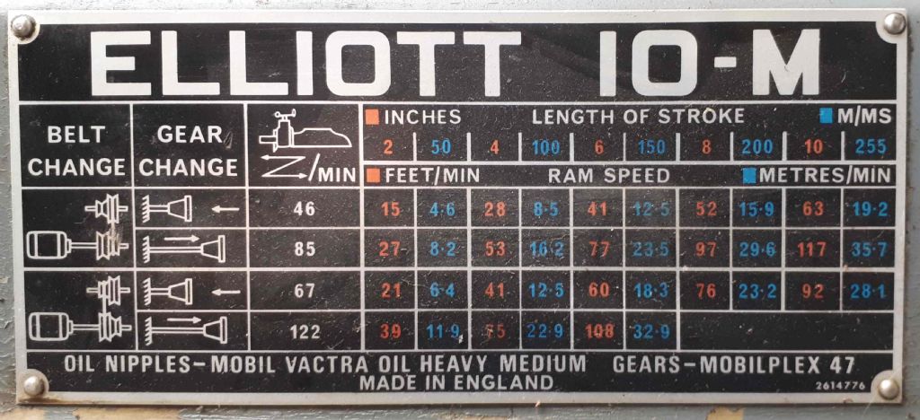

      I have recentely obtained a Elliott 10M shaper. A basket case and a bit rusty. I have most of the parts except part No. 2614776 Speed change plate.
      If any member would be kind enough to post a good picture so I can reproduce the part I will be eternaly greatful.

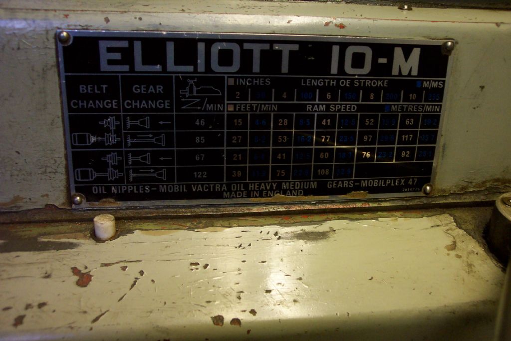

            dcp_7756.jpgHello Charles,
            If this works, here is what you need
            Regards
            Brian

              You may find this a little clearer.  Click on the image and it will enlarge.elliott 10m chart.jpg

                Perfect. All I need to do now is make one. Thanks.
